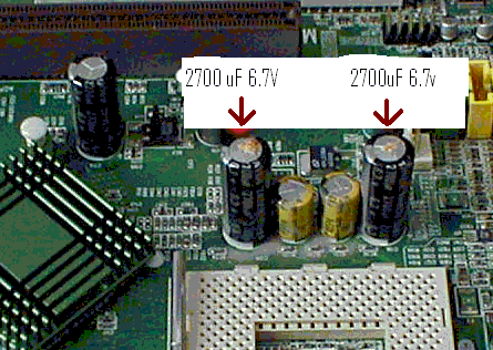

i think i might have found something that has somethign to do with my problem. I took apart my puter today and was lookinga round for anything broken. Sure enough i see two capacitors (2700uF, 6.7v....it has polarity) that have popped tops and both of htem have a brown stuff coming out of them (see pic). Now I dont know anything much of anything cept about the software side of things... how can i get this fixed, i can solder so taking out parts of a puter not a big deal. But here's another question if those caps went bad doesn't that mean that something else i messing them up cause it's kinda unlikly for a cap to do that if it has the right voltage, right? I have a MSI MS-6340M Ver1 Micro ATX VA motherboard. It has given me a few problems in the past so if i had money i'd switch to ASUS (they have a kick but motherboard for like 70$ but that's 69$ more than i have, plus i'd have to get ddr memory and a new chip so price would be a little bit more):scratch: oh yah one more thing, i scratched off the brown stuff on top and now I can hear sounds again. Once and awhile though my speakers will pop while playing music... not too sure what that is though. THoughts?

I was wondering how you were doing with this puzzle.
The only "advice" I can offer is the obvious: solder in new caps and see what happens.

ok well i got ahold of MSI today and they said that they want me to ship my mb out to them and they will give me the newer version because the version i have is out of production.. they most likely will give me v5. (i have v1) so that might mean that they found the same problems that i had. i can't wait to get my computer back. good thing i have 2 other computers to play around on. Thank you guys for your help. Peace out.🙂
