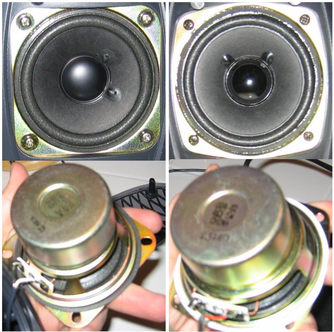

Through my job I have come across a bunch of little computer speakers that I can have if I want. Oh boy! Making sound in the office! Or the bedroom! Maybe the basement! You see how I work here.
So I'll include pics of the drivers. The group of appearantly similar Harman / Kardon speakers actually had 2 different kinds of drivers.
The ones on the left have printed on the back:
Samsung
08G11ARH
4 (ohm) 3 w
H309 24
On the right:
004-02
4 (ohm) 5 w
China
2J14D
Can anyone tell me anything about these drivers? After some listening the Chinese one sounds like it has more bottom end and more top end, and greater clarity as well. But it is more forward and harsh sounding than the Samsung unit, which sounds mellow, if indistinct. The Chinese unit might be a bit louder. The dustcap on the Chinese unit is hard, shiny plastic, while on the Samsung it's softer, and a matte finish. This is the main visible difference.
While I had the speakers open I had a look at the amp. The central bit of it was a Philips chip, TDA1517P. I didn't have much difficulty finding an online data sheet on the chip, with a reference design. I plan to yank the chip and rebuild it as an exercise. Can any of the smarties around here possibly suggest improvements on the reference design? It's so simple, it makes me think it leaves something undone...
As far as speaker enclosures go - I'm interested in back-horns at the moment. Ones small enough for cheap experimentation and easy placement. If you look up "Makizou" here at diyaudio you'll find the design I'm thinking of. (evidently it's not strictly a horn, but I'll call it that for lack of a better term) I have no idea if these drivers would be appropriate for that (or any) horn enclosure. I see people talking about horn designs as if it's worth a shot sticking any driver in one, but I don't really know what I'm talking about here, so I'd appreciate some input.
Failing that, maybe a multiple FR driver array...?

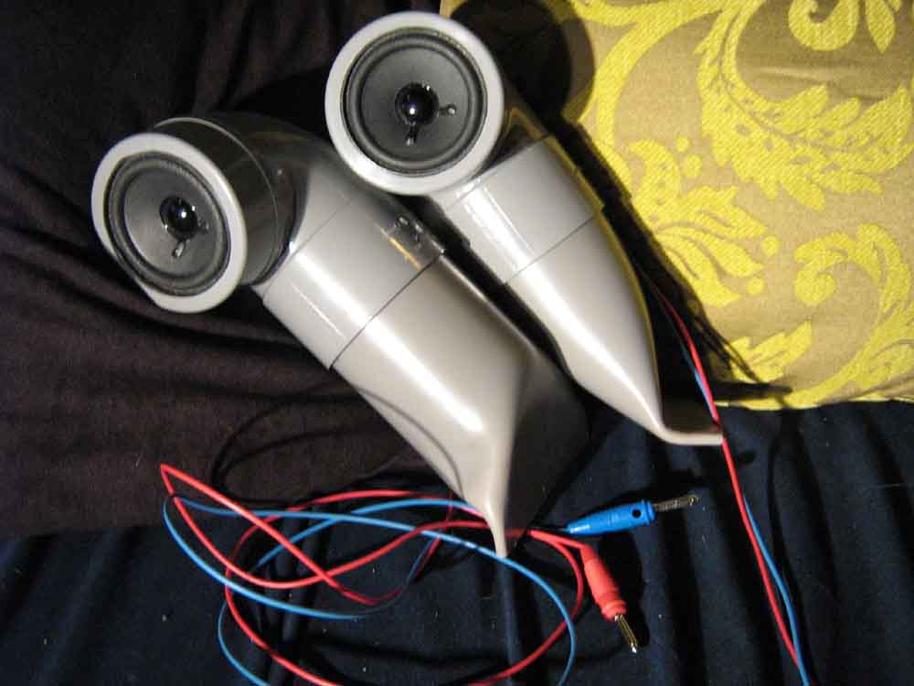

The Samsung drivers you mentioned look and sound quite similar to those I ripped out of my old pair of Creative PC speakers. Mine have a smaller magnet and no mounting flange at all. I'm experimenting with them in 3 foot PVC pipes. They sound surprising for their size. Bass does not rock out, but easy listening is good.
How many have you got?

Progress Report:
So initially the computer speakers sounded terrible. No suprises there. I opened the enclosures and they were hollow plastic echochambers that bonged when you hit 'em. So I stuffed some dampening in. That didn't help, but it was just a thought.
I mounted the drivers on an open baffle to take a listen. This started to show a little promise, but man! At the attack of every note it was like someone was driving a spike into my head! Painful to listen to.
I had noticed the baskets had a distinct *ting* to them when struck, so I decided to damp that. Epoxy putty around the basket / magnet junction, and rope caulk all over helped significantly. Now in the open baffle I wouldn't call the sound awesome, but it is distinctly listable. They're still a bit fatiguing, if you get the volume up, but I was able to enjoy music from them. The gameboy remix of Beck's e-pro really made me smile - musical video game bleeps and bloops sound great on cheap speakers with no bass! And really, I've heard much worse.
So remaining things to try include some PVA glue on the cone, also I've heard about making a little hole in the dustcap (this from the NSB speakers a while back). I had considered a bit of felt or something on the dustcap when the speaker was still driving me crazy, but now that it sounds better I think such drastic measures can be avoided.
After that it'll be time to make an enclosure! Whee!

Thanks Adam, much appreciated. My drivers are both the same i.e the speaker with the chip amp and the passive speaker both use the same Samsung driver as one of yours. Hope it's the better measuring one.
I fancy building entirely from scrap as the MDF is off cuts from a bedroom furniture project currenlty underwway, and I have glue and wadding. If I use the Samsung driver then all I need to buy are a couple of pairs of binding posts, and I can always upgrade to better drivers (hopefully use the same screw holes
Here's what I got:
driver 1 2
Re 3.131 3.403 ohms
Fs 135 122 hz
Qts 1.101 1.066
Qes 1.328 1.288
Qms 6.448 6.194
Le .0789 .0942 mH
Mms 1.845 1.963 grams
Vas .0546 .0626 cu ft
sensitivity both ~89 db
Like I said, these were measured with me just holding the drivers in my hand. Testing was less than rigorous. Perhaps I'll manage to do a better job after Thanksgiving...
