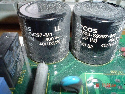

I am just cleaning an inverter, here is a picture of the caps.
Computer Grades are still used for big main frames, that is where i try to buy them from.
An Aluminium electrolytic is an alloy foil with an electrolytic layer on it, the foil is rolled up and and an insulating cap is placed around it.
Computer and inverter grades have a much thicker electrolyte layer, the thicker layer enhances the long term behavior of the caps, and more.
That is why both CG and LL inverter capacitors are much bigger, a CG up to 20 % more than a LL.

What does the 40/105/56 and 40/85/56 indicated in capacitor means?
I just know the middle number = operating temperature.
How about the 40 and 56??????????????
I hated it - slow, dead sound
Same experience with Mallory. SicSafco otoh are exceptional.
TunaFish said:What does the 40/105/56 and 40/85/56 indicated in capacitor means?
40/105/56 means the capacitor has been tested between -40 C and +105 C for 56 days.
Same with the 40/85/56.
The ISO/IEC have standard procedures, of which the 56 days is one, that enables someone to compare components.
The main parameters that influence capacitor performance are temperature and humidity.
A standard IEC procedure is placing capacitors in a surrounding with prescribed humidity percentage for 56 days at different temperature.
