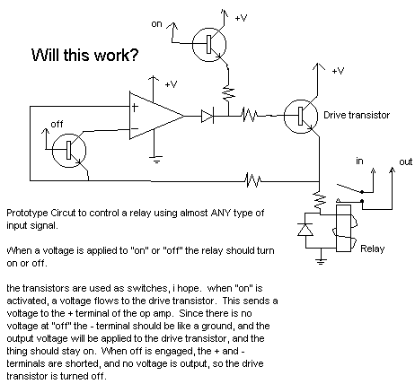

hmm, i had wanted something a little more dumbed down then that. I did think of something though. it involves 3 transistors involved as switches, and 1 op amp as a comparator, and a few resistors and a relay. possibly a coulple diodes. i'll attach the likely very wrong version. like i said, i'm new to semi-conductors.
lol, I have a confession.. I don't even get the circuit I posted.. 😀 lol..... I have a circuit in magazine somewhere for a single parallel port controlled relay.... Don't know where it is though... as for the schematic you posted.. . umm.... I dunno.. 😀
see, my idea is that when the on signal is passed, it will make the transistor into a switch, and this will turn on the drive transistor. this will begin charging the relay. this will also send a signal to the op amp, which should be a non-inverting comparator. since the signal voltage is above 0, the opamp will send a signal to the drive transistor. once the "on" signal is let off, the drive transistor will still be on because it is controlled by the opamp, and the opamp will stay on because the drive transistor is on, so it will stay on. once the off signal is sent, the "off" transistor should act like a switch, and allow the same voltage to reach both terminals of the op amp, which will cuase the op amp to stop sending the signal to the drive transistor, which will cause the transistor to turn off, and the opamp should stay off.
i am wondering if it will work and if i drew it correctly, and if the relay's inductor will supply a signal to turn the op amp back on, which would mean that the thing would be hard to turn off.

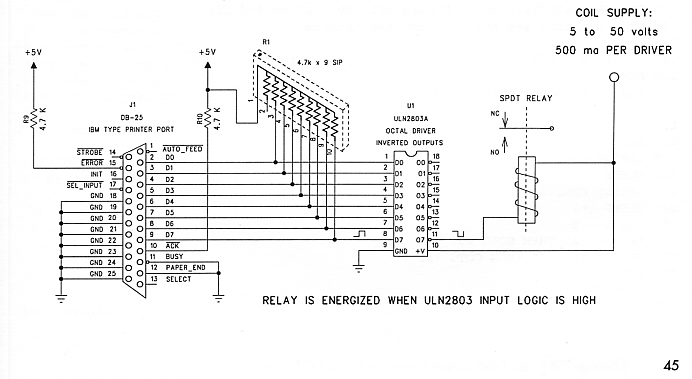

Microsoft was never happy about controlling things on the outside from inside windows, thus you are going to have to noodle around a little in Visual Basic and perhaps get the DLL's which allow you to work around the operating system. The circuit below will control several relays or switches.

the circuit with the ULN2803
The UKN2803 is a very common chip -- each output is rated 50 Volts, 500 ma. The pullup resistors are necessary to provide clean outputs to the ULN2803a, R9 and R10 keep LPT1's ACK and ERROR ports high.<p>To get the device to work you can write a little code in basic to LPRINT a character to the LPT. All of the above is from one of the really basic books on computer interfacing "Controlling the World with your PC" <p>Once you get started playing with the PC's ports you have entered the abyss from which there is no escape. You will soon learn Visual Basic, C or Pascal!, then start programming PIC's and AVR's.

I got a prototype working, but instead of the parellel port, i used switches. It is likely the mst complicated way to do what i want to do. also, i couldn't figure out how to get the non-inverting comparator to work. it stays on regardless of signal. if i could figure that out, i'd be able to get rid of my current attempt with an optocoupler.
