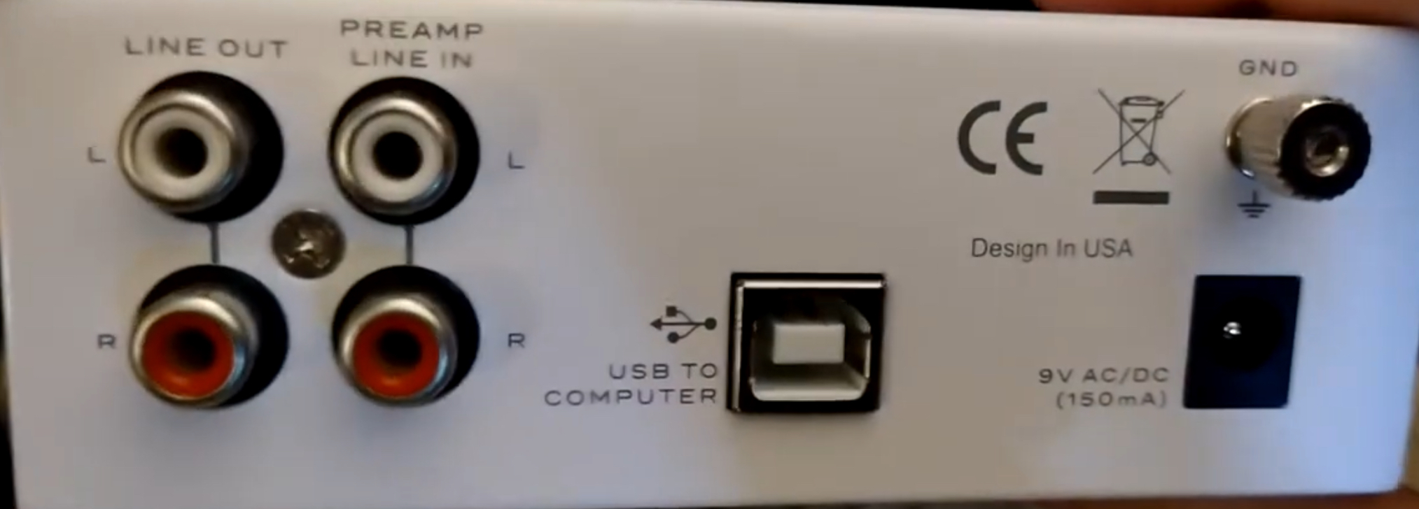

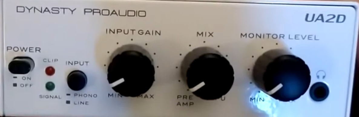

Found one of these for $65 on Amazon. I’ll connect it inline with USB-C to a Qudelix 5K with an uploaded room correction file. Then 3.5mm to RCA from the Qudelix to the center channel amp. I’ll update if any of this works or not.
Didn’t work.
Measuring and calibrating the DIY speaker utilizing the computer as the source in room at the listening position; then uploading the PEQdb generated filter to adjust in room response to a Qudelix 5K, then applying the filter through Qudelix out from the computer as the source and listening to the applied filter was straight forward…..but only with the computer as the source.
I was hopeful that RCA line in to the USB interface preamp then USB out to Qudelix then headphone out from the Qudelix to RCA adapter into the DIY speaker amp would work seamlessly; but it didn’t. The Qudelix did not recognize the USB out from the Dynasty ProAudio USB interface.
