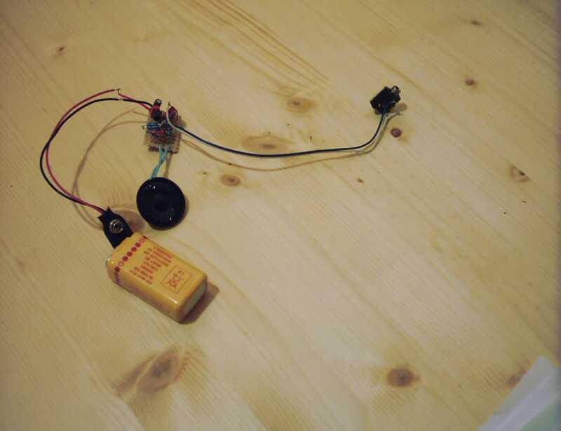

8 Watt enough depends only on your speaker and how loud you expect to use them. I made an 1 Watt amp with SSM2211 chip (see pic) and with this little speaker connected on the pic its very silent. But if i use it on the big speakers (horns) it is absolute loud enough. One of the national or ti opamps will give you easy 50W or more if you need them and build a big enough powers supply.
