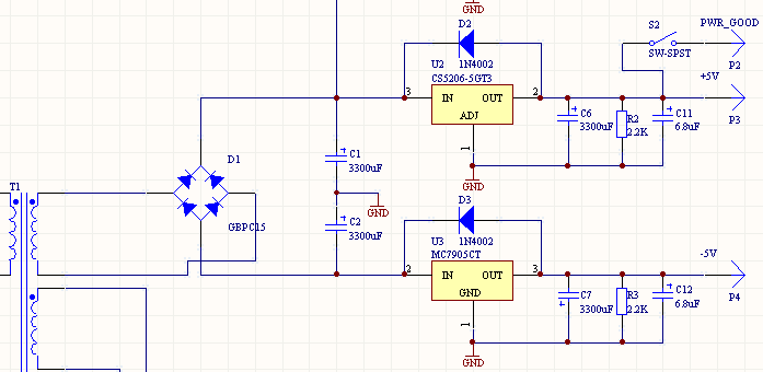

amo: I'm currently in the process of building a toroid based PSU for my htpc so you can see how I'm planning to do it on my htpc psu page.

AndersZ, Nice design power supply, but I suggest substituting Linear Technology LT137 and LT337 adjustable regulators for the +/- 12V. supply--presumably for analog audio electronics, as they are significantly lower in noise than fixed regulators and lower in noise than the more common LM117T and LM337T adjustable regulators. the devices spec' sheets will show you how to wire them. ( www.linear.com) Be sure to use the recommended 10 uf (tantalum is best) bypass cap. off the adj. pin.
lgruber: Good idea! I will look into it and modify my schematics as soon as I get home sometime tomorrow.
Anders

I've updated my psu schematic a bit as well as the webpage.
The LT137A/337 are not really applicable since they only have a current-rating of 1.5A. I have 4A coming out of my toroid which is barely enough.
The full schematic is here: http://www.t.kth.se/andzak54/files/htpc_psu.pdf
I attach the 5V portion to this message.
Anders
Anders
That sounds fine. The (Linear Technology) LT117T and 337T adj. regulators are lower in noise, but that would be more applicable to preamplfiers that draw less current than your applicaton. I'm sorry that I didn't pick up on what an HTPC is. For further noise reduction in power supplies (lower source impedances, etc.) especially for amplification of low-level signals (tape, microphone, phono) the "Super Regulator" stuff by Walter Jung and others that appeared in recent issues of AudioXPress looks like it could be very effective, but I haven't tried these designs yet, but intend to with my upcoming Ambisonic decoder/preamp project.
Those seem very interesting for me too, especially if the current rating could be increased to "normal" pc levels (>8A). Size isn't really a big issue in my application but complexity is, I don't like to complex things since I never seem to finish them...
However, I think my present design is good and simple enough to be tested so I will report once it has been built and tested.
Anders
