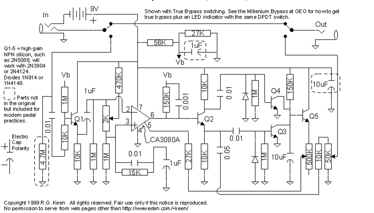

A compressor is made of two components, a Variable Gain Amplifier, and a level detector (RMS "meter"). There are two possible implementations, both common, with different results. Many compressors do some of both.
he Sta-Level type, puts the level detector after the VGA, and controls the VGA to attempt to keep the output level nearly constant. This type will do nothing on the low level input signals, and start removing gain once the input reaches a certain threshold. The gain reduction increases at a non linear rate until full reduction is in effect, then a limiter takes over. This was invented for broadcast transmitters to meet FCC regulations, but has found many audio applications.
The "linear" compressor puts the level detector on the input and removes gain in a db for db relationship. This was common in the early days of LP recording to fit dynamic music into the 45 db range of an LP record.
A modern compressor uses both of these techniques, several types of limiters, peak squashers, and multiple time constants to "make the music louder".
The same elements used in a compressor can be used to make a dynamic range expander. About 30 years ago Signetics designed a chip to do both, the NE570. It went extinct about 25 years ago, but has been brought back from the dead by On Semiconductor, and is still stocked at Digikey. Read the datasheet. It explains a lot of this.

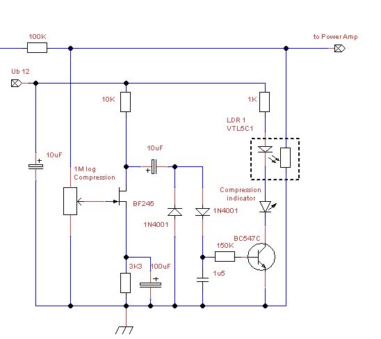

Just to share my experience on that area: here is my compression and noise gate schematics. Both work with LDR.
For compression control I use a voltage controlled resistor: the lower the signal the higher the resistance. From signal flow point of view its passive and easy to be implemented. In my 400W bassamp I have placed it before the mastervolume.

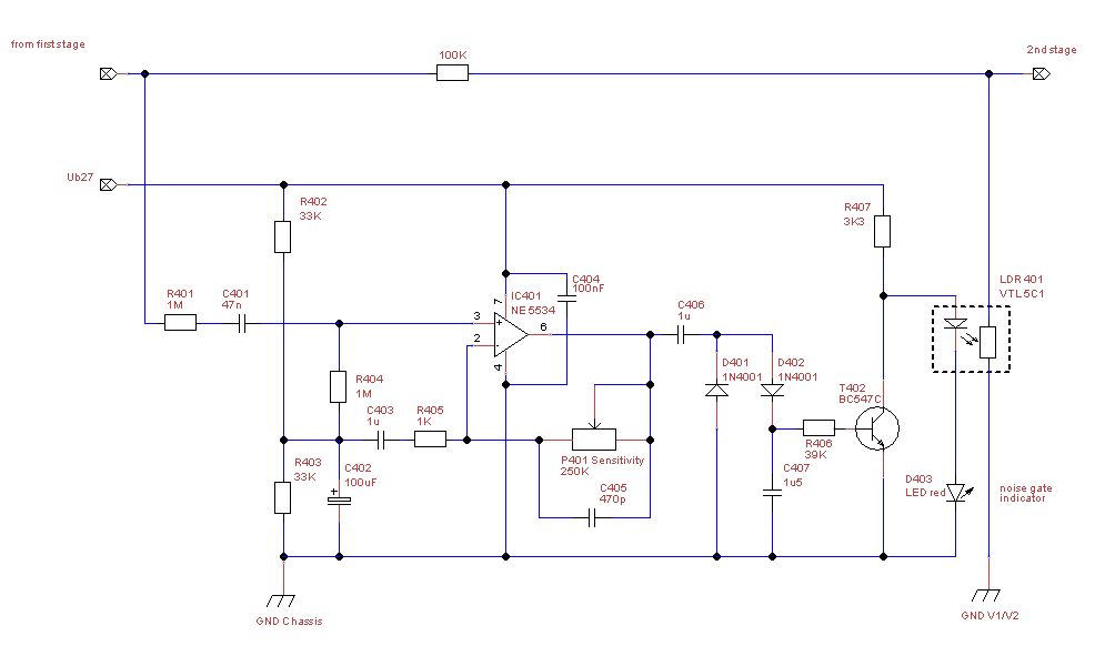

The noise gate is basically the same philosophy, except that the control is the opposite way. It is placed after the first stage in my guitar amp. There is a nice small hysterese in the switching mechanism. When switching off caused by a small signal below thresholdthe signal becomes even a little bit smaller because the 100K switched to ground vie LDR is now an additional load to the input.
