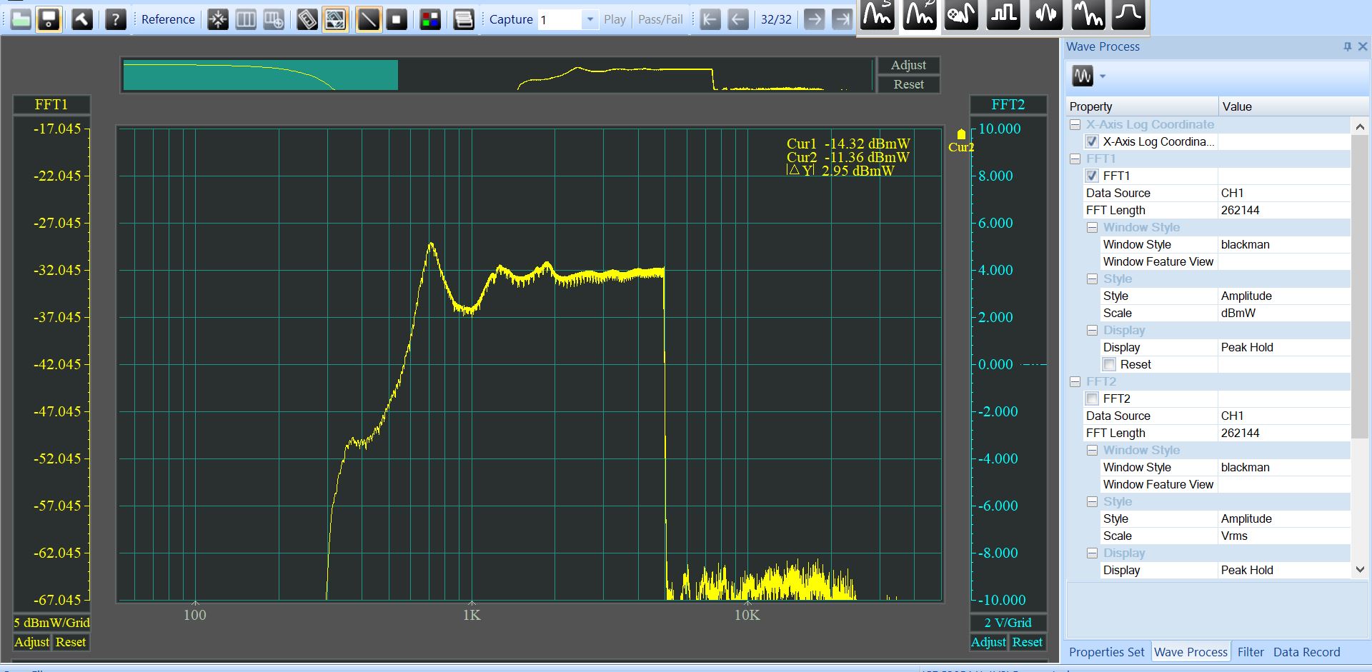

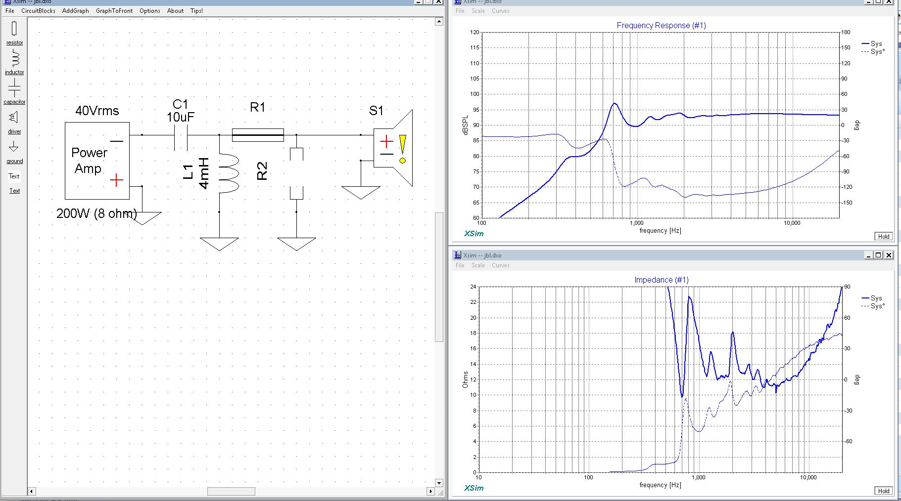

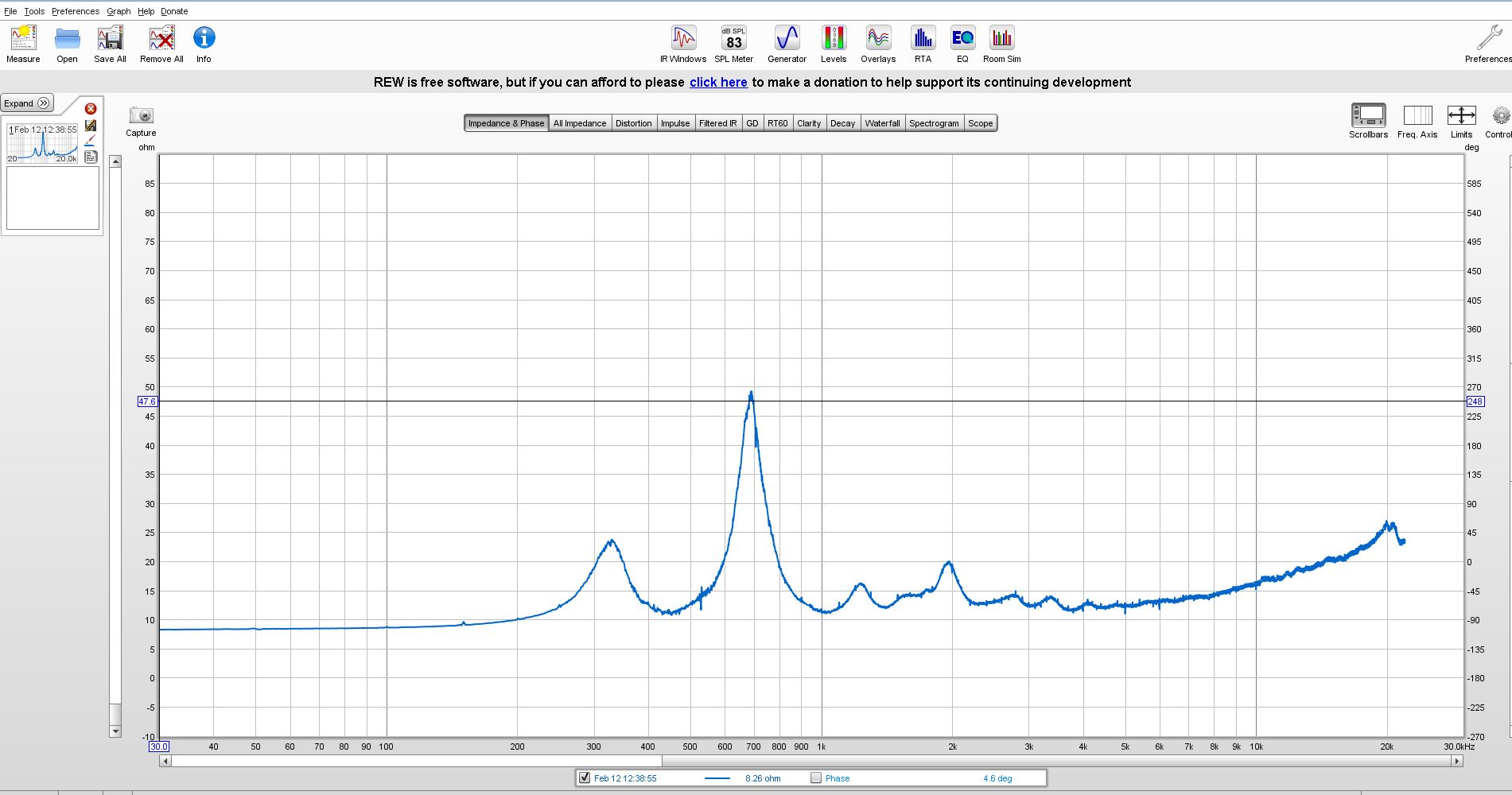

ok, this is what i measure.
Now how can I evaluate the values?
If I interpret your pictures correctly, sim and measurement now match. Next step is optimizing the LC values. Unfortunately in XSim trial and error are the only way. Toggle the values until you see red in the face. A network consisting of one L and one C is probably too simple, so you may end op added further components.

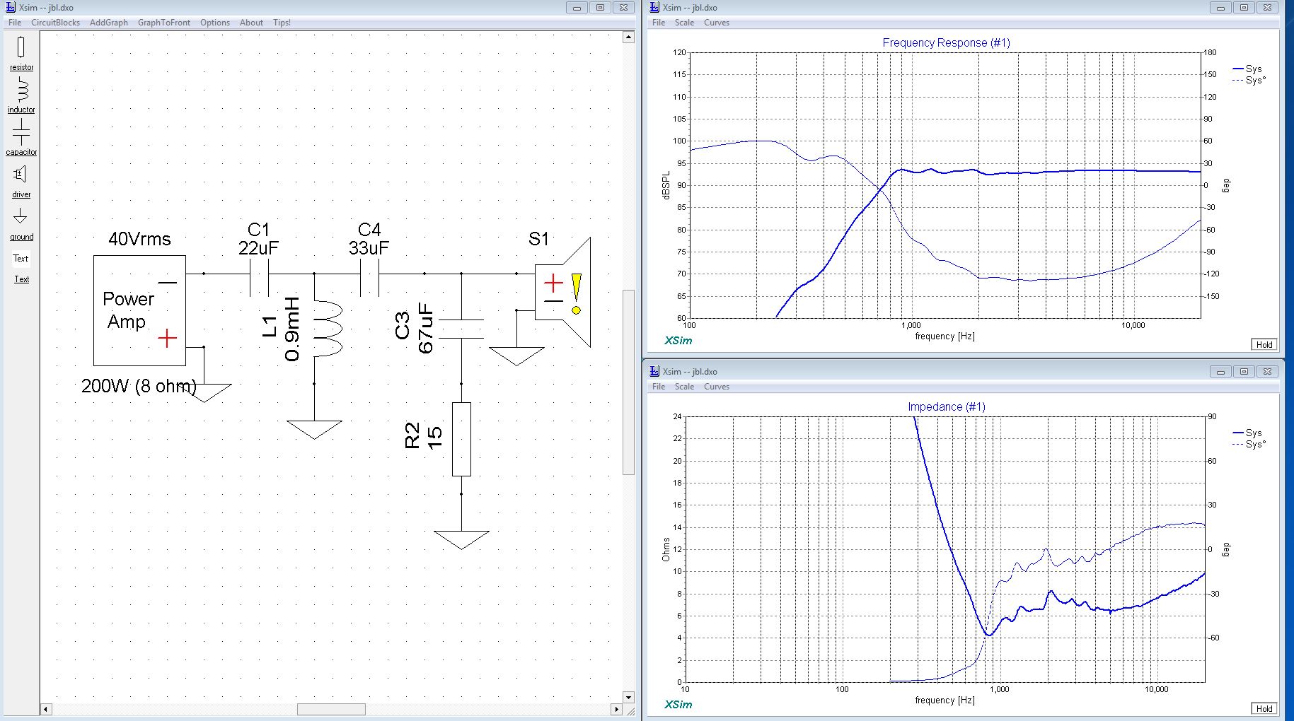

Sorry missed your post. If I were you, I would try to remove some of the elevated section between 1 and 2 kHz. Do you have a raw driver measurement?
The reason that you have such a peaked impedance is because of the horn. A better horn would not have such a rough impedance and you would get a better result. You could also, as mentioned before, put a resistor across the CD, thus flattening the impedance, but the resonances from the horn will still be evident in the output SPL.
Looks like you're more or less in business now, although the knee @ 850 Hz is still a tiny bit sharp.
no speaker has a constant impedance load at all frequencies. you can't use a dummy load as the speaker itself. measure the impedance of the driver or simply digitalize the impedance curve in the datasheet or use Vituixcad graph tracer (it's the best I've used). then import the impedance into Xsim for an accurate simulation.

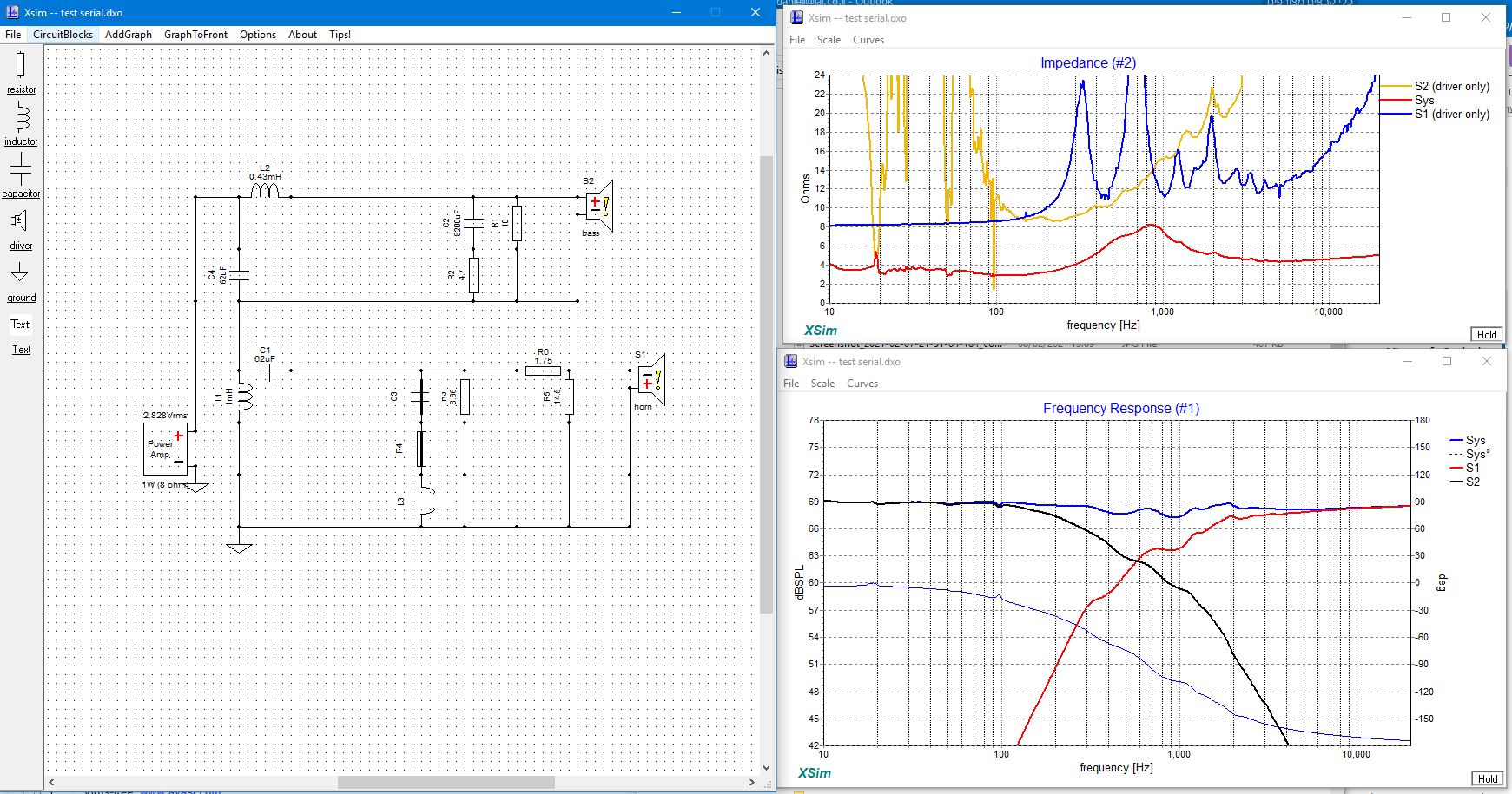

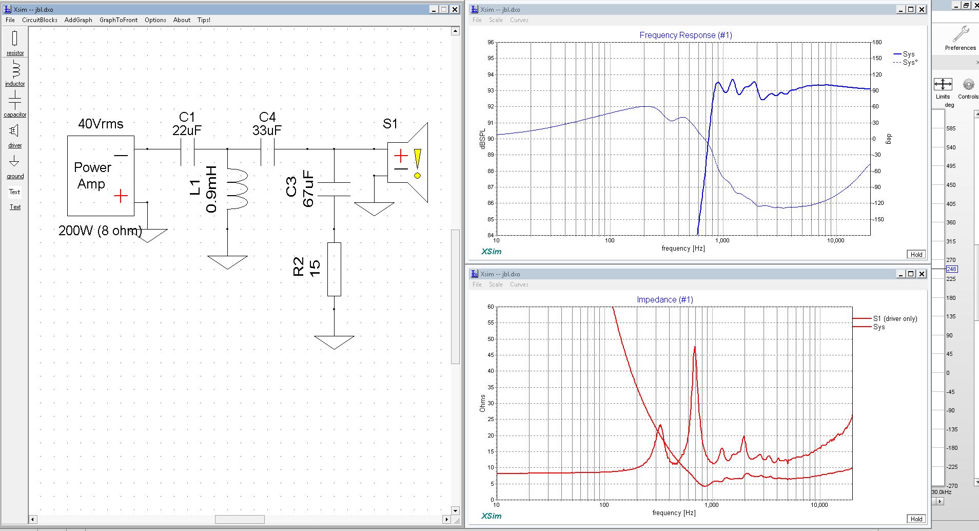

I would like to hear your opinion on the following design: (2-Way)
I connected the crossover in a series, because the impedance dropped to 2 ohm on the horn.
The impedance dropped to 2 ohm because that's what lowered the peaks (blue line). strange, no cap in the zobel network.
Is the design correct?
