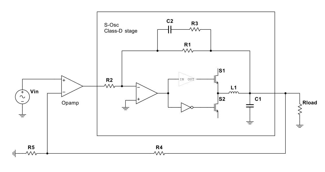

Composite amplifiers with Class-A or Class-(A)B are a well known technique to extensively improve the total performance of a system.
I was wondering if this could be used with a Class-D output stages as well?
What are the practical (and theoretical) limits and issues?
So in other words, using an high performance (linear) opamp with a Class-D output stage in the loop.

All nice, but that doesn't give an answer to the question if a composite amplifier is possible with Class-D output stage?
It's been done for years. (With Pre, Post or Pre+Post-Filter-Feedback)

I also don't see how the following default composite setup compares to that article?

Your question is flawed. If you look into class D amp design, they indeed have op-amps and other linear devices embedded in them. As with class A and AB amplifiers, crappy linear componentry is a recipe for crappy sound. As Eva has stated, there are subjective and objective elements to the answer of your question. Yes, you can do it, but how is another question. Your answer lies in your domain.

Composite amps have a lot of careful compensation for the increasing phase shift with increasing frequency (this happens with each amplifier alone, and cascading two amplifiers complicates the situation). I recall the use of 1 percent components in places where 20 percent would good enough to make a stable single-amplifier circuit (well, a single-amp circuit doesn't even have those intermediate 'places', but I hope the point comes across).
The phase shift of a Class D amplifier is way beyond that of most linear amps, due to several things. There's the input sampling, which causes the output to be an inherently delayed version of the input. Then there's the output filter, often a two-pole (inductor and capacitor) circuit which adds its phase shift, and then the feedback is taken from that point. The output must be low-pass filtered for many reasons - the one pertinent here is that you can't use the raw output, a PWM'ed square wave, as feedback for a linear amplifier.
I suppose the way to do this is to plot both gain and phase shift with frequency of a Class D amp, and figure out what kind of response the other amplifier would need to have to prevent the gain/phase shift situation that would give oscillation. As I mentioned, composite amps already use high precision components to "work right" and be flat up to 20kHz. No doubt it would be that much more difficult for a Class D composite amp. Yes, you could "do it" but with the much greater accuracy needed, things such as adding shielding (thus changing the capacitance to ground) and temperature variation (causing slight component value changes) may be enough to make the circuit unstable.

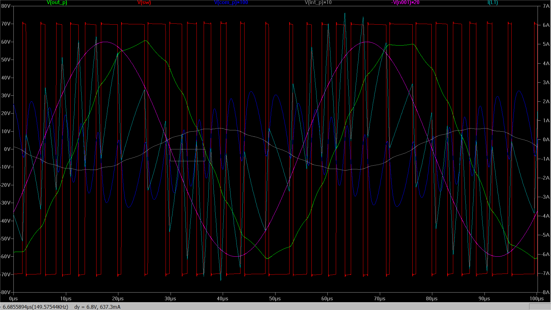

This plot shows phase shift of state-of-the-art class D modulator (post-filter feedback), a constant 6.7us delay across the audio band (equivalent to 2.3mm), frequency response deviation is +/-0.05dB, output impedance at 20khz is less than 0.005 ohms.
And this plot shows same modulator in action:
- Magenta trace: input voltage
- Green trace: output voltage
- Red trace: PWM
- Cyan trace: current (load: 100uH+4r load simulating a tweeter)
- Blue trace: input to comparator
- Grey trace: integrator volt
- Dotted rectangle: phase shift, indicated at bottom left.
No ornaments.
