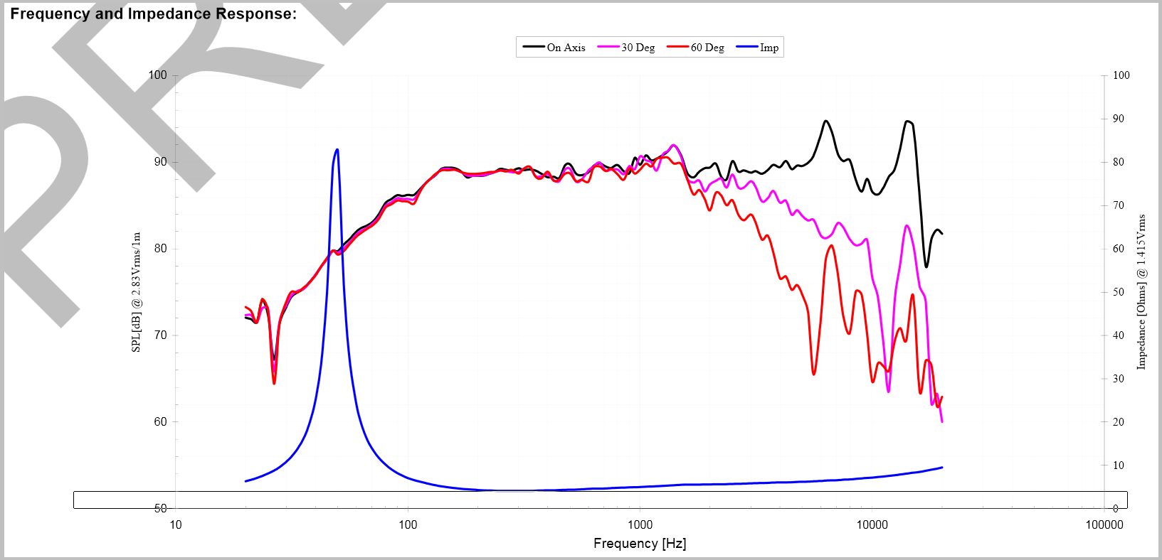

Hmm, so I guess my question is what is the proper way to wire these on the same channel of my amp? If they are wired in parallel will the amp see 4 ohms (the set is advertised as 4 ohms) or will it see less.
Thanks again for all your help!
The load will be close enough so that it should not cause any problems. The impedance of any speaker varies greatly across the spectrum. The 4 ohm impedance is 'nominal' impedance (approximately the lowest impedance presented to the amplifier).
The attached image is the impedance curve of THIS driver. The top of the rectangle is approximately the 4 ohm impedance line. As you can see, the impedance is rarely (never) exactly 4 ohms.
