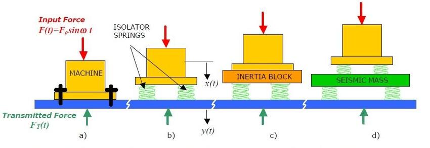

Yeah isolation definitely makes a difference on speakers, juries still oout for me on components. But as in the post above the real difference was noticed after the second layer of isolation with the mass in between. Most platforms Ive seen sold for this purpose dont have nearly the mass I think might be required, I suppose shipping would be the main concern.
something like this (d):

That's a cool image, it explains the ideas very nicely. I may have to do some experiments myself. I agree, high mass is important and that suggests it should be 'manufactured at home' since it avoids paying for high shipping costs for something that should be trivial to DIY.

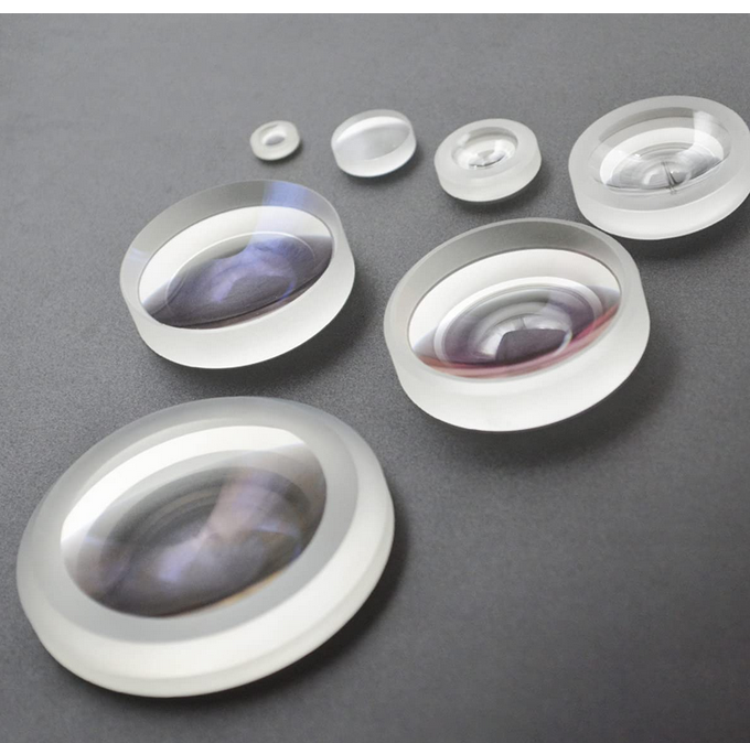

I was thinking of super smooth cups to use for bearings and an image popped
into my mind...well not an image exactly, but the lens that creates it!
What do you think of using concave 50mm lenses? They are made to extreme
tight tolerances because light has to pass through them undistorted. And they're super smooth. Of course the strength isnt as much as tungsten, but you can buy them premade.

Yup ordered some lenses already at $17 a piece. Not entirely cheap still $102 plus the bearings for a set but still much cheaper than the high performance alternatives. Of course I dont know if they work yet!
Im not too worried about load for say, a 40lb components. The lenses I ordered are 18mm thick so each should be able to support 15lbs I would think. But maybe they'll crack with vibration I dont know yet.

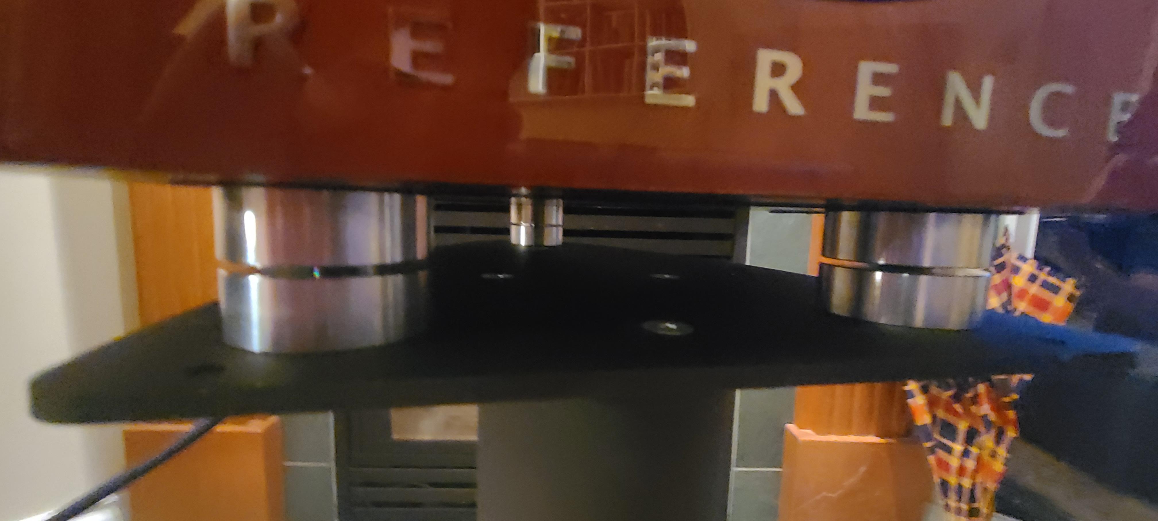

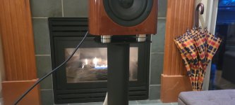

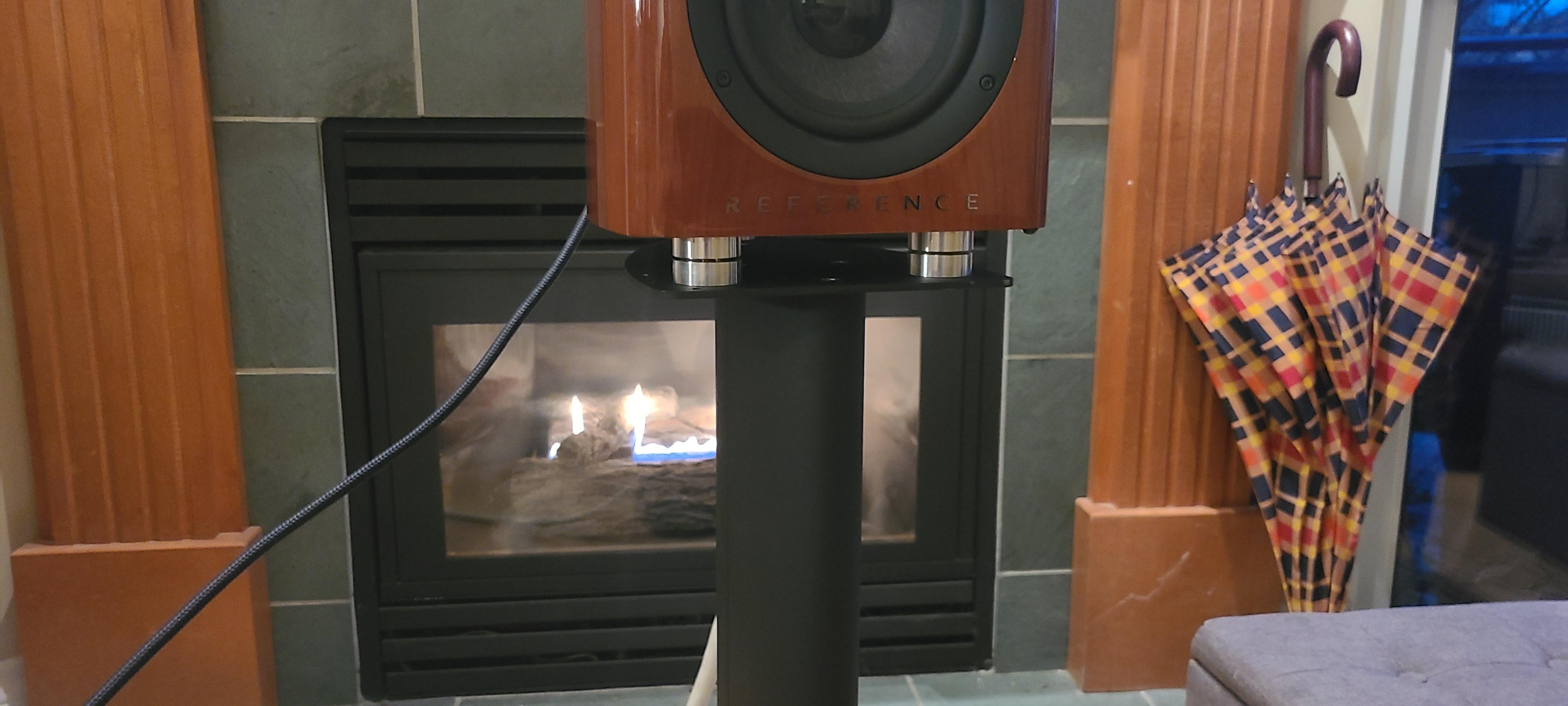

Update,
Curiosity got the better of me and I decided to try the bearings underneath my bookshelf speakers instead of the Iso pucks. They made an even bigger difference than underneath the dac and tube amp. I think I prefer the bearings to the isopucks. I still have them on the gaia's underneath the stands but on top of the stand I put the bearings. Of course you have to be careful that a child or pet doesnt knock them over. Very risky ! 😀
Marked improvement in transients and a feeling of 'thereness' or 'solidity' in the sound. I too loath these awfully subjective terms but not sure how else to put it.
Im ashamed to say I didnt make these but the guy who i bought them off of had a friend make these with a lathe. I think they're just aluminum
