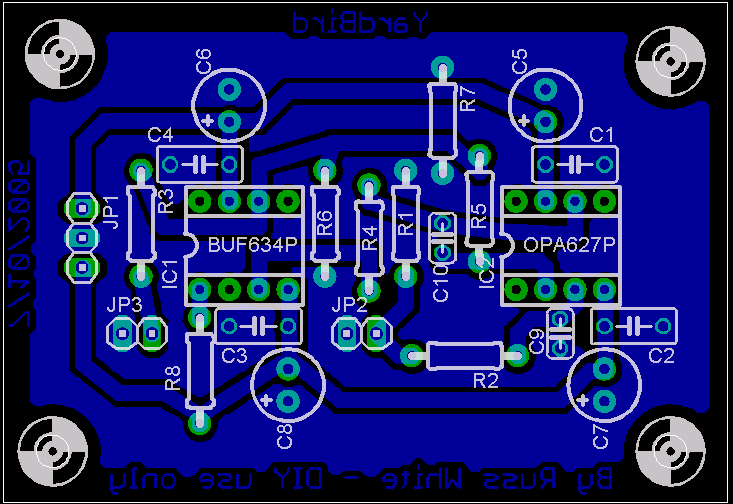

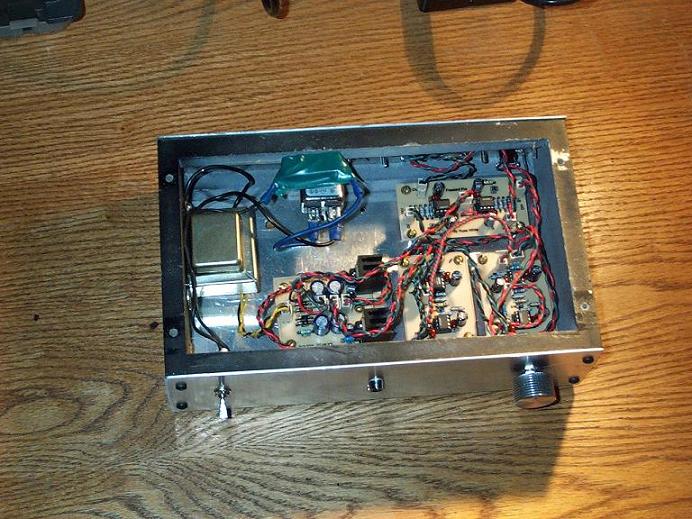

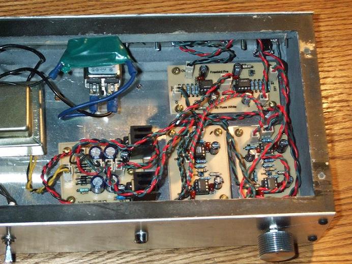

completed chipamp pre
Here is my latest preamp with headphone amp.
Pics to follow.
DcibeL said:
Looks good. Is this the board that you plan to offer as a group buy in the future? I am still contemplating whether I should build your design or Nuuk's JFET buffer preamp. It's a thinker I tell you.
Yes, i plan to produc both the YardBird and the FreeBird designs. And I can tell you they drive GCs very well.
:nod: :up:
I have tested it now with inverting/non-inverting and Mauro's Ref design. 🙂
I am quite pleased with the outcome.... but please feel free to build one yourself and be the judge.
I will send a FreeBird and a pair of YardBirds to the first Member in the US or Canada who commits to build them in the next couple of weeks to evaluate.
Cheers!
Russ

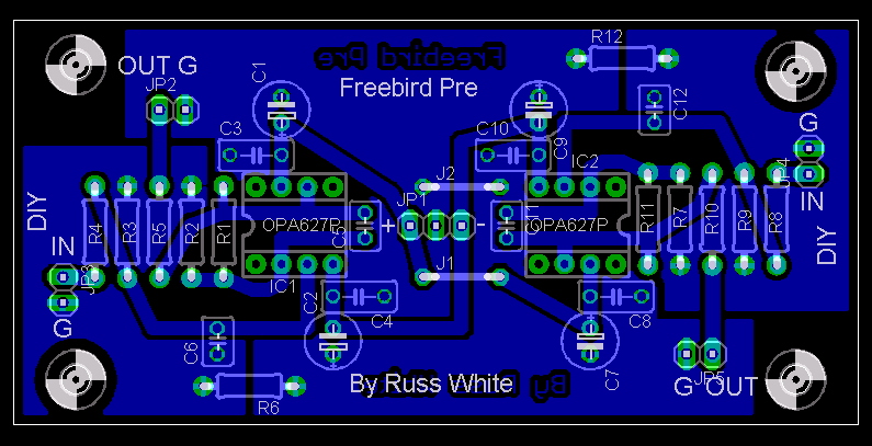

Russ White said:
It is a simple stereo opa726 circuit......

Of course it is a opa627. 😀

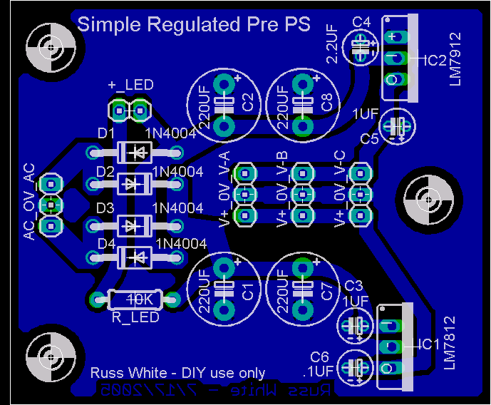

DcibeL, I am in a generous mood, 😉 So I will send you a FreeBird/PS too. Please send email your address and it will be on its way.
