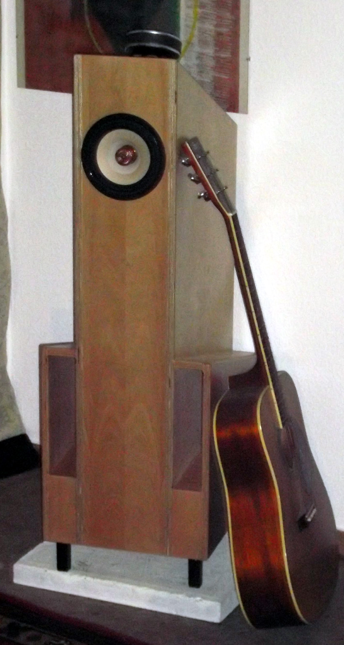

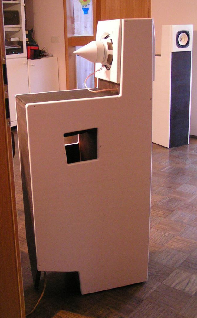

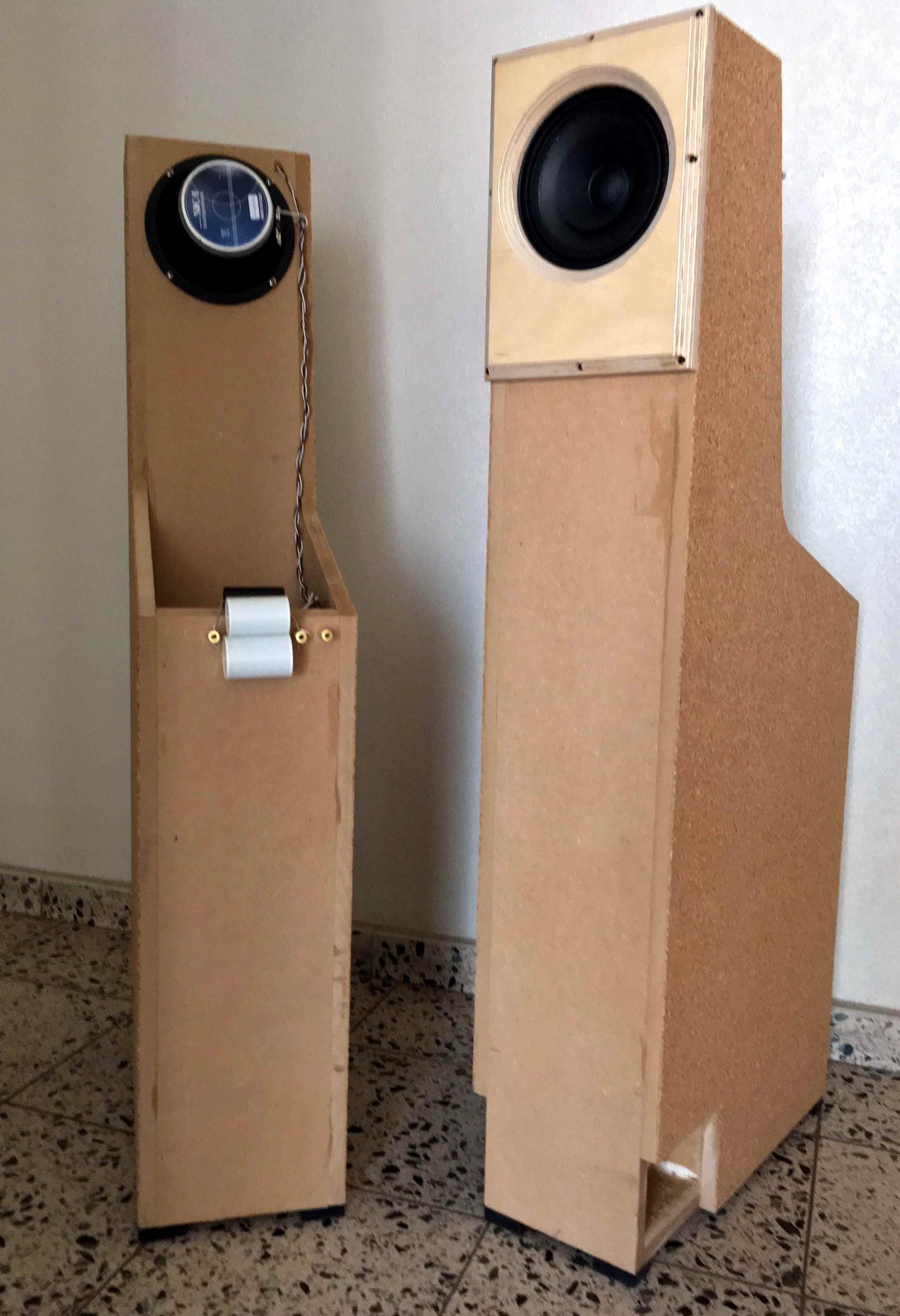

Hello,
my POSAUNE, KANGLING and DH-SAT-XL will work
