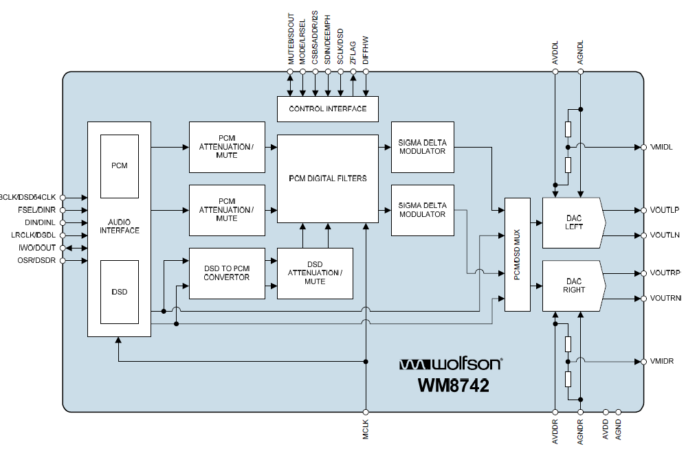

All the TI DAC's can bypass internally the OS section - in the external filter mode and in the DSD mode. Actually Denon uses a DSP as external filter for PCM signals, so in their players, the DAC has always the OS disabled.
As for the FIR, it is done analog, not digital (so no need to go via PCM):
"The DSD mode provides a low-pass filtering function. The filtering is provided using an analog FIR filter structure."
Plots for the analog FIR's are given and the word ANALOG is everywhere in the DSD section.
WM has a converter from DSD to PCM inside their DAC's (if volume control inside the DAC is desided) but they have also a direct path for DSD to bypass the the delta-sigma modulators needed for PCM. The signal that goes in the actual switched-capacitor DAC is always DSD type (delta-sigma).

Oh boys, there are so many wrong and unfounded statements into only 2 small pages it already makes no sense to discuss any further. CU
