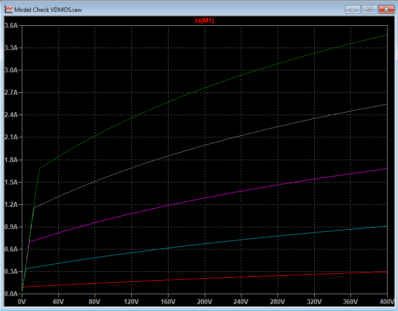

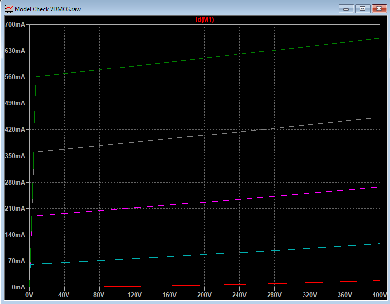

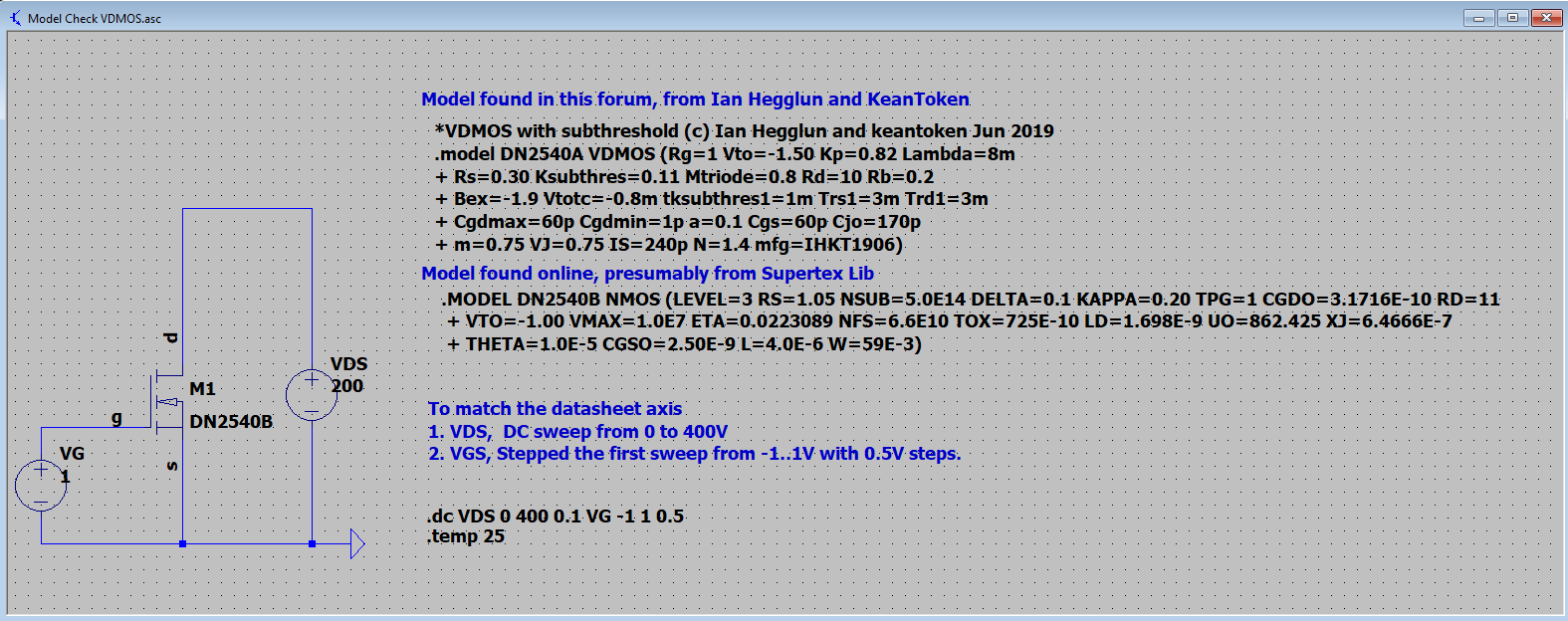

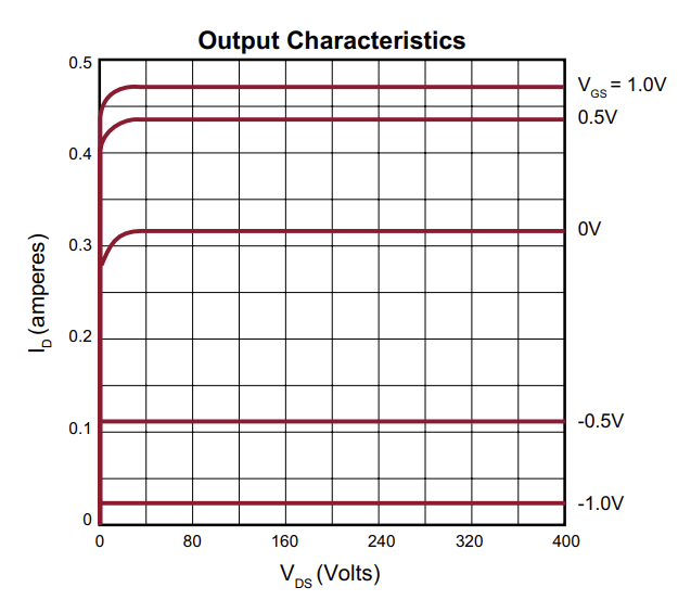

I'm working on a circuit where I discovered that the behavior in spice simulations is quite different from what I find in reality. Of course, this is no news to most here...
But my question is, maybe I'm missing something in the LTspice settings since my results are not even close to the diagrams I'm getting with LTspice?
Attached are the screenshots and .asc file used to give the overview.
I'm hoping somebody will share some insight here,
Best regards, Rens.

Ed, you’re right, however the used Vds and Vgs are exactly the same as in the datasheet, so I expected to get a simular diagram as per datasheet as a starting point.

However, I’m hoping to get some more background on how the simulation is so far away from the datasheets. It’s absolute values, knee’s and slopes are all different, so I suspect I’m doing or am understanding something wrong here…
