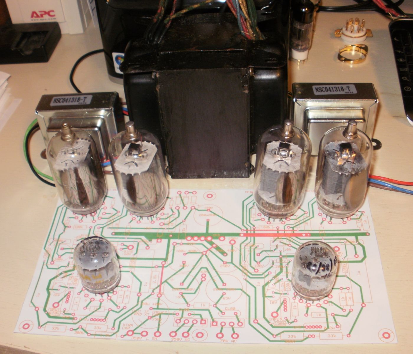

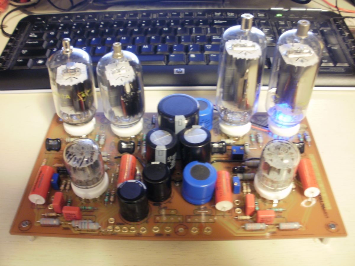

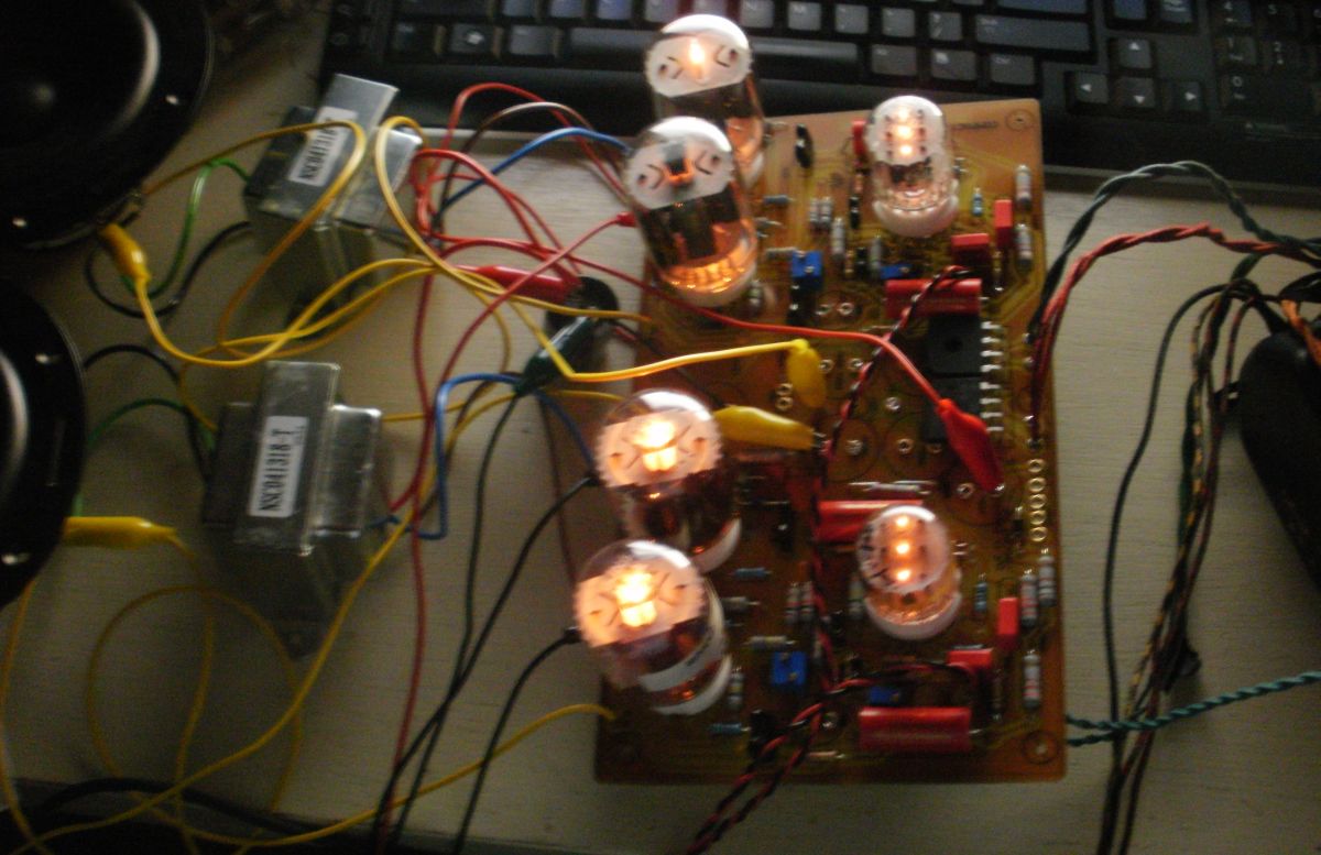

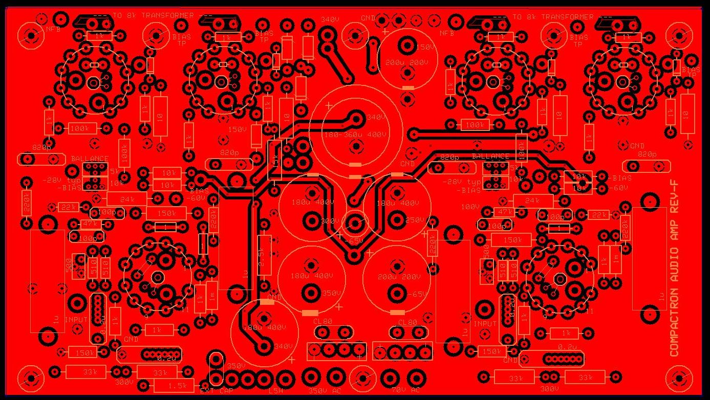

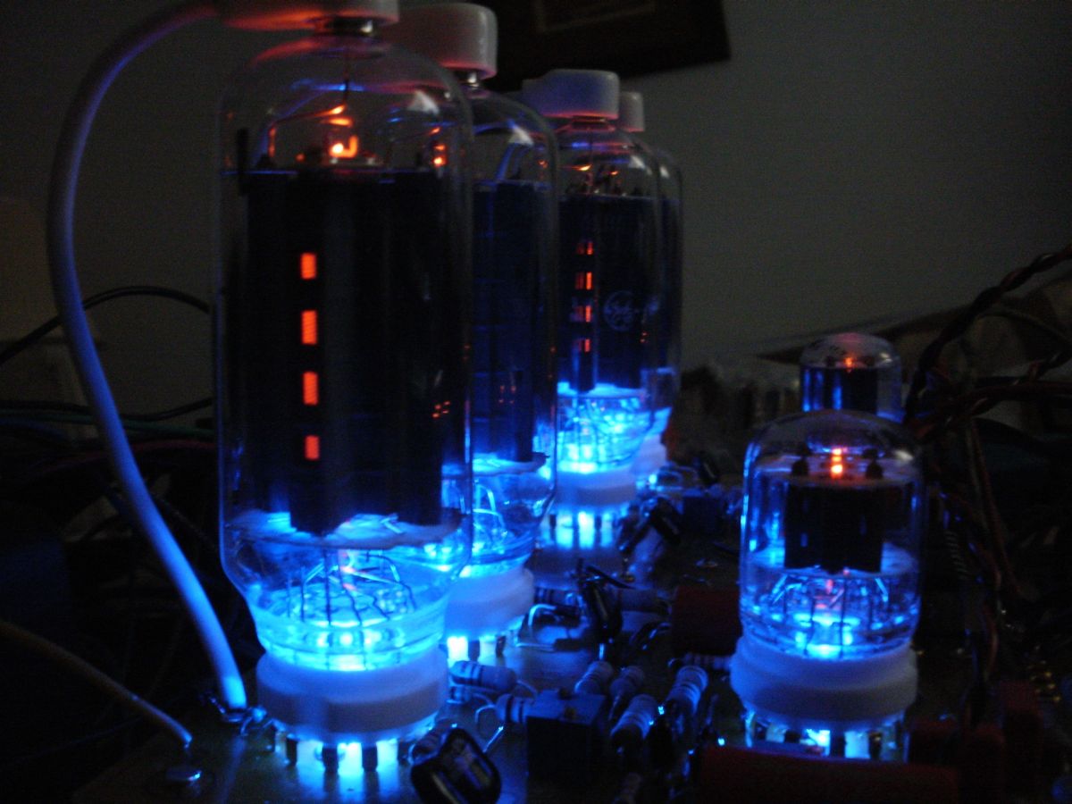

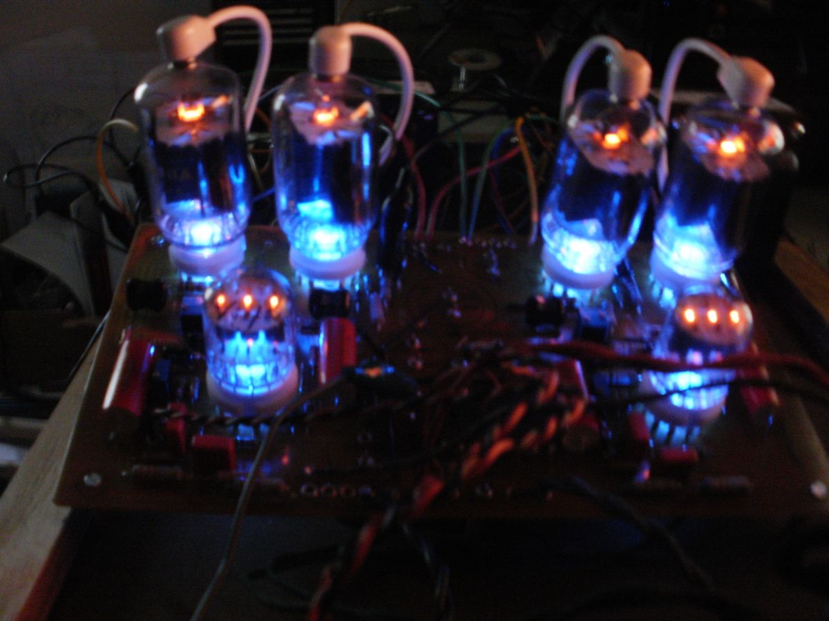

Just finished stuffing the board and applied power without speaker global feedback. The Monster lives, but with the global output feed back, less gain and is much better behaved, more refined sound quality.
6U10 for input and LTP driving 6JN6 (or 6JM6 with plate cap) output tubes running in triode mode. Pots for balancing and adjusting output current worked, running 40ma Iq with less than .001 volt mismatch across the 10ohm resisters.

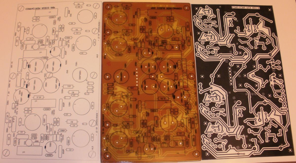

This is my first tube amp project, PCB was a challenge with the ironed toner resist method, used same method for front component identification..
eyelets for all through holes for wiring and back mounted caps.
Next, try different output transformers, refinement and put into a box.
Next project selected is a KT88 design driven by 6N6H Russian tubes LTP and 6SN7 front end to allow for tube / tone character selection.
SO many tubes, SO little time....

Looks cool, but substations that have such voltages have shields and scary pictures... It is more dangerous than electric chair, because it looks cool, and don't resemble a killing machine! I mean Reinout's picture.
I have a design that uses 7193 and 615 mickey mouse tubes, all with top cap connections.... to drive the outputs. There are several output tubes also with the plate cap....
Something to keep the finders out of. I was under the impression that it was done for capacatance reduction for a higher power band width..
Nice as those all metal plate caps look, I'm far more comfortable with ceramic ones or an enclosure.
That PCB look just awesome, obviously a lot of care and trouble went into its design and fabrication..

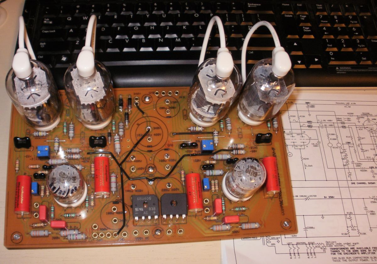

Thank you for posting the schematic! Do you have any PCB layouts you can share? I know it's still "beta"

Compactron PCB
The software I use is from Express PCB which is not gerber file compatable. They want you to order the PCB's from them which is a viable option. I print it out, correct the ground plane with white-out and then use a copy on hi-clay slick paper toner transformation method to iron fab the boards. I've only attempted single sided due to not having electroless plating capability for doing the through holes. The major change from revB to F was adding leds to illuminate the tubes from under the PCB and increased the bypass capacitor on board needed to shake the woofer cones while playing the heartbeats from "Dark side of the moon". I put a trace to the back of the board for B+ output transformer connection. For the prototype I just added a couple caps off board.

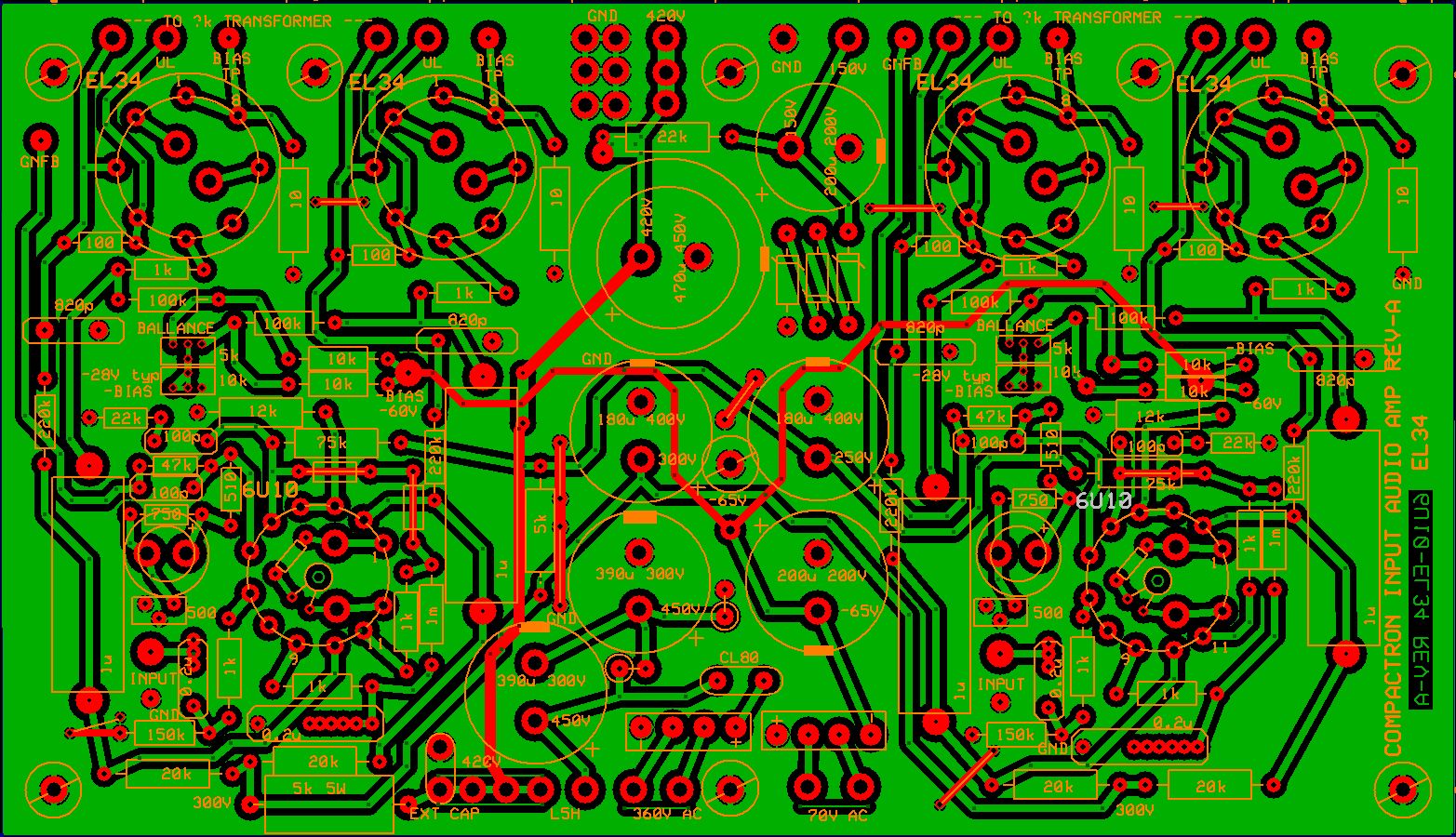

I played around today doing a ground plane top layer (red). Several articles I've read have stated, excessive capacatance will reduce the frequency response.

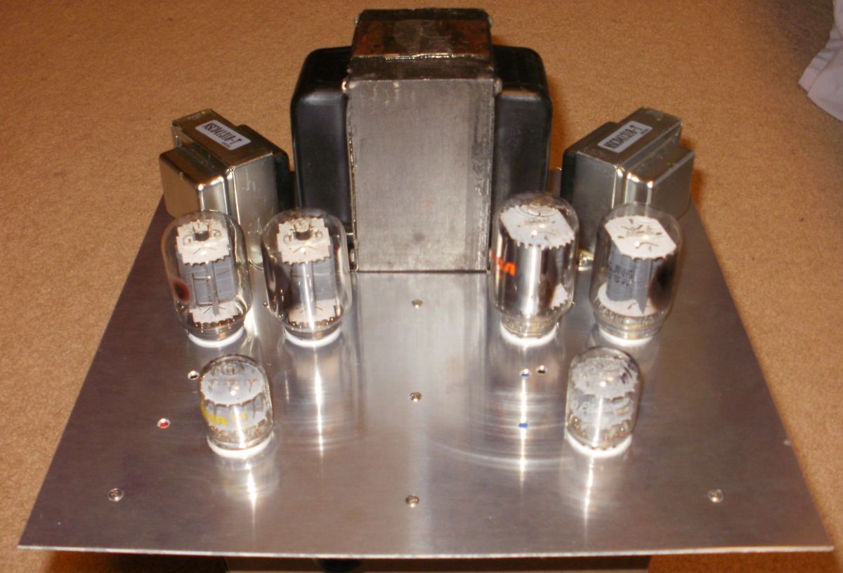

Got started on packaging, sheet metal measures 12x11.5". Also started to design the chasis wood. Need to find knobs. I hooked it up to a set of 4ohm Orions and adjusted the bias up to 60ma through the output tubes. I have a set of RCA's 6JN6's to put in it when I'm done with the construction, just using a mixed set for now. I've been using Sylvania and GE's for inputs.

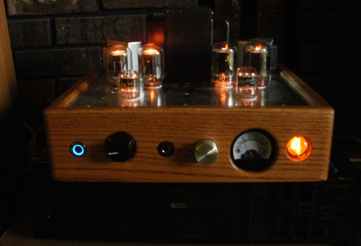

Elves work overtime on Compactron stocking stuffer
All but the knobs and upgraded iron. I have 1650H iron on back order and the elves missed delivery of the aluminum knobs, so I had to scrounge through the misc box to find something short term.
The nixie tube displays what tube's bias current is on the amp meter. It can be switched to "0" or blank when not connected to any of the bias resistors for normal operation.
Great clarity and large image with the little iron, can't wait to see what it can do with real iron...
Simple amp, MP3 input in the front and RCA's in the back, currently about 22-25 watts/channel, with the 8k-8 transformers, anticipate 40/channel with the 1650H's 6.6k hooked up as 3.3k.

I also did a PCB layout for EL34's/ 6l6's to try it in UL mode. Might try to etch that one over the holidays.
