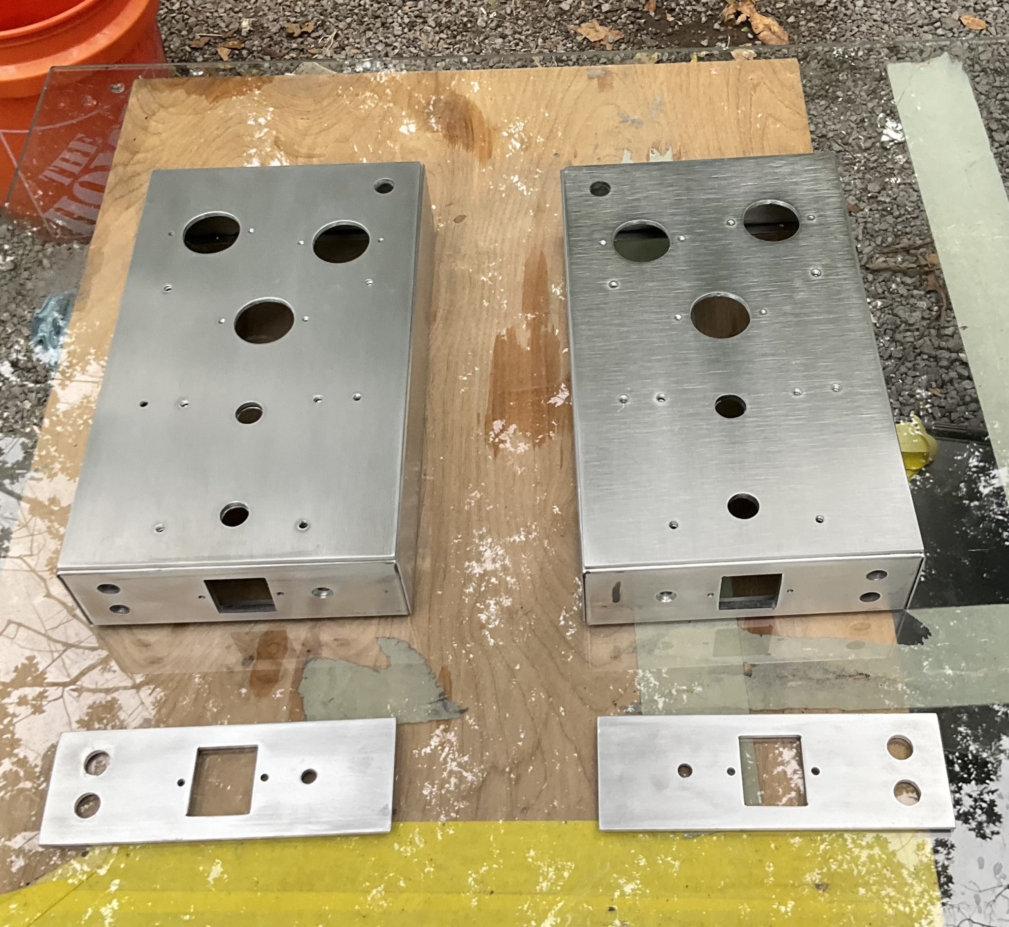

I used 2 Hammond aluminum chassis, 10x6x2. They’re like tin cans, but they’re inexpensive and I prefer aluminum. I cut tops out of .125” aluminum and braced the front and back from the inside with .125 aluminum. Another piece for the back as well.
I built these amps from an existing one that was a twin monoblock packaged into one chassis. It was designed to run el34s or KT88/6550s and was already strapped for triode mode. It needed a lot of work - I got one side working and I really liked it. I was going to have to fix some really questionable soldering and replace all the tube sockets and grid resistors and the chassis had some cosmetic damage so I figured with all that work, I’d just strip it and repackage it into something I would like better.

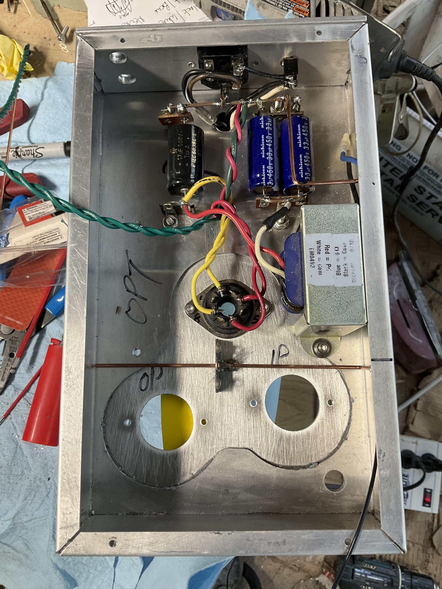

I can start moving on with second one. Here’s the power supply layout. 2 new nichicon 33uf 450v and an FT 47uf 500v with a choke.
I can use a 5u4 instead of the boutique Sophia 274b. I have a pair of the Sophia KT88s. I’m not sure if I want to buy another 274b or a Sophia 6sn7- I’m considering changing the 6sn7 to a 6n1p or 6922.
