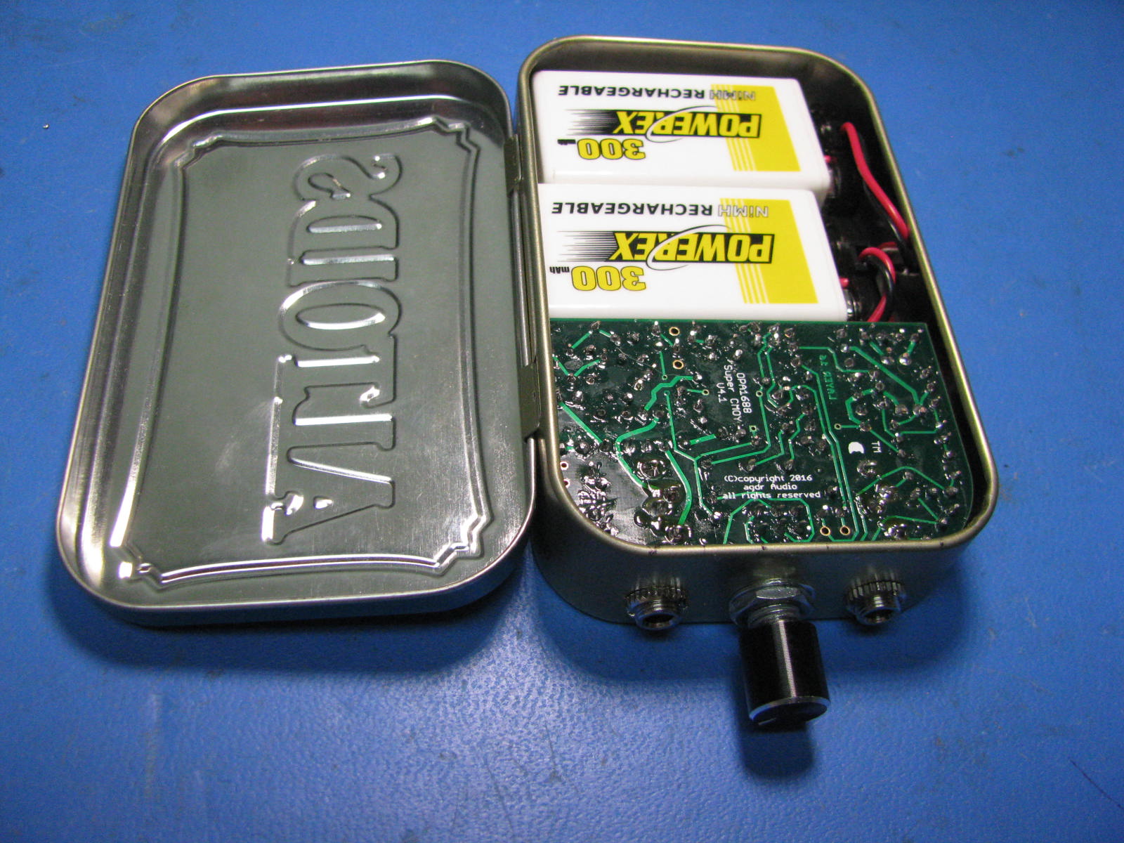

I'm looking to build a compact, wired, stereo headphone amp design that will be used for live performance monitoring (in-ears on stage, weekend warrior band).
Quality has to be good, with adequate volume levels, but doesn't need to be audiophile quality. I was thinking of taking and simplifying the Nwavguy output design, for example having only one NJM4556.
I'd like to make the unit small, I think it will be powered by +/- 9v or +/-12v DC feed, and built into a small belt-clip box with volume control.

Given typical XLR level feeds you probably just need a buffer, not any form of voltage amplification. That is unless your phones are 300ohms+ impedance types. A discrete transistor diamond buffer would be my recommendation, its power draw (quiescent current) wouldn't need to be very high so a single lithium cell could last many days.
Hi tuck1s,
Do you plan to run it on batteries? agdr has the smallest complete headamp design that I've seen here: http://www.diyaudio.com/forums/head...y-2x-9v-real-ground-headphone-relay-pcbs.html

With 16 ohm loads, supplies as low as +/-6 V have been recommended for the O2 to avoid overheating, not sure whether a single 4556A would be particularly amused.
I would do something like an O2 with the gain stage replaced by a balanced receiver. The XLRs out of a mixer can be assumed to be reasonably hot and required output voltage levels won't be that high, so I'd look at an input gain of -6 to -12 dB. Expected input clipping levels would be about +17 to +23 dBu, respectively.
Still not sure how "+/-12V supply" and "belt clip" mix.
If you wanted you could do something like this on +5V or even a lithium cell (3.7-4.1 V), that does rather limit your parts choices and your SNR though.

Thanks all for your comments. i first went to in-ears as stage foldbacks / floor wedges are usually pretty nasty. They add to the general sonic mush on stage, are heavy/bulky, and make microphone feedback problems worse. By "stage" I mean "corner of the local bar".
In-ears solved that for us, and give a useful degree of sonic protection against being near to the cymbals and snare of an enthusiastic drummer. I now can finish gigs, remove the in-ears, and have a normal conversation level with no ringing.
I agree our drummer needs something better than Apple earpods. I will remind him again. He plays other gigs with other bands, with open ears which is unbelievably bad for him (he's only a teenager and so adverse effects / tinnitus are going to last a lifetime for him). We're the *least bad* band he plays for in that respect.
I have one of these lying around unused: X5 PCM2706 + CS4344 +Dual TDA1308 USB DAC HiFi mini Headphone Amplifier | eBay
while the USB in and DAC are no use to me in this application, it's a nice, small box, well finished, with a reasonable output stage, and a pot and everything. If nothing else, it's a good donor box for the case, pot and possibly output stage.
I should be fairly easily able to find the tracks going to the TDA1308s, wire a separate analog + 5v DC input on the back panel, and disable the digital stuff. Several comments have suggested that I don't need wide rails for the low impedance cans, to achieve sensible volumes, which makes sense.
To clarify the belt clip idea - we currently use wired headphone amps on the floor, so we're used to not leaping around too much and remembering to unwire them before walking off!
