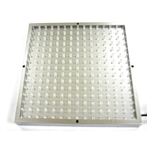

LED's are mature. (below) is what I start my tomato's with .. it is WAY brighter than the 160w (4 - 4ft' FL tubes) system it replaced and uses a whole 14W.
NO switching PS either , just rectified mains/cap with the leds strung in series.
Brightest light in the house for $40. Some of the led's they use for lighting will "die" shorted , making repair easy (like some Christmas led strings).

whaaaat!!! (like 100k+ @ 70%)life ratings are not comparable to incandescents
