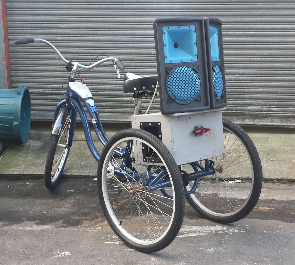

My first bicycle sound system - this was really neat, a compact and stable setup but the trike's shape didn't have any room for expanding:

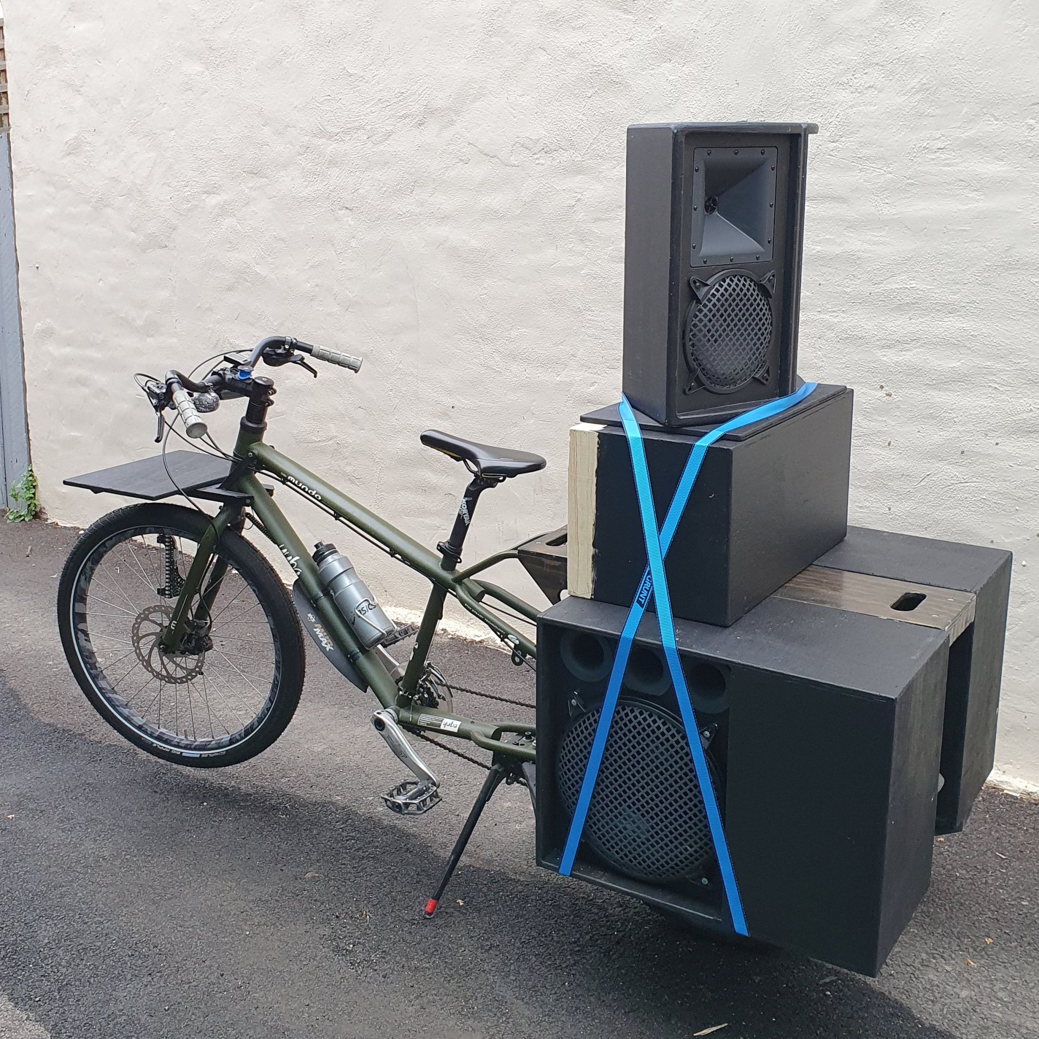

Wanting to go bigger, I switched to a two wheeled "longtail" cargo bike with 200kg load carrying capacity and built narrow bass boxes to fit on the side racks.
From memory these were ~50L and should've been tuned to 60Hz but I didn't keep any notes or measurements.
This is just a mockup, there was an amp box that sat under the tops:
When I moved cities I scrapped those boxes and built similar version - going bigger and really pushing the limits of what a two wheeled bike can handle
I think these boxes are ~60L and tuned to 60ish again
It's hard to believe, that with 80KG+ load on the back stacked that high that it was still very manageable when rolling along:

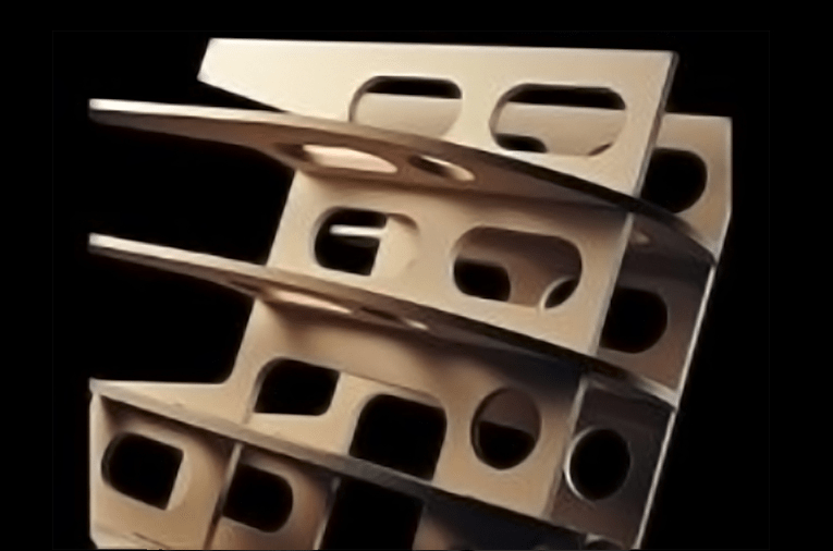

Could you handle something like a matrix braced enclosure build? https://audioxpress.com/article/speaker-design-driver-induced-vibrations
Or would a light, thin, under-braced, resonating box really make any difference, since it seems like this is more about loud and fun?

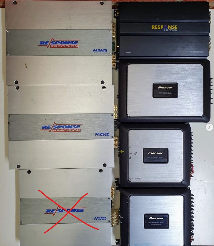

Power is from a 12V 100AH LiFePO4 battery, using class-d car amps I have four mono units that'll each output 200W in to 8r (35V), and two 4 channel that'll output 35W (17V) a channel or bridge two channels for 100W (28V)
Won't need them all just yet, and will probably need a second battery eventually. Currently have one Thomann 2 in / 4 out DSP and will look to get another one when required. Also have a few old MaxxBass 103 units for some fake bass, though don't know how necessary they'd be with modern music production already pumping up the harmonics

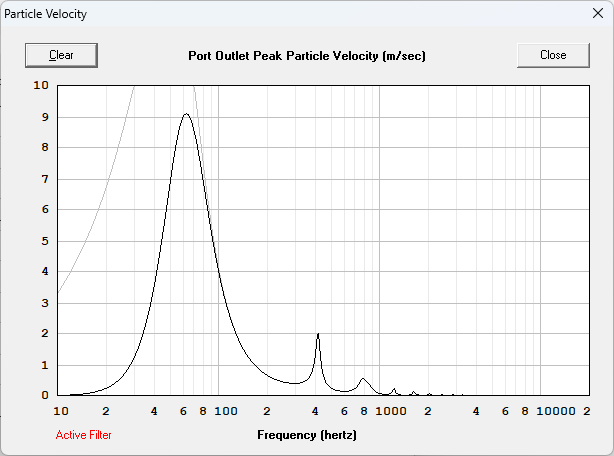

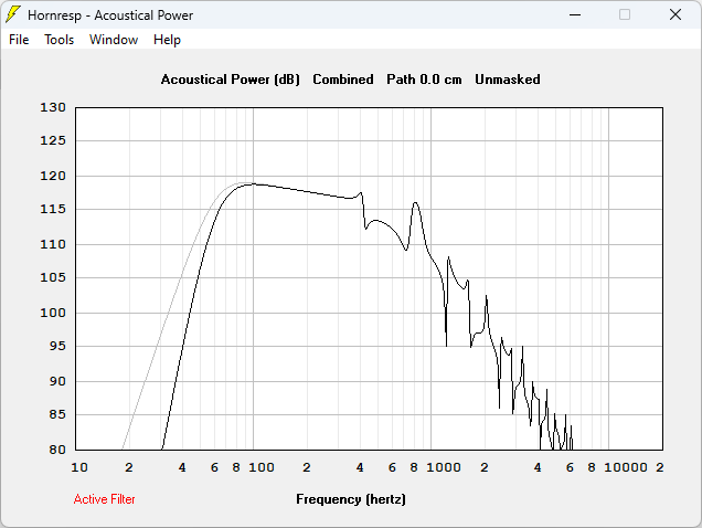

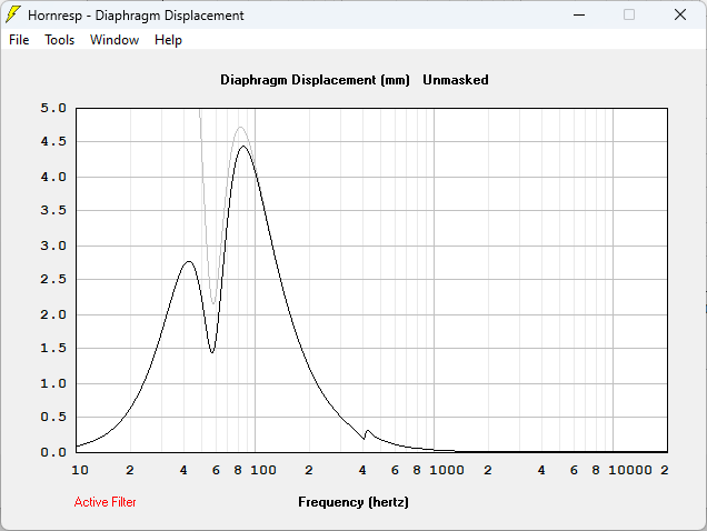

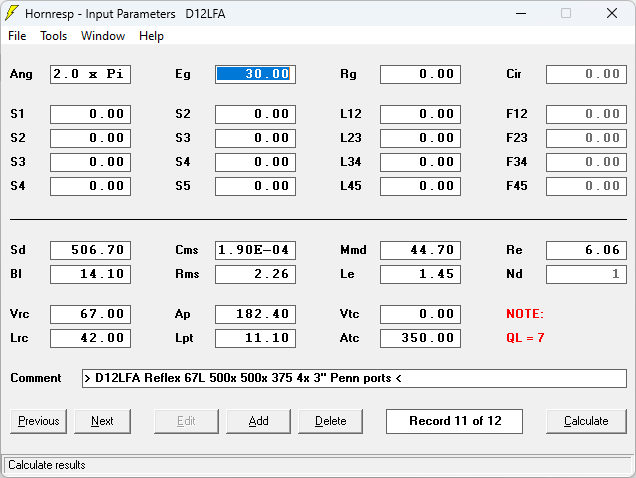

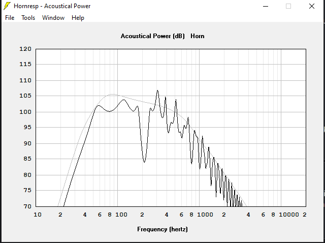

Here are the HornResp screenshots - 30V is my nominal amp output (should peak at 35V), so I'm happy to be close to xmax which means I'll be right on the limits of the driver when the amp hits its limits.
Filter applied is 60Hz 3rd order which is what the MaxxBass 103 processing offers, just to see what the response would look like with that in use:
Not sub, just bass... and should make plenty of noise.

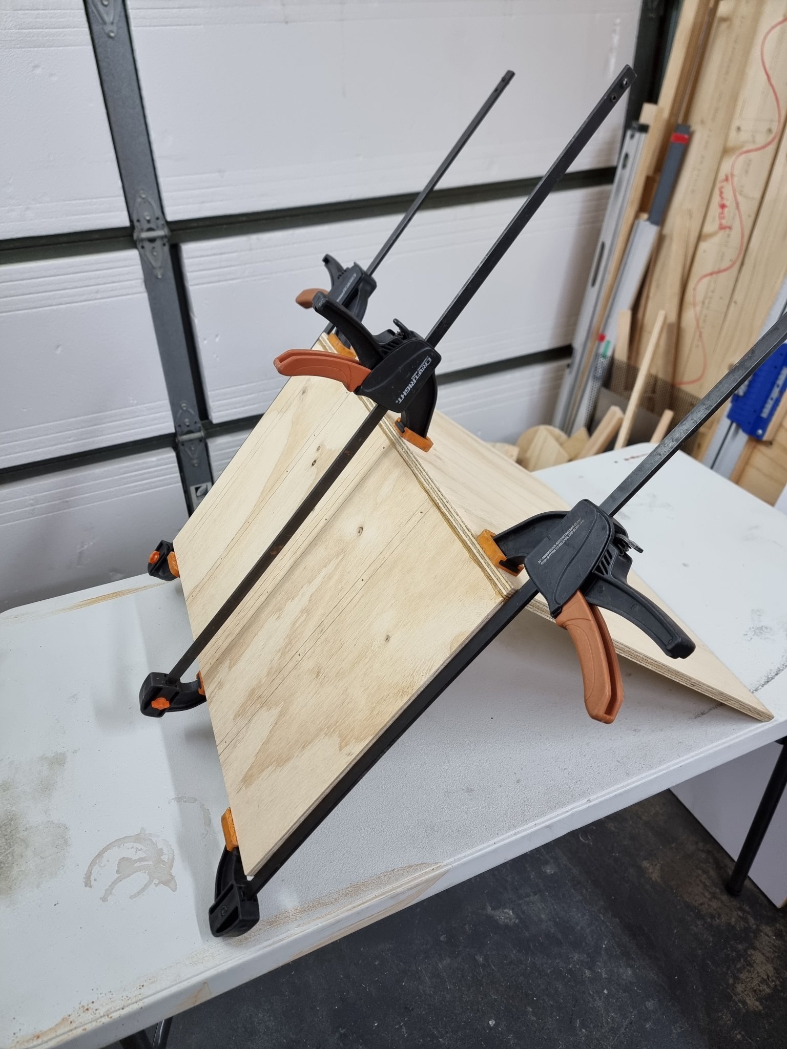

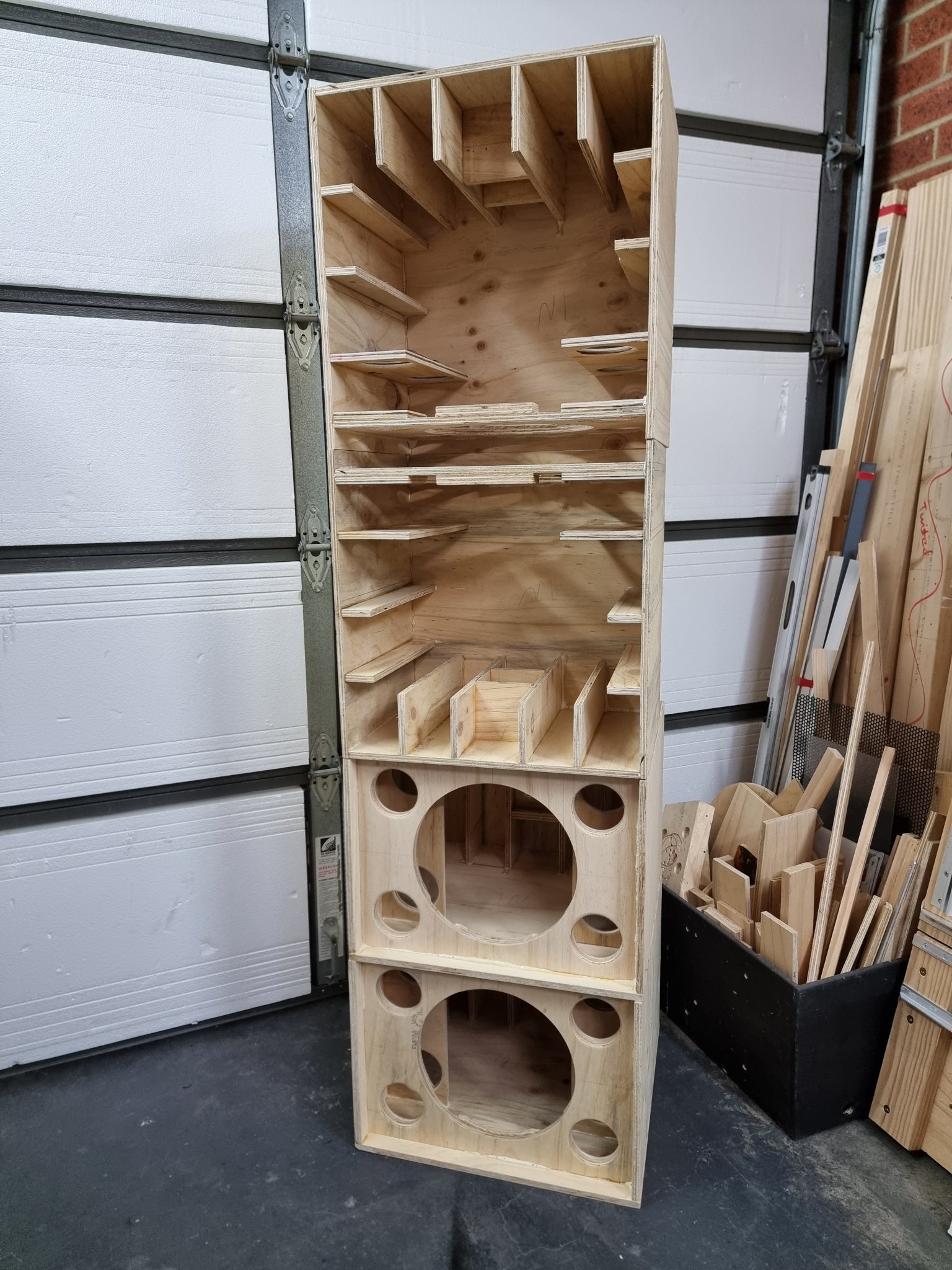

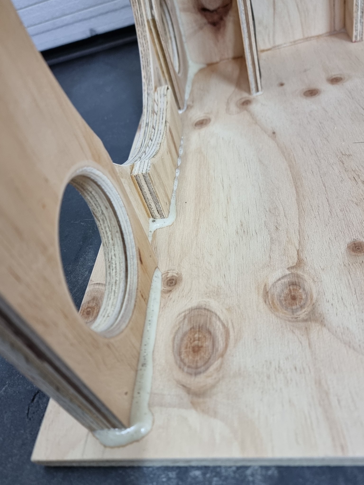

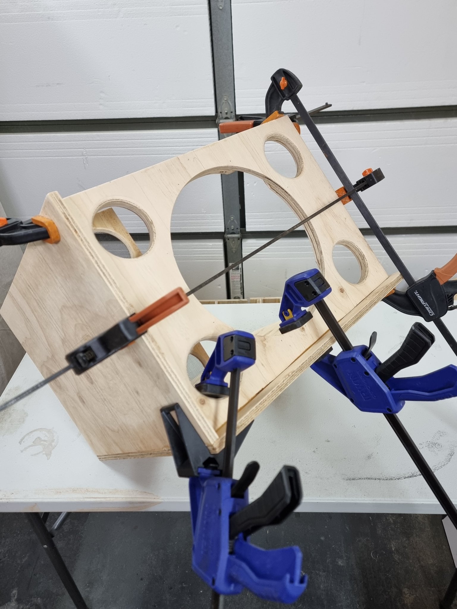

Here's a mock-up of the box, taped together for now, to see what it looks like. When drawing it out I wanted to add even more bracing since there's no sense of scale on paper, but looking at this in real life had me pretty confident with the amount of timber in there (relative to previous box builds).
Just missing the 3" plastic ports in this pic:

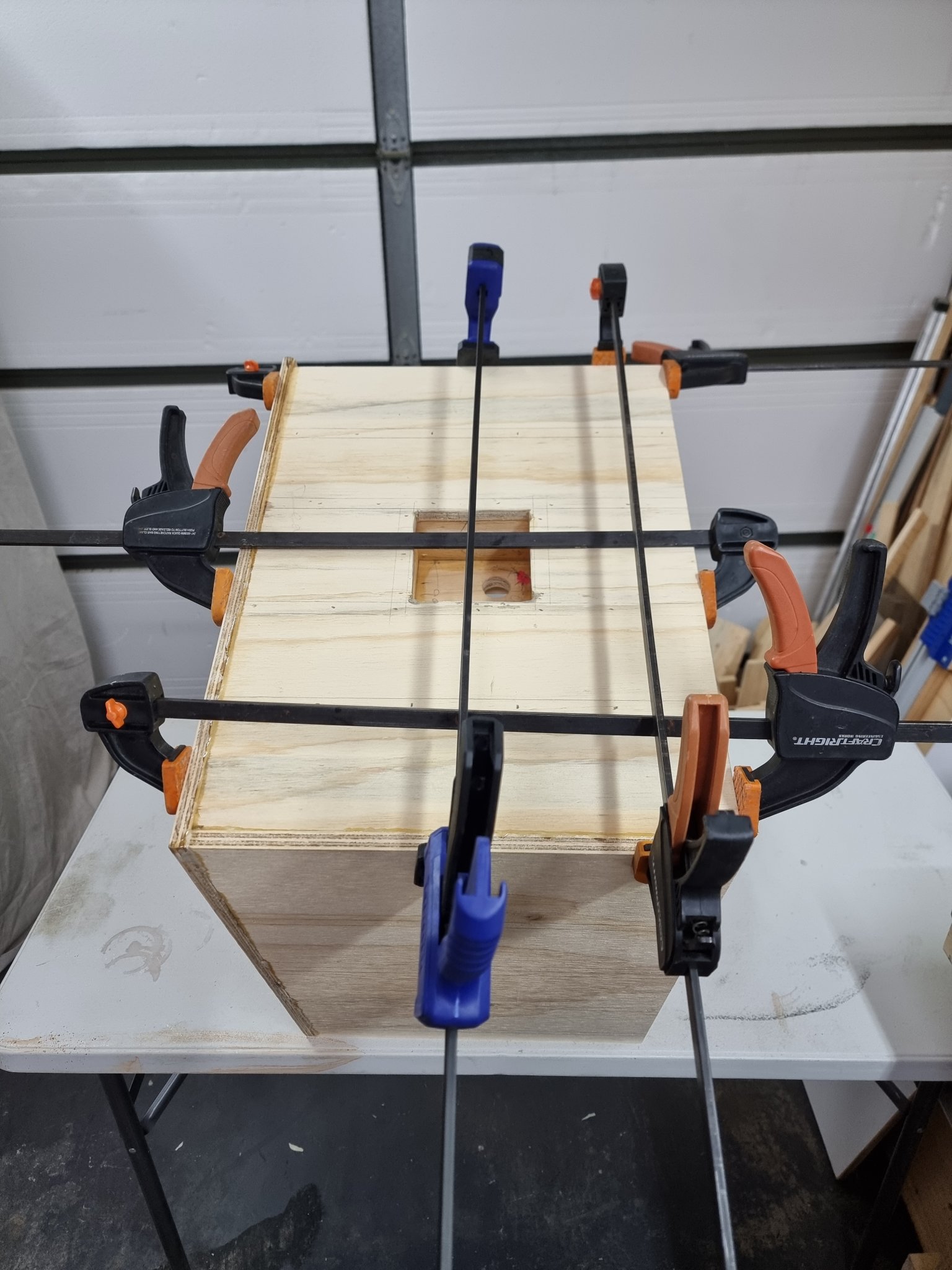

Since I was moving through the cuts fairly fast, I'm not surprised there were a few small errors across all the panels - a millimetre off here and there which is usually only learnt of when it's time to nail the last panels together.

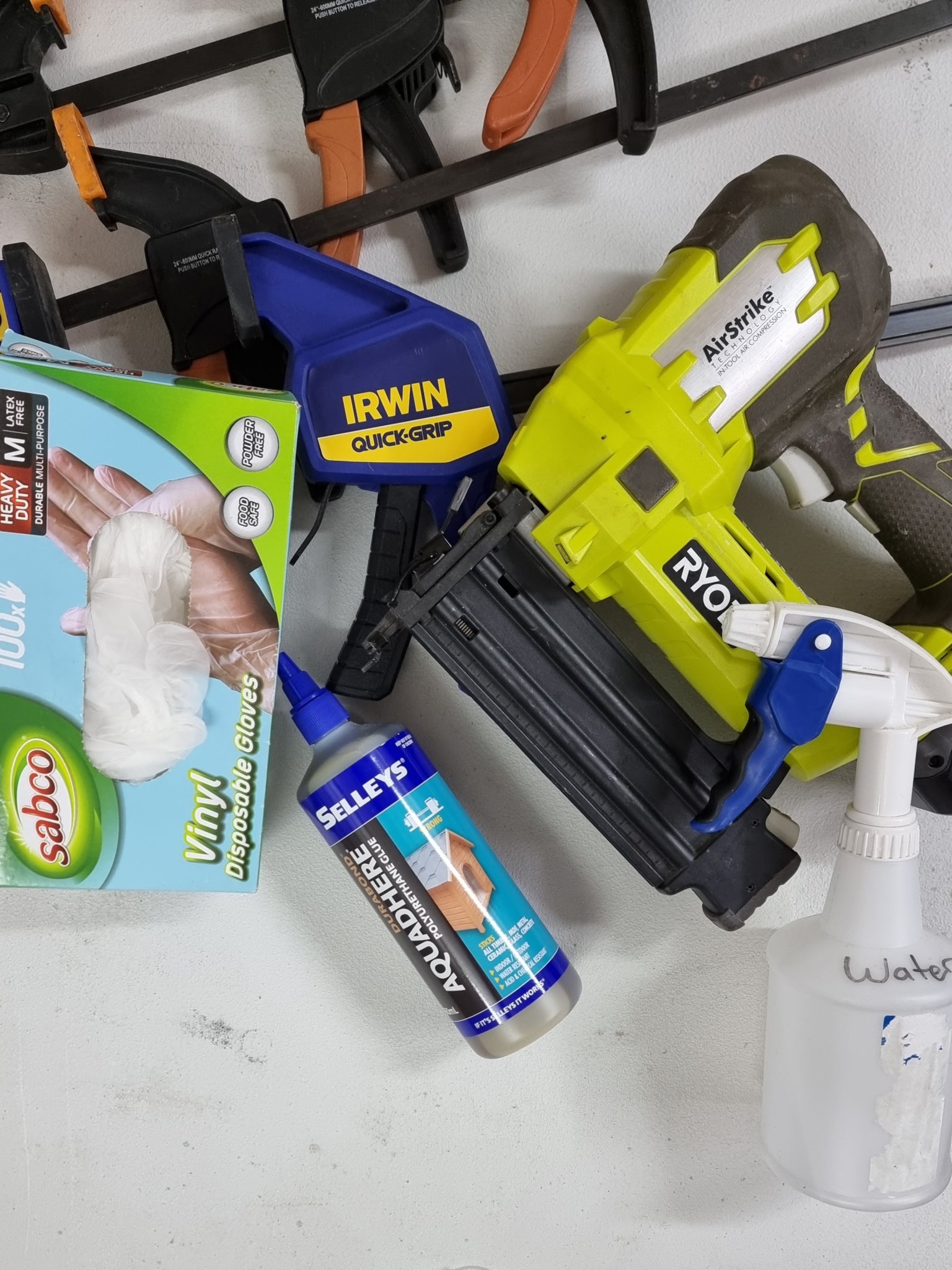

I'll be using polyurethane glue for its gap-filling properties, so I can chase a square cabinet without being as concerned about those small errors and their potential for leaks.
Strength of bond isn't a concern since with all the bracing for the size, these should be pretty solid boxes.

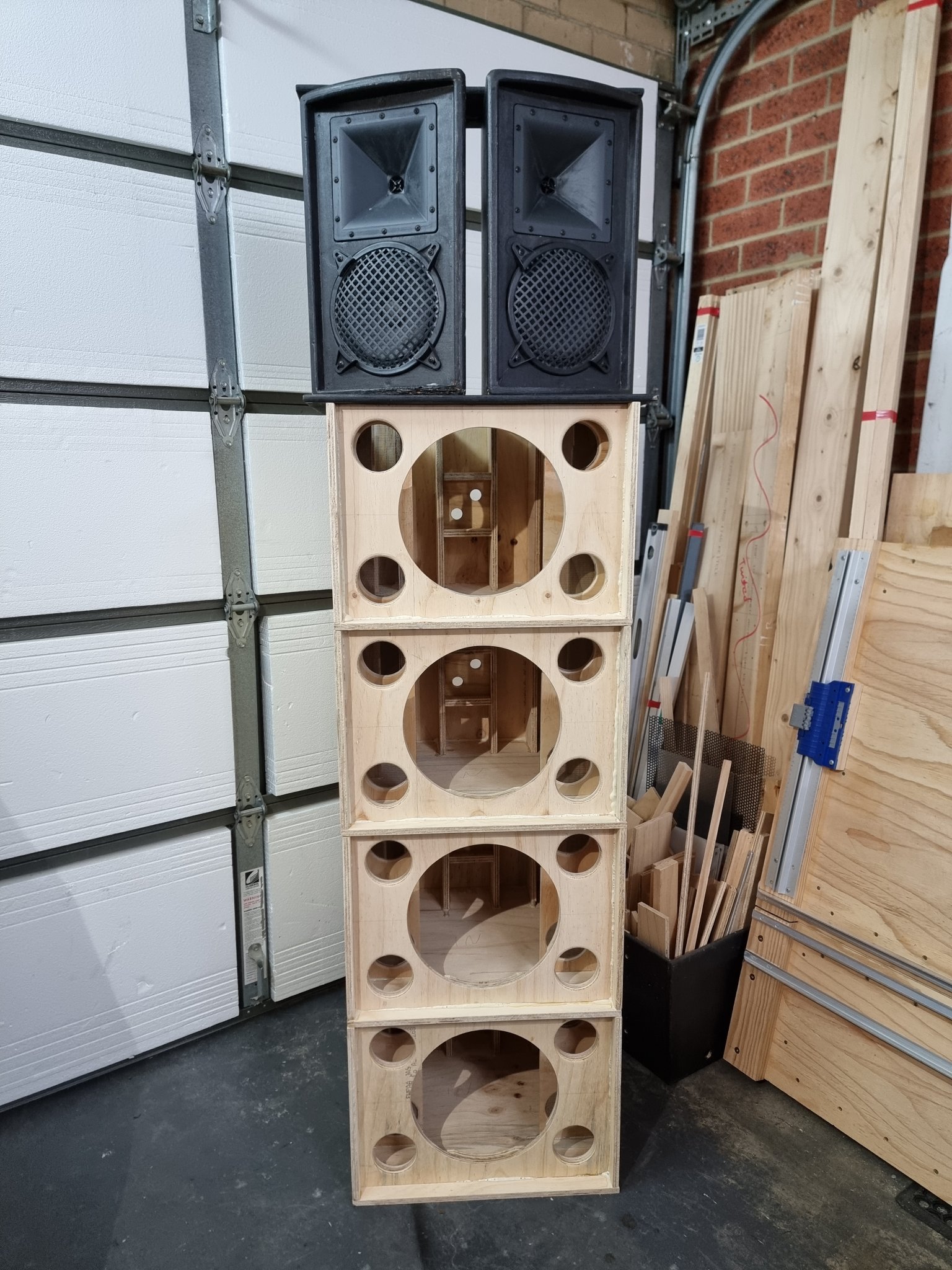

I now have a timeline to work on, the newly built system needs to be ready in 5 weeks time - to be used for the dance floor of my impending wedding!
Here are some progress pics, with the full stack standing 2 metres tall - should do OK for a 12V system 😏

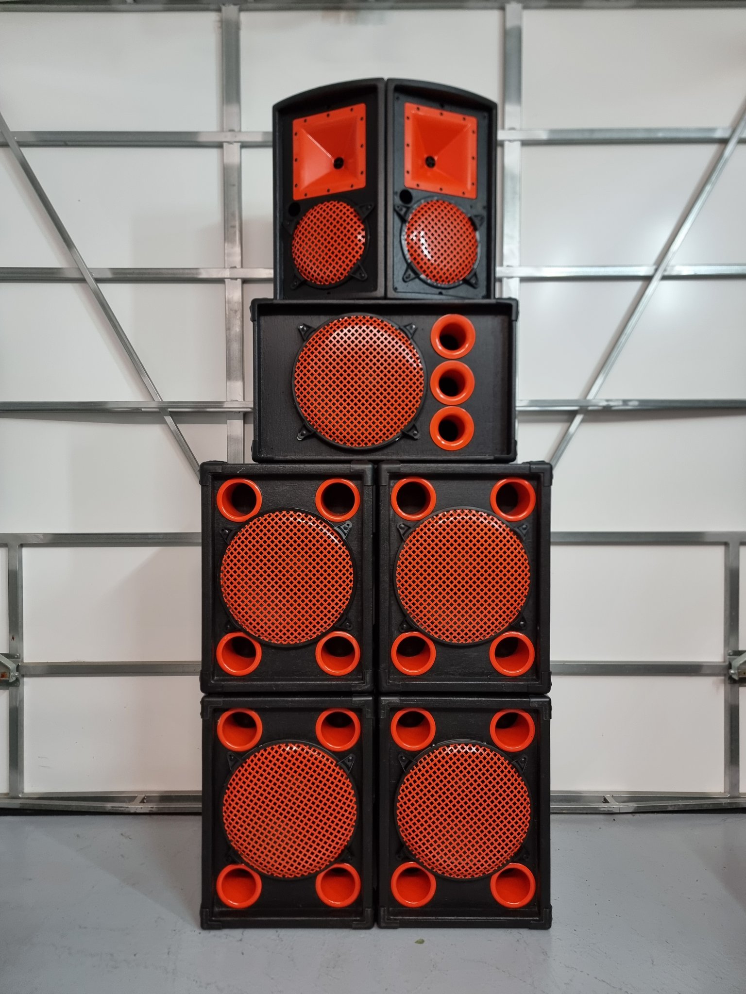

8 months later, I made a lot of progress in the past two weeks - as always the pressure of a timeline gets things happening...
The first outing will be this weekend: Bike Rave Melbourne, I've arranged to borrow an electric Carla Cargo trailer which should easily carry this 1.8m tall, 90kg pile of noisy plywood
Will share final details of the build and report back on performance once that's done

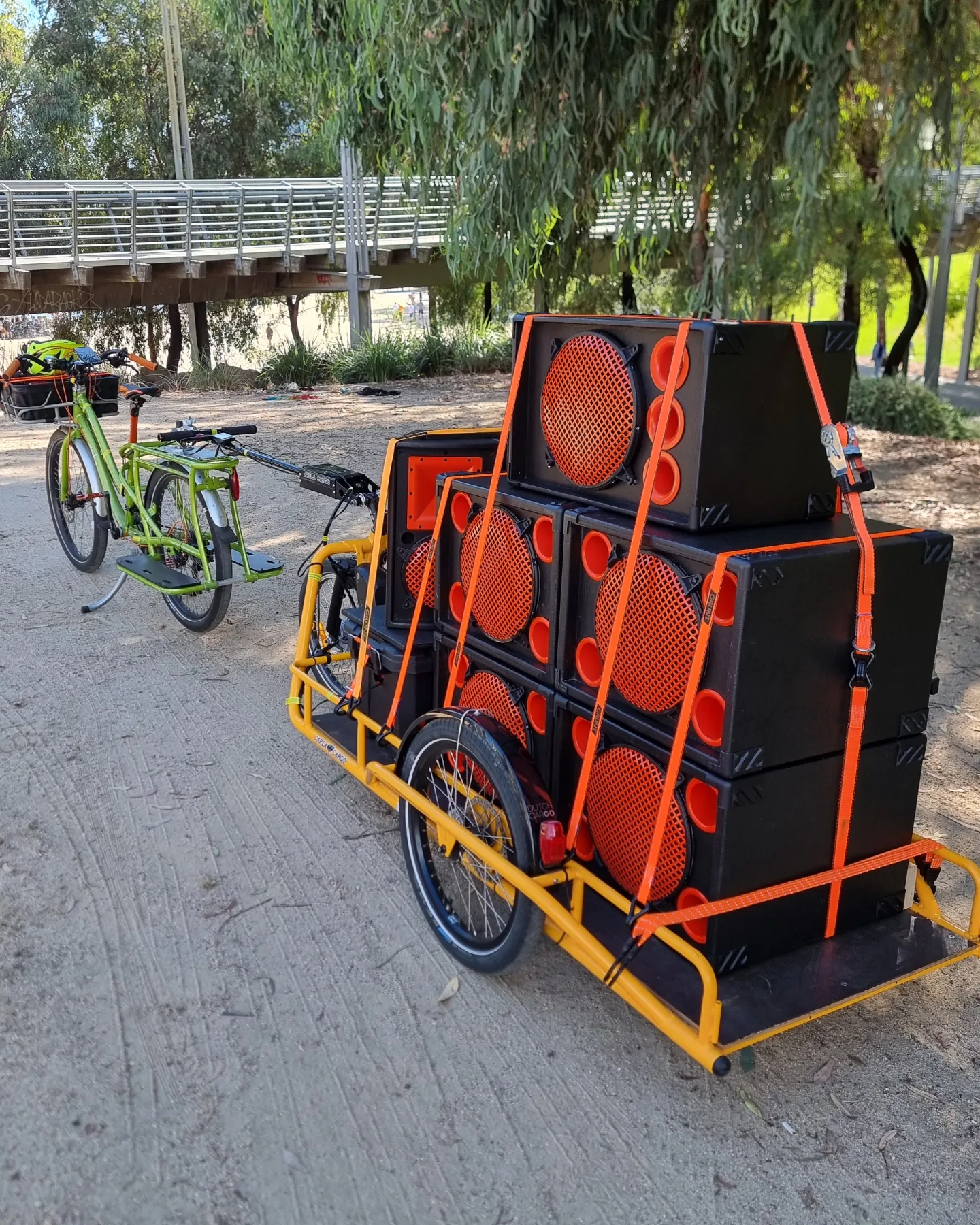

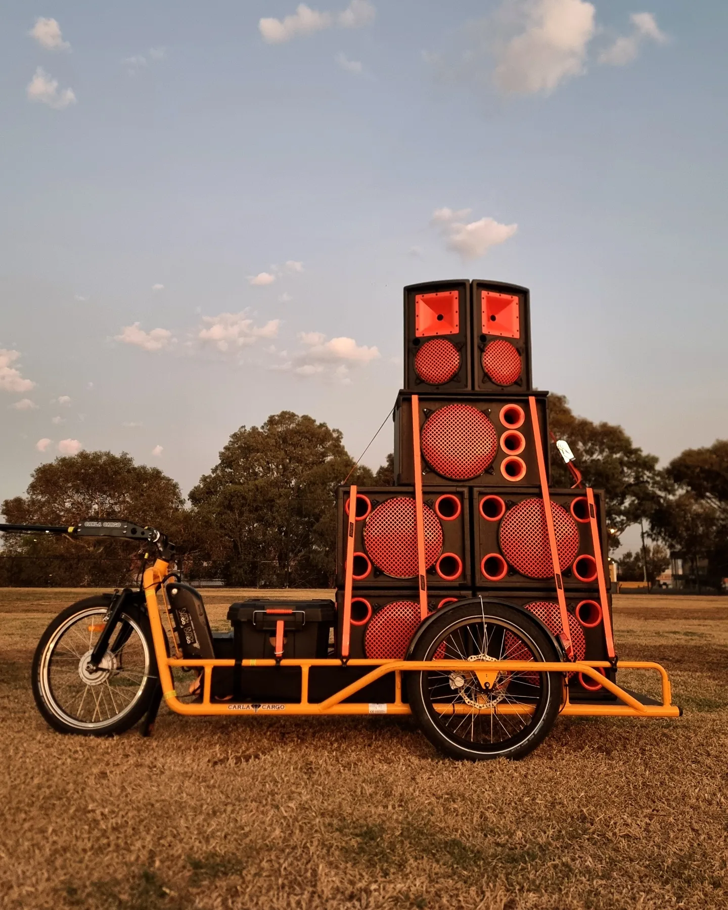

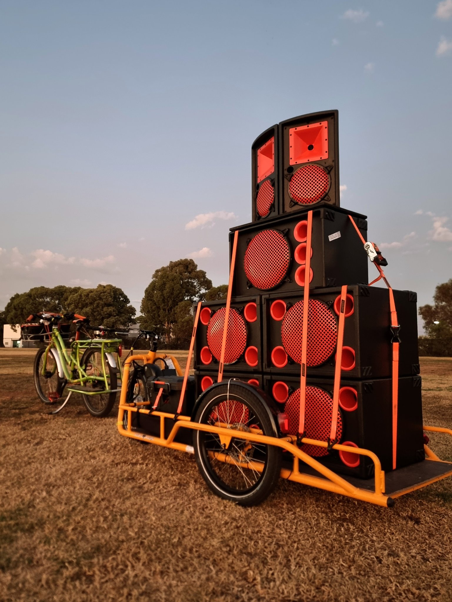

11 months later... I realised I didn't update with the final setup last year
Here's the stack set up on the Carla trailer
And with the tops dropped lower for stability in transit:
Melbourne's 2025 Bike Rave is coming up next weekend, and I'm needing to rush to build a better amp box (one that encloses the battery too).
I'll try a different speaker configuration this time, as an "end fire" setup - facing the rear of the trailer, which makes more sense for projecting on to the crowd when it's on the move. Will try and update a bit sooner than the last two times, once I test it and get some more pics.
