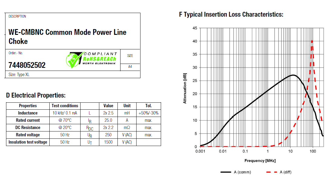

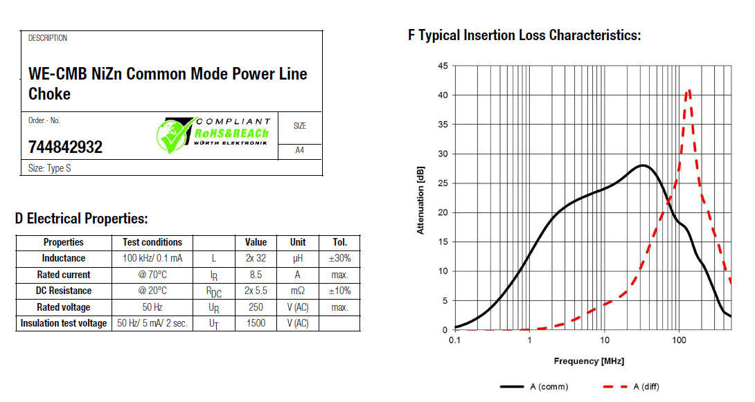

The extracts from the datasheets below show 3 excellent Nanocrystalline CM chokes with very low DCRs that I may be able to use in signal input to reduce the common mode noise coming from my BD player with a SMPS power supply.
These 3 CM chokes have inductance values of 32uH, 1mH and 2.5mH respectively. But their "Typical Insertion Loss Characteristics" are much closer than their respective inductances indicate.
It makes me think if the inductive values are relevant. I mean, if you create LCR filters based on the inductive values, the response will be much different from those in the "Insertion Loss Characteristics".
How can I design the LCR filters based on the datasheets? How can I know the inductance values for sure, because if the values are not accurate, the LCR filter can create more noise than it needs to reduce. Obviously, if 32uH could do what is in the graph, it will be far easier to implement because the damping resistor need not be high, whereas with 2.5mH the damping resistor may be so high that the RC filter (even with L=0) can roll off the 20kHz signal!
Please help me to understand how to read the datasheets for CMCs.

Those are suited to power line applications, not signal. Also because their DCRs are so low the attenuation they're giving isn't particularly high. For a BD player I'd have thought a 0.5A current rating would be plenty, then even normal ferrite CM chokes will give CM inductances in the tens of mH.
Did you notice that the insertion loss was given at different frequencies? Insertion loss, of course, also depends on the details of what comes after. This is unstated, but may be some industry standard for a mains supply.HiFiNutNut said:These 3 CM chokes have inductance values of 32uH, 1mH and 2.5mH respectively. But their "Typical Insertion Loss Characteristics" are much closer than their respective inductances indicate.
Look closely at the graph scales and at the frequency of peak attenuation.
Insertion loss is probably measured in a 50 Ohm system if nothing else is stated

Thanks, guys. It makes sense. I have not found any descriptions from the manufacture on how the insertion loss was measured. But maybe 50 ohm system was used.

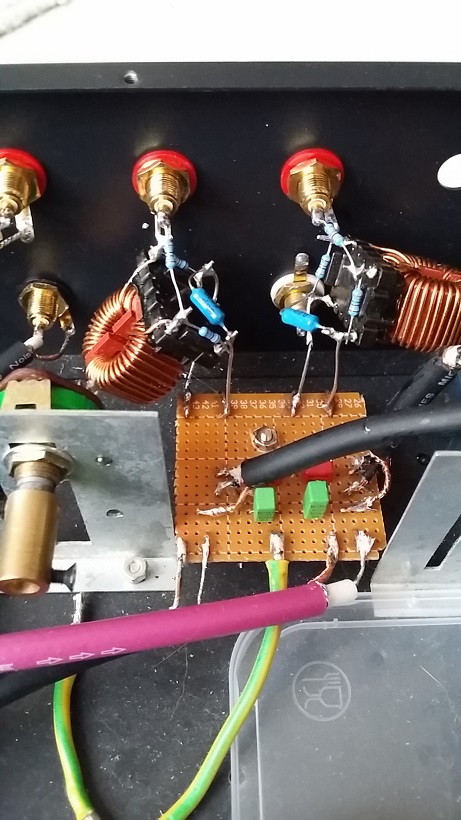

See the picture below. I tested using a 3.3mH CM choke at the input of my preamp and subjectively it cleaned up the sound quite a bit. I had to use some resistors in series as well as in parallel with the CM Choke on both the signal and ground sides so that possible resonances are damped. Without the damping resistors the sound was not as clean.
But going further seems to be difficult, because if I model the LCR circuits using the inductance given I found that it requires quite a high value of R to make the LCR damping effective, but higher R rolls of the signal below 20kHz. I could not buy a lot of those CM chokes for experiments because they are quite expensive.

The published inductance will hold good up to a bit below the point where the graph of attenuation stops going up and starts coming down.
