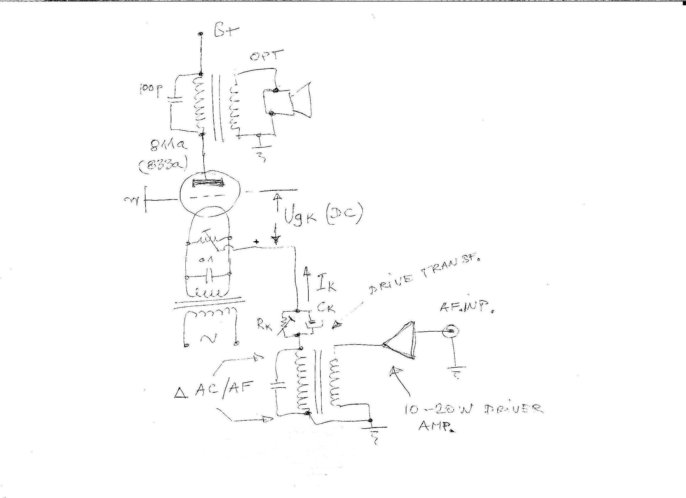

If I understand you correct than this my schematic approximately represent what you have done experimenting with GG power amp for audio use , but maybe I`m wrong .

Your schematic is the correct representation of what I did several years ago,. except that I did not have the resistor or cap in the cathode circuit. The 833A requires positive grid bias for plate voltages below about 1KV, and works with zero bias around 1KV and needs negative bias above 1500 volts, depending on the tube. I simply adjusted the plate supply to gat about 100 mA of plate current.
Bias can be applied to the grid provided the grid is bypassed to ground for AC if a conventional tube is used.

Got everything correct about bias of 833A power tube now,
but from my experience (RF) must say that is always better to leave grid (high Z input) tied on the ground , and to apply bias voltage on the cathode(low Z input) supplied from some low Z bias source , in case that you use driver transformer that can be done by disconnecting lower secondary wire from ground and to connect there variable bias source , with some exact value of positive bias voltage for `normal ` power tubes , or even some negative bias voltage value in case when 833A work with B+ under 1KV .
Any way I`m sure that very high quality SET amp can be done in this way (GG) , almost with ultimate quality , same as for GG- PP amp .
