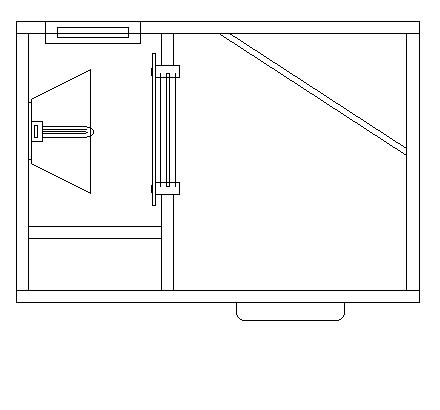

I have sketched out a really rough plan to see if fitting this setup is going to be feasable in the commercial PJ case, if someone can have a quick look and see if it could all fit into a case that is roughly 11" by 11" square?
And obviously suggest some improvments to it! I realise there are other parts I will need but the sketch is roughly how everything should work isn't it?

in the front right on the projector...in that empty square, thats where you would place your LCD controller.

The commercial case I have is 11" by 11" square
Will that be enough space between my LCD and lens to allow a good throw distance?
Are there any calculators I can use to calculate screen size, throw distance etc.....
Or can I get a zoom lens???
