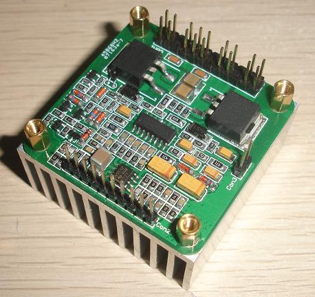

I'm working at a multichannel amp design which will use modular concept, the power modules does not use any electrolytic cap, to allow long-time operation even at high temperature, the module is fitted on the heatsink directly, and if electrolytics are used, their life expectancy would be significantly lower.
On another design, which is in concept phase now, i'm gonna use just film caps for all the caps, including primary side bulk storage. 🙄
