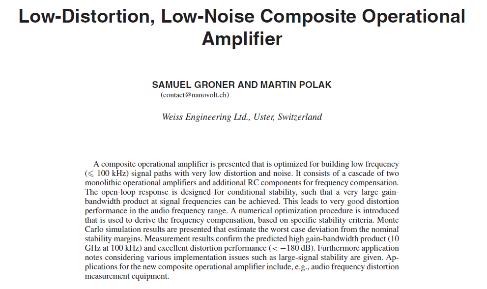

The lowest distortion opamp in the world, at the moment, is the Groner Composite; refereed Journal paper abstract below. Jan Didden made PCBs and sold off his spares at cost, right here on diyAudio, a couple years ago.
It costs about USD 175 to join the AES and get unlimited access to their library of publications.
_
Thank you very much for this advice. here is the URL for the associated thread
Samuel Groner's super opamp

maybe one of companies for discrete OP-amps have realized Groner's approach under
https://convexoptimization.com/TOOLS/groner.pdf
AES E-Library >> Low-Distortion, Low-Noise Composite Operational Amplifier
