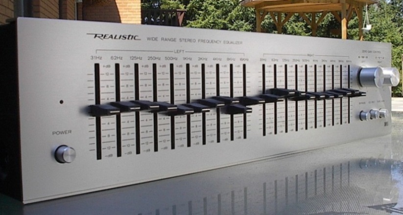

I got this for nothing. It's a Realistic model #31-2000 made in Korea for Tandy.
It's in fine shape, no scratches or damage. It works fine, seems to have good functional control over the frequency bands.
Is it a good unit? I know, most "audiophiles" would say these are nothing more than distortion mills, no place for even the best of them in a superior system.
I like the ability to contour the sound to my preference and at least try to overcome some of the room problems. I also like the way this unit looks - it matches the equipment that I have.
OK, main question: If this is truly a pile of garbage circuit wise, is it worth building a circuit of filters for it with low noise op-amps?
The current circuit is all discrete, using (mostly) transistors 2SC1222 and 2SA953.
A pic of the insides is coming but here's the front:

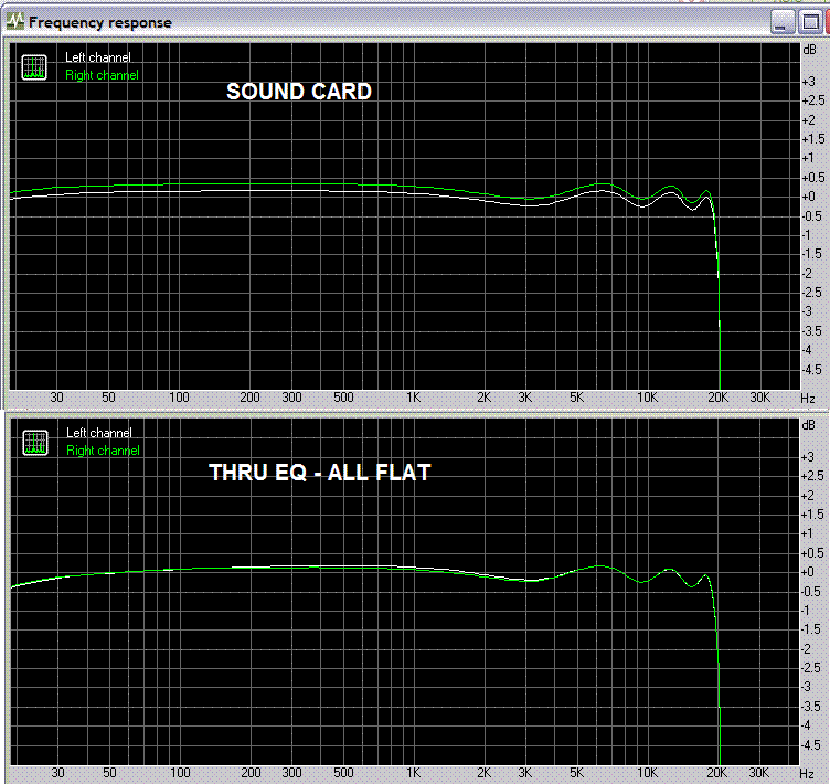

I dig up this older thread because I have made some tests on this equalizer.
First was a listening test. I found that if I used it to cut only, it worked very well. The sliders cover quite a sweep, too much in my opinion - they go from -12db to +12db. Cutting (or boosting!!)any part of the audio spectrum by any more than 2-3db means there are other, more serious problems to address.
I had the unit attached between my pre-out on my Yamaha HT receiver and the input to my (new) active amp . It was fine, I could effectively reduce some of the frequencies that I find too harsh on most speakers (low mid to mid - 300hz to 1000hz).

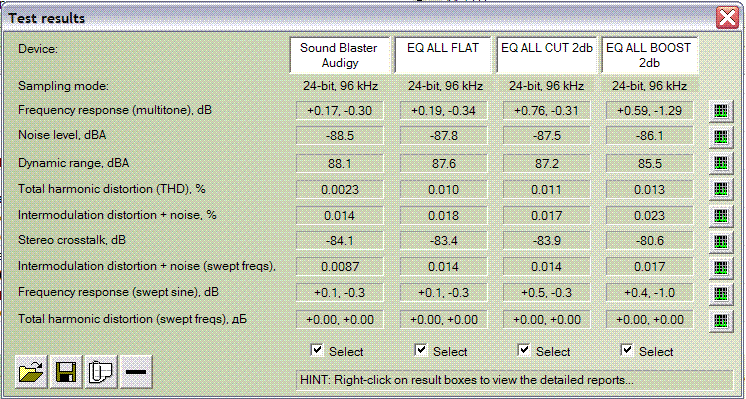

I then ran some tests on Right Mark Audio Analyzer. Connected through my lab computers sound card, I ran three tests: 1/ with the unit on but all of the sliders flat. 2/ All of the sliders on both channels with a 2db cut. 3/ All of the sliders on both channels with a 2db boost.
Here's a screen shot of the results window. First test of the group is the sound card test (provides the baseline performance).
As it can be seen, the equalizer adds about .0077% THD with all of the sliders at 0db. Cutting by 2db worsens the distortion by only another .0001%, and a 2db boost will increase THD by .0002%. This is not too bad, if you are starting out with a low THD amp to begin with.
That's THD. What do the frequency responses look like?
Here's the first two: the sound cards natural frequency response and beneath that, the equalizer a 0db boost/cut.

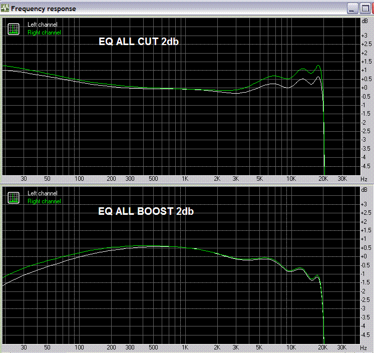

And this is the frequency response of the last 2 tests, cut 2db and boost 2db.
It's not very linear. More boost or cut in the mid bands with the same slider travel. BUT, no big drops or peaks, so not that bad.
My conclusion is that I'll use this equalizer and be satisfied with it's very good performance...for now 😉

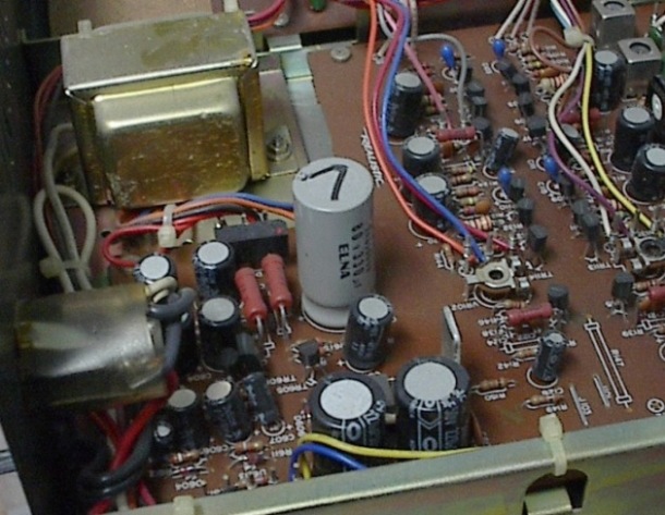

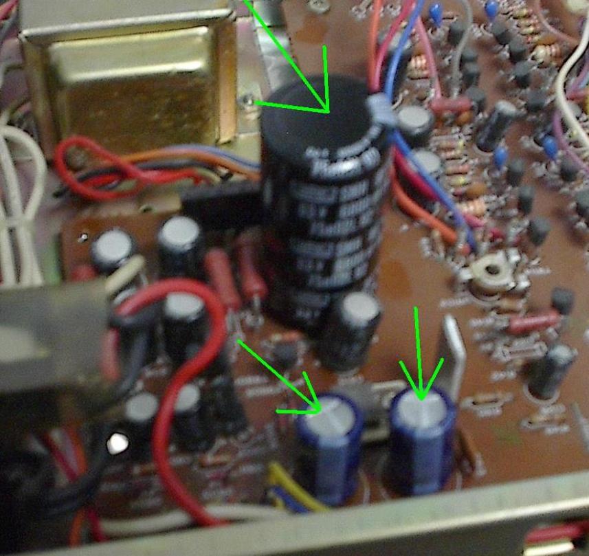

I got ambitious last night and did some power supply work on it.
This unit has a small transformer, maybe 25VA, with two secondary windings. The first winding provides for the op amp supply (+/-15V), the second is for the discrete section of the board, and provides +56V.
They have a 330uF/80V Elna for smoothing on this supply and have split it from there to two rails (I assume one for left, one for right). These rails are decoupled with a pair of 220uF/63V caps.
I changed the 330uf for a 6800uf/100V and the 2 220uf I changed for 2 new Panasonic 220uf/100V.
I then did the sliders flat test with RMAA. There was a slight improvement in THD, but hardly enough to justify the changes. I removed the 6800uf and put in a new Elna 330uf/100v.
Pic shows the original. The three caps are visible in the centre and near the bottom.

Changing the smoothing cap from 330uF to 6800uF was good for a .0005% decrease in THD, with no other visible performance increase on the tests. No, I didn't take it and listen to the results. I wouldn't hear a difference anyway (I think it sounds fine as is).
Part of the reason for this exercise is to prove to myself how much of a difference these "tweaks" make. You read a lot here about how different power supply caps sound this way or that way. I've always believed that to be nonsense.
Here it is with the caps changed, with the large 6800uF sitting in a chair that's too small for him. As I mentioned above, I changed that for a new 330uF and left the 220uFs alone.
