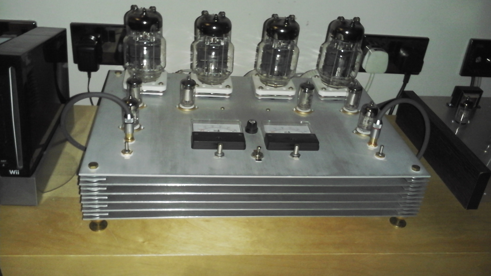

Explanation of circuit:
L1A and B is the first tube, being a twin-triode. It is used in a long tailed format, as input stage/phase splitter. P2 balances the first stage, R9 supplies the negative supply.
The output from this stage goes to L2A and B which is the driver section again in long tail.
Circuit is clever enough to use DC coupling to the driver section.
The driver section is coupled to the output Migs by capacitors, P3 and P4 bias the output tubes. you should measure the voltage drop across the 1 ohm resistors on the plates (R18 and R19) in order to set the bias. I would measure voltage drop across one of them first and set the bias to whatever the design says so. I would not connect speakers yet,connect an 8 Ohm (or so) across the speaker outputs as load. I would then adjust the other trimmer, to get as near to zero DC voltage across this load, check your adjustment after 30 mins to make sure nothing has drifted.
There are four power supply sections.
2 identical 150 V for the output tubes, a tube based HV for the input section and driver, and a last negative one to supply about -70 V for biasing the output tubes.
I used solid state for all, no tube rectification, but I did use 22nF snubbing capacitors on all my diodes.
What is puzzling, is that I do not see any feedback section on this design! Hmmm
I would have split R7 into four resistors, about 16k in series with a 500R for each triode section, and then get two feedbacks from speaker terminals to the 500R's as feedback.

The weakness in this design is the adjustment required in the first stage of gain, which is direct-coupled to the second stage.
We used to build this circuit back in the 1980s. We never did get it to work right; the 'AC balance' pot is just asking for trouble. If the circuit is out of balance it distorts, to correct it you make the first stage distort... can't win for loosing.
We had better success with a differential cascode circuit, which has better performance and no need for the balance control.
