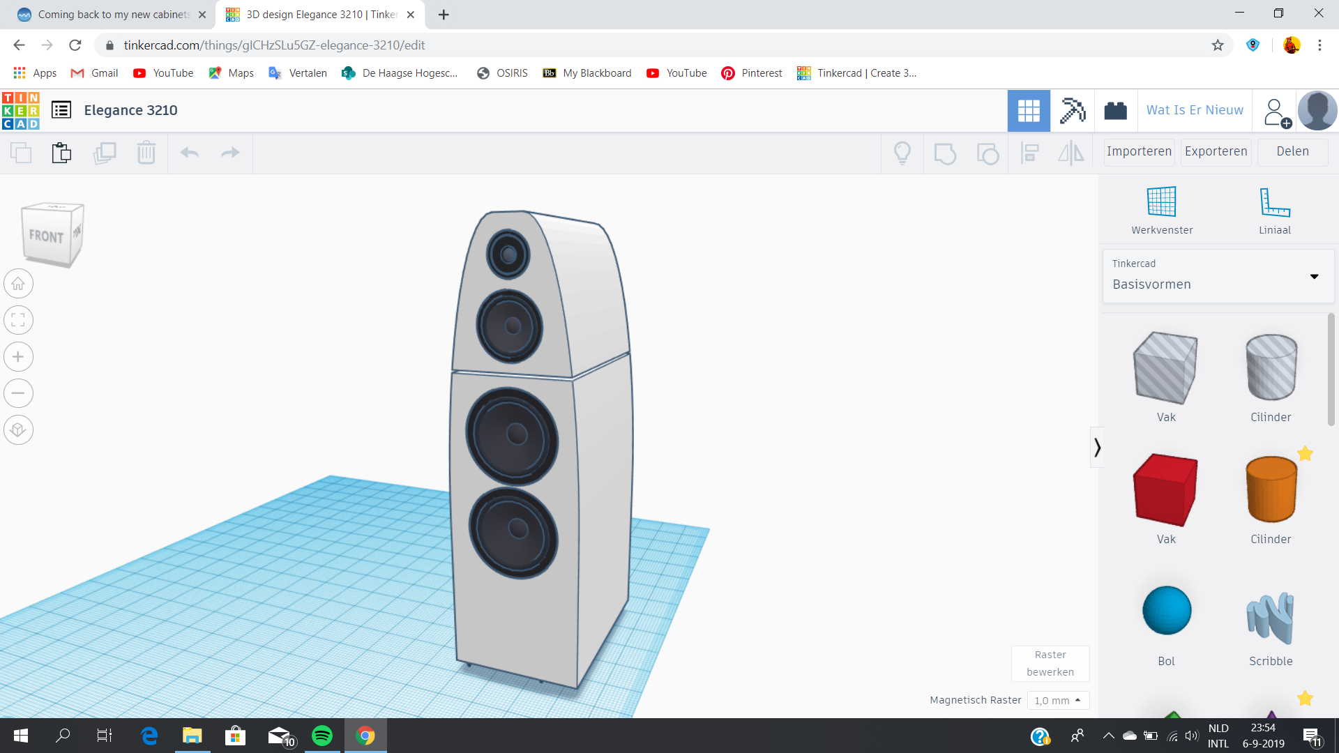

Hello,
Vacation is over and I´m back thinking about the rebuilding of my speaker cabinets.
The previous concept was shaped round for very minimal difraction and internal standing waves and it would have been very strong because of the very thick walls and extensive bracing. Though it wasn´t prettiest and it won´t necessarily be hard to build but it was quite complicated and involved tonnes of (different) parts.
So now my new idea is inpired mainly by the Meridian DSP8000 and Marten Coltrane 3 and Tenor 2. A lot more elegant though my implementation would still offer more than enough volume and the midrange and tweeter will still be decoupled from the woofers. It doesn't have the round shape like that of the previous concept but I will make the edges slated by decent dimensions and I will likely line the baffle in felt to minimize baffle interference like Wilson Audio and Rockport Technologies do.
So that's the exterior pretty much out of the way. Now about making the cabinet rigid. I could make my life easy and just make the walls two inches thick but now that I'm studying industrial design I think I should something more advanced.
You've already told my about constrained layer damping and all of it's advantages before. And now seeing Sonus Faber come out with their new Olympica Nova series to use it and Rockport Technologies and Q Acoutics having already used constrained layer damping in their greatest speakers with great succes I think I should look further into it.
How should I take this on, and what materials should I use? I was thinking about making a 1 cm thick MDF inner and outer shell with a couple of cm of space in-between and fill that up with something. The inner shell will still have extensive bracing in it and the two inch thick baffle connected to it solidly. What material shoul I use to fill up the space in-between the shells. Polyurethane foam seems to be a popular choice but I don't think it will make for a particularry stiff result. What about epoxy? Fairly well damped I think, though extremely hard, rigid and strong. Working with that stuff is quite an effort but I have never done it before so I'm sure I can do it.
Let me know what you think and hive some suggestions for the construction

Sorbothane and lead lining speakers from Osborn and Whatmough speakers sound very transparent ,both options worth considering
Hi 3wayaddict!
Constrained layer damping... yes, nice technical choice, not so easy to apply in real life!
Your idea of 2 layers with a couple centimeters space filled by some materials doesn't really belong to cld. This is more decoupling than CLD.
These could work fine however.
For CLD usually the inner part is thin in thickness not in the centimeter range.
Check this, very interesting ( message #108):
constrained layer damping with MDF and Ply

...and here is what Earl Geddes told from his experience ( one page back the previous link i gave).
https://www.diyaudio.com/forums/mul...ned-layer-damping-mdf-ply-10.html#post5847929
Well if you want to go CLD, here is a track you can follow:
Sony hold a patent about CLD where they used a multilayer Mdf/isodamp/Mdf.
In the patent ( i have acopy somewhere i can't find right now) there is two kind of 'sandwich' one for sub 100hz and another for 100hz and up cabinet design.
The sub 100hz is 2x 3/4 " each layer mdf and not so thin isodamp mat in between iirc. The 100hz and up is 1x3/4" mdf layer.
Isodamp is material from E-A-R company ( now owned by 3M). Not easy to source and not cheap at all.
Michael Percy offer some small size mat to buy.
E. Geddes once told in his own products he used melamine glue for the inner layer. Yes glue as a layer ( very thin).

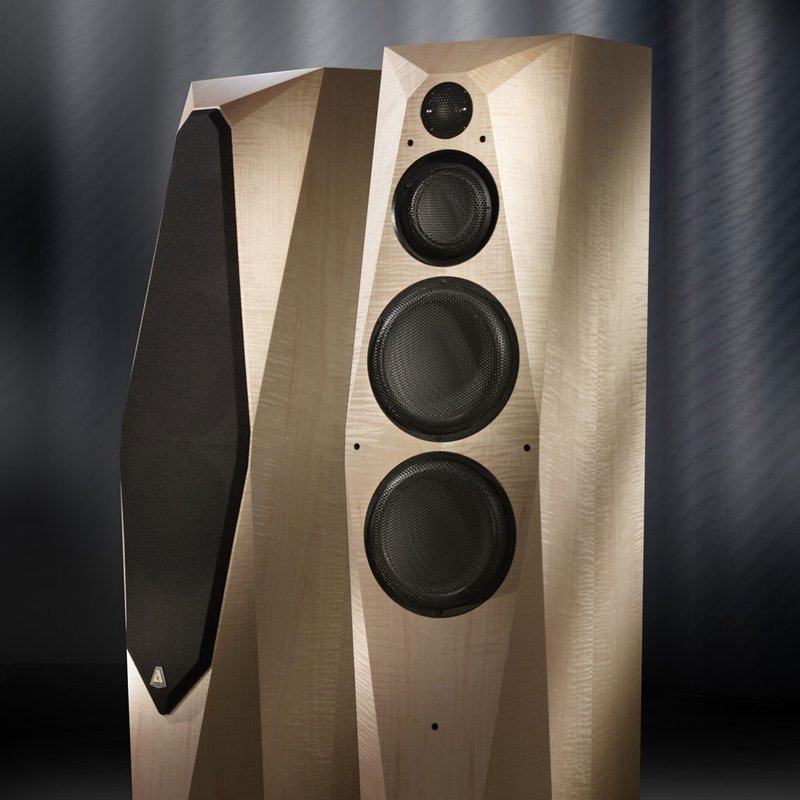

I would probably spend my money on 22mm Baltic Birch plywood, and my design engineering on 3D bracing plus a low diffraction baffle (bevels or rounds)
I like the Avalon Compas beveled pyramid edge cuts around the TM top.
It is easier to use deep bevels to taper a low diffraction TM baffle top like the Avalon Compas, than to bend and glue several thin layers like the the Coltrane 3.

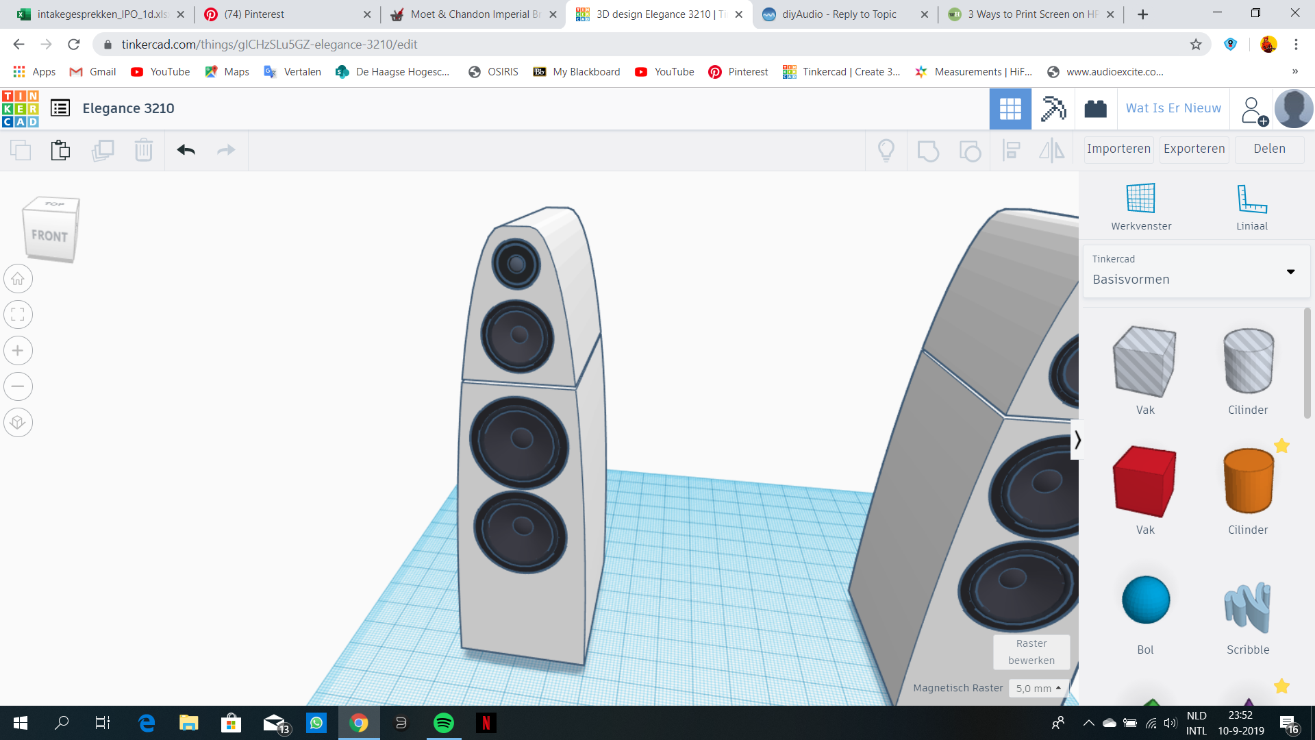

I slimmed the cabinets down as much as possible. There's anly 1" around the tweeter to the edge, which will be slanted. The curve of the sides now starts all the way at the bottom, the entire sides are curved instead of starting the curve 40 cm from the bottom. This also helps preventing standing waves in the bass cabinet more. These cabinets are really slim around the tweeter and midrange right now, I'm sure this is gonna give great imaging and a very open and airy soundstage like that of those Sabrina's. I think it looks very good as well.
perhaps you could make that shape with 2 or 3 layers of 6mm 'bendy' ply? Might need a join or kerf cuts at the top though... anyone tried it?
