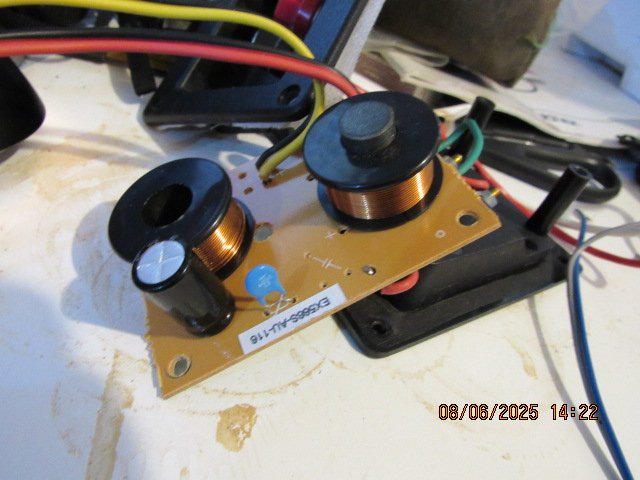

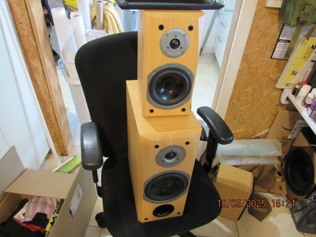

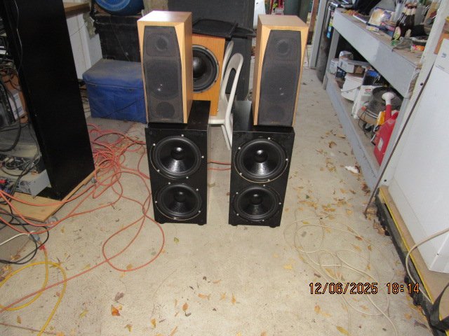

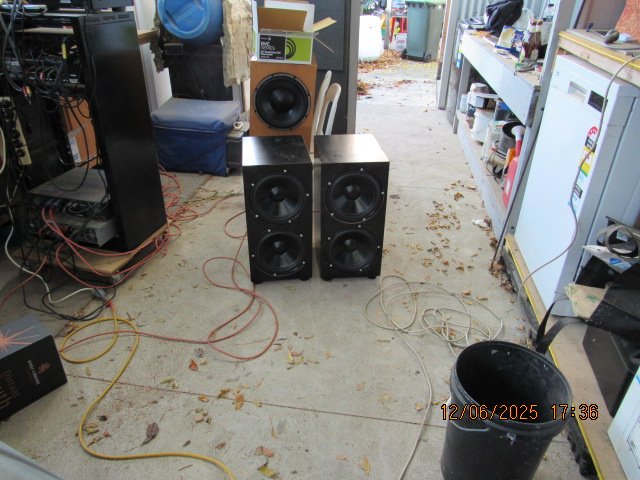

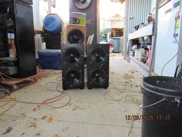

Last month I bought an empty box and couple of old school Sansui speakers.
One set of the Sansui use a 140mm midwoofer and a 20mm tweeter and are an OK little speaker
The bigger box uses a 155mm and a 25mm tweeter; the bigger box is actually a pretty good speaker; but both use the same generic crossover with the only difference being the padding on the tweeters.

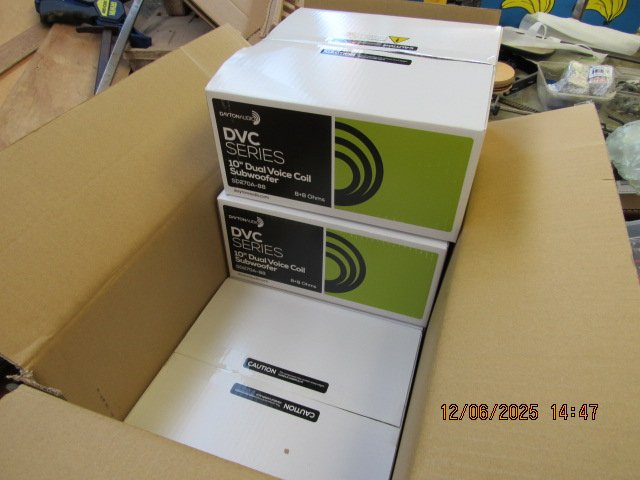

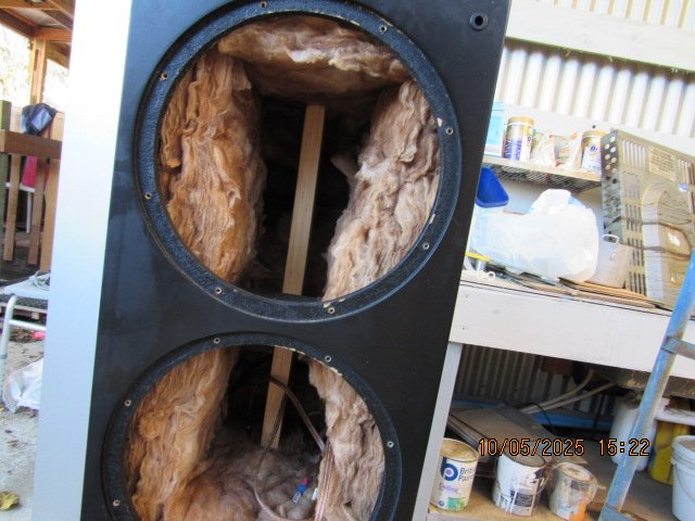

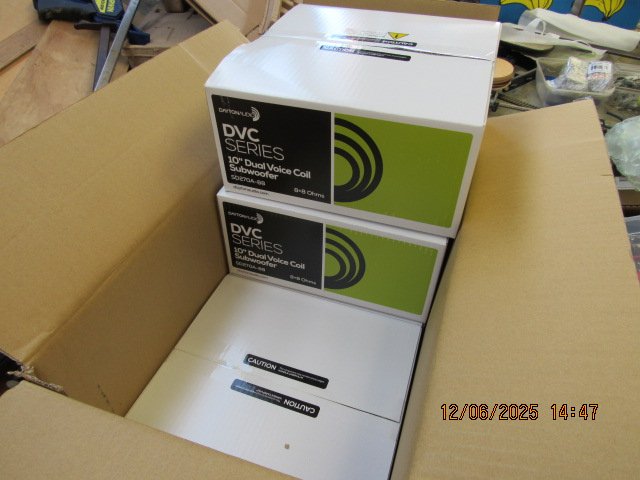

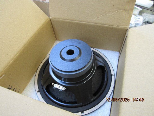

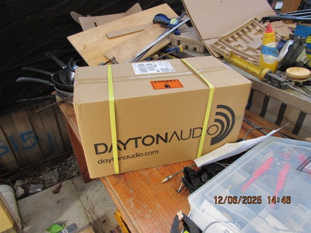

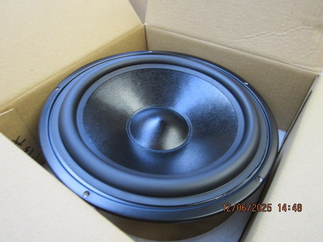

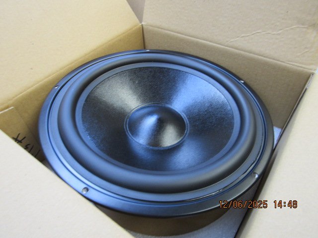

The woofer box suits a pair of 10" drivers and I've settled on a quad of the affordable Dayton drivers discussed in this thread
I think I'd like to use the Bagby crossover design as my inspiration but I can't really justify to the Boss the cost of a 150uF film capacitor at this time but given the spec of the cheap Dayton woofers I can't see them being used above 200 either.
Both the Sansui are a nominal 8R and at 200Hz are both probably at the DCR of 5.6 Ohms
So do I wait until I can afford $400- in parts or fudge it with electrolytics
200Hz is well below baffle step but I don't think that matters here and yes these could be Bi-Amped but passive can have the advantage of being able to be gifted away or sold at need
I don't have enough film caps in the stash to make up a 150uF bundle twice and I need to get 4 new film caps in 3.3uF to mod the Sansui XO as well
What is my best value supplier for film caps here at the moment if I don't use SpeakerBug??
Any further discussion of this box and the drivers will take place in the multiway forum.
They won't give me any better bass in the HT set-up than my current users but as a base for bass in a two box system I think they will work fine

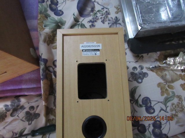

I've always enjoyed the process of modifying speakers more than building from scratch, so I now have two projects on the go. One to use the Woofer box in the above picture to use with the bigger Sansui box and a second project using the smaller Sansui box and the RadioShack Nova8 box I got a while back for $50-.
Rather than try and fit better midrange and tweeters to the Nova box I can just block off the holes and use a cheap version of the "Universal XO" between them.
I'll not use high price parts for the smaller box, near enough good enough for the first trial so a trip to the local Jaycar in the next couple of days.

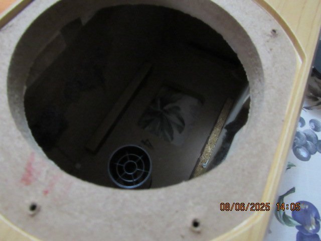

Taking the drivers from the small box and doing a tap test I get a "Twang" rather than a dead "Tock" so a few scraps of something will get glued into the boxes and all the usual additions of fibrefill etc

So, do I understand you correctly in interpreting that you'd like to use a design with a woofer and crossover from one "model", and use it with the other one's tweeter? Or are you trying to use two different existing speaker sets with each different woofers in the same cabinet and airspace? Or still different, two different pairs of speakers with different drivers, stuffed together into a single box per side, dropping one of the two tweeters that results from the mashup/combo?
I'll be honest, I'm having a hard time reading your post. Take a minute to split the text up into sections of things relevant to each other, if you can?
