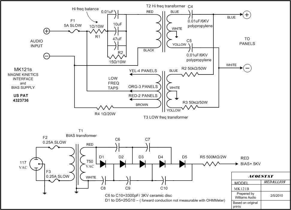

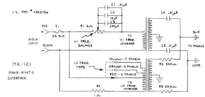

It was always Acoustat's recommendation (as well as my personal advice) not to parallel two interfaces on one amplifier channel. The impedance of one interface can dip below 2-ohms, so paralleling two interfaces will yield an amplifier load of less than 1-ohm. That's bad news for most if not all amplifiers.
An even worse idea is to series-connect two interfaces. Each speaker will be presented with only half the voltage swing from the amplifier, greatly reducing the acoustic output. You will also ruin any damping factor that your amplfier provides.
So, my recommendation is that you need four channels of amplification...there's just no way around the problem. Even Acoustat's legendary Models 6 and 8, which used two interfaces per speaker, were intended to be driven by four independent channels.

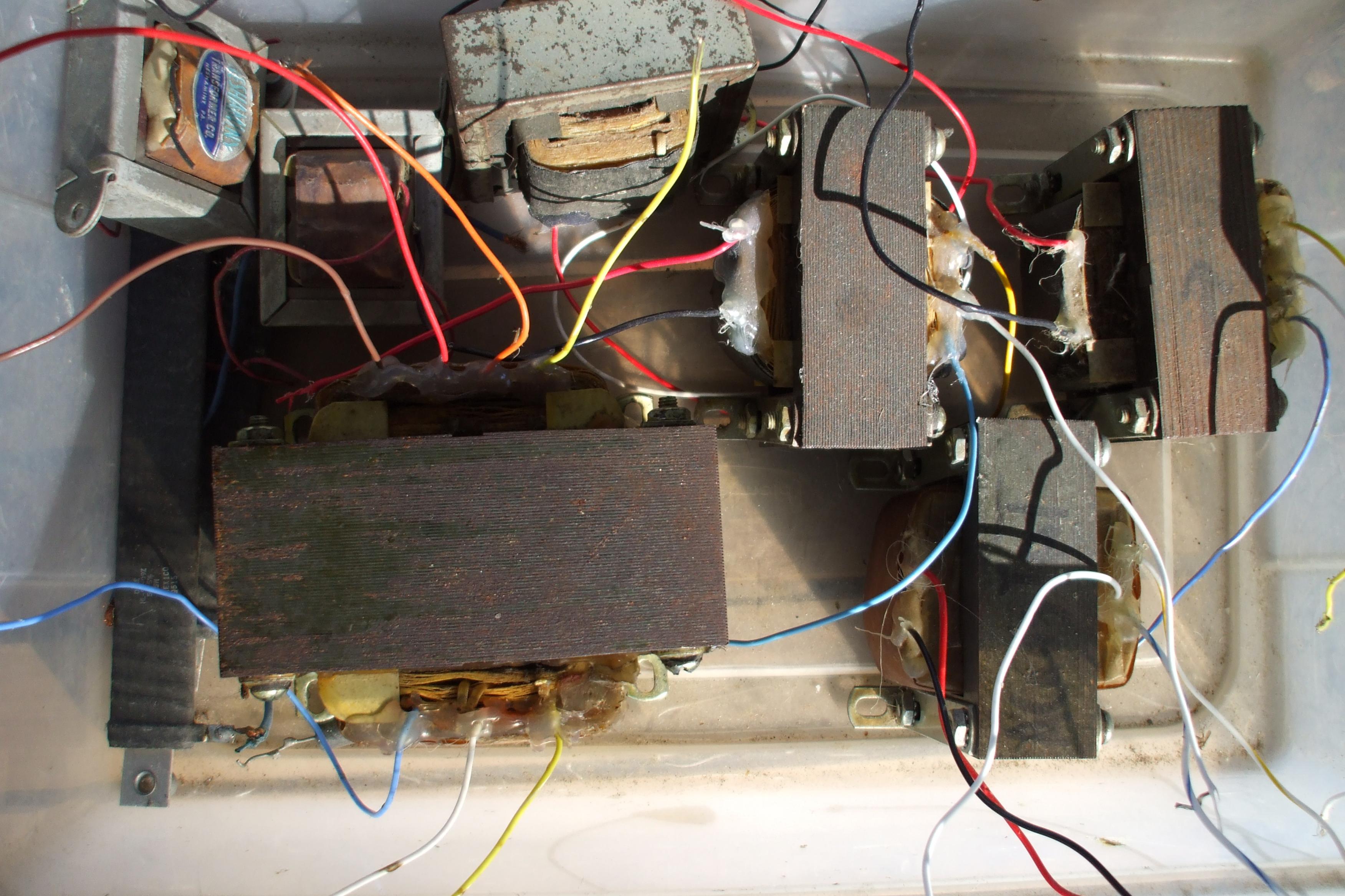

Hey buddy: I never did notice what you described happening or was not aware of it. In all my Acoustats I placed copper or aluminum foil shields around the transformer windings which I grounded. Good observation on your part, thanks for posting that Allan. Best regards Moray James.

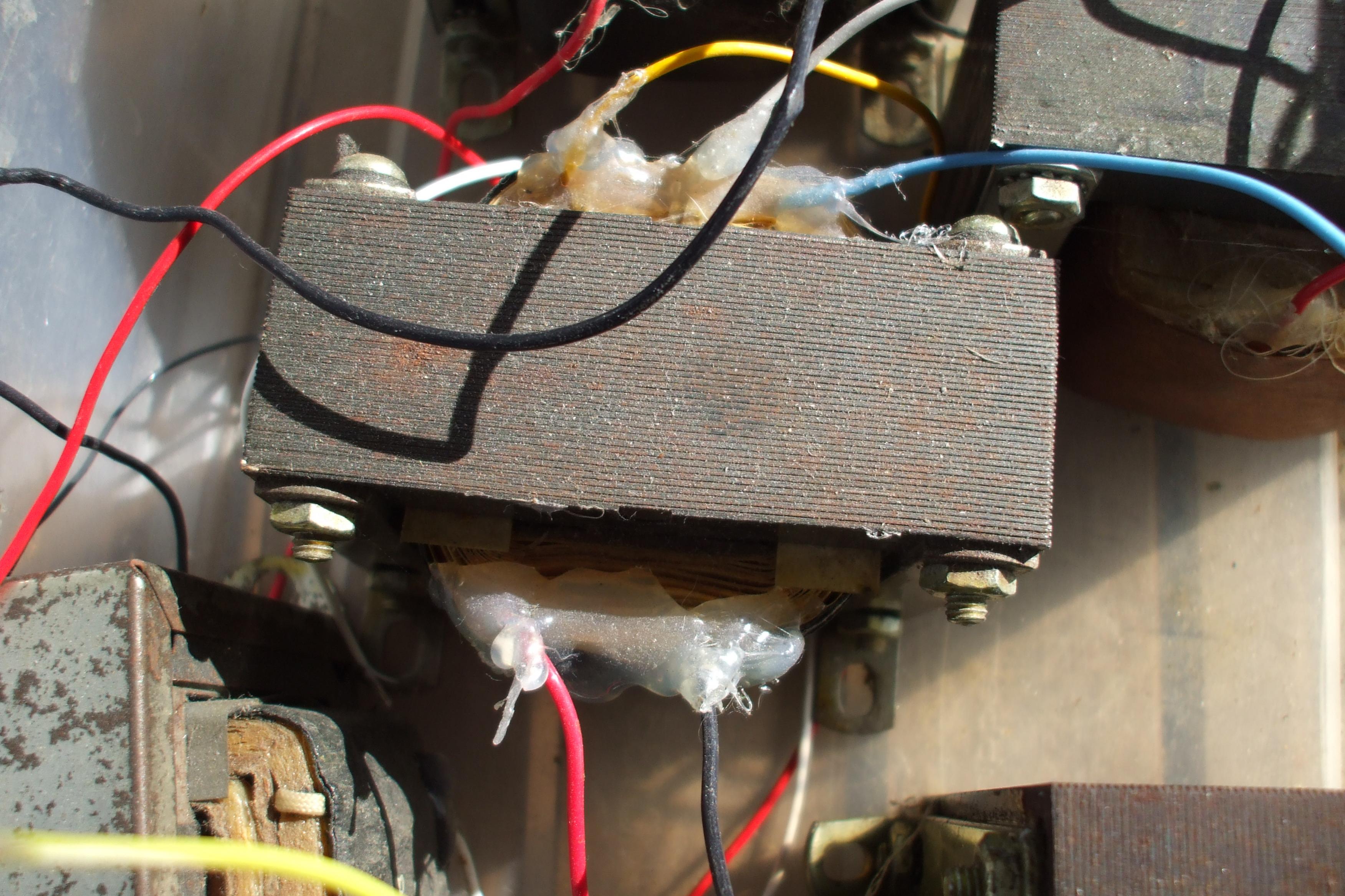

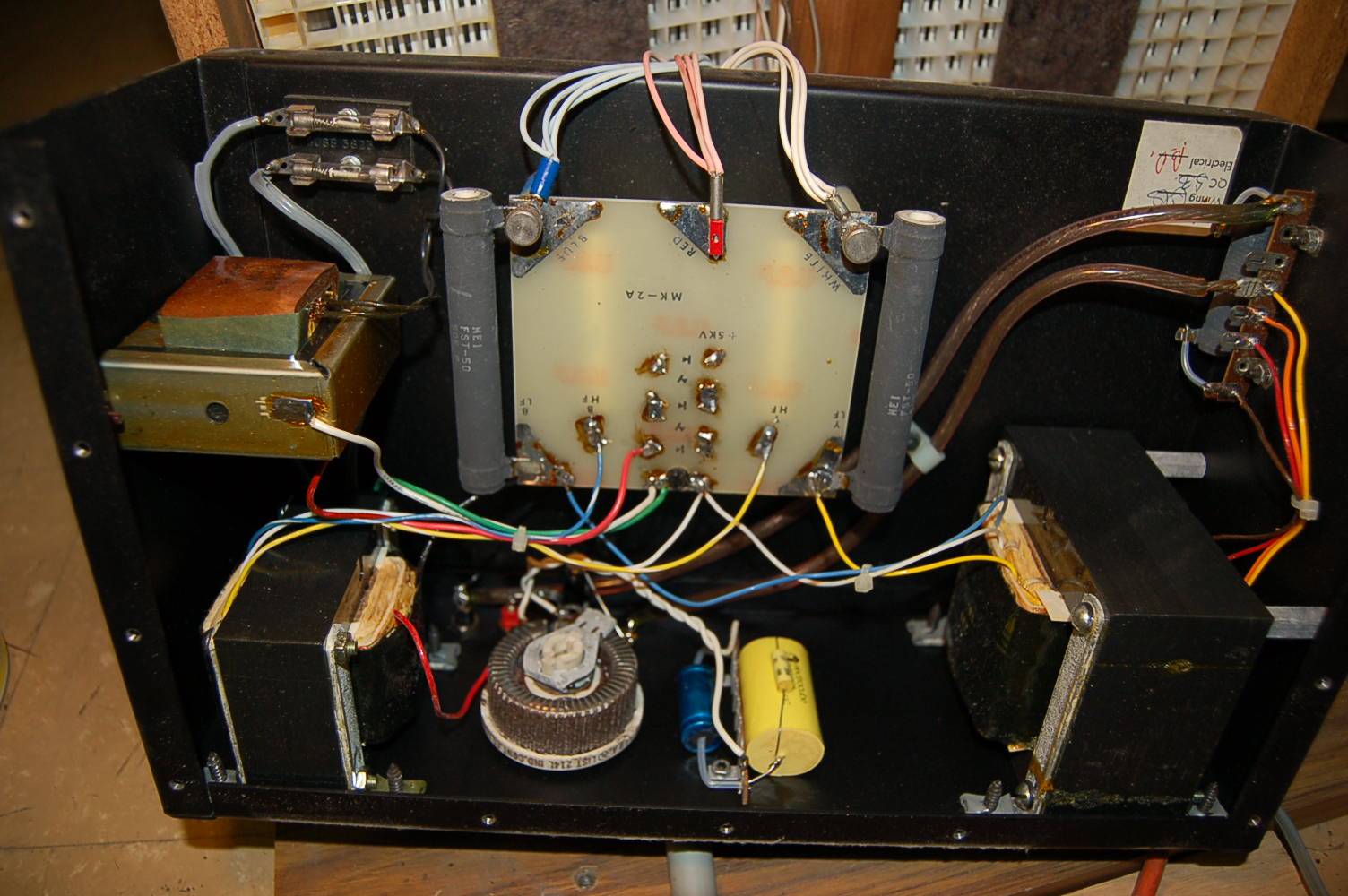

What i have found on the 121 Acoustats interfaces....
1.If you are going to move the wires or tranfourmers around... primary or secdary like just pull a tranfourmers you better put hot glue on the wires at paper on the tranfourmers... the wires can move around an can come lose... the wire is stiff an the paper is vary dry...you can kill a tranfourmer...you can see in the pic...the extra Acoustat tranfourmers...have all been hot glued.
If you put hot glue at the paper were the wires come out this stop any movemint..an can stop arking also right at the transfourmer...
2.On the bass an high frc tranfourmer... secdary side all the wires ...can have pin holes in them...an arck all around in the interfaces...an pull the output down.. a lot but not these wires have what was clear tubing this can pull down HV all so.. thay can get wet in side..30years bild up...put new tubing
3. The 50k100 w res. on the miXer board can. have crakes in them ....An ark an pull down output..you can see these crakes some times
4. The Caps on the mixer board 0.1 5k.....when the bias gets pulled down
can get holes in them an ark an pull down output..After all these pars are Over 30years old....
5. An yes the bias.. all the parts need to be upgreaded to new parts..
an if you wont to get the most out of the Acoustats outboard the bias.. it being just 1" away from the driver tranfourmer on the mixer board...at best now all these years later were only geting 80% of what these ESL can do....An seting up the bias so you can set it...4-7k you well get the best out of Acoustat panels have even after 30years...Get right up there with SoundLabs. an other over 10k ESLs..good luck..
I got my frist pr of Acoustats in 1986...Xs with the Servo tube amps....i call jim strickland ...i was freak out.. i told him i had got a pr of the Xs an that if i sat in the dark an drove the Xs hard... the wires in the panels gloed to the beet of the sound... he said that that was nom...so dont think there is not a lot of High V going on here...after time any thing will brack down...but the Acousrtas are still trucking..
Hohoho too all...have a good one
good luck
Allan: I use mostly copper foil and I simply wrap the transformer all the way around the transformer and leave an overlap then I solder at the seam. I solder tag a length of stranded insulated wire and I run that to ground. I hope this is clear enough and makes sense. Best regards Moray James.
