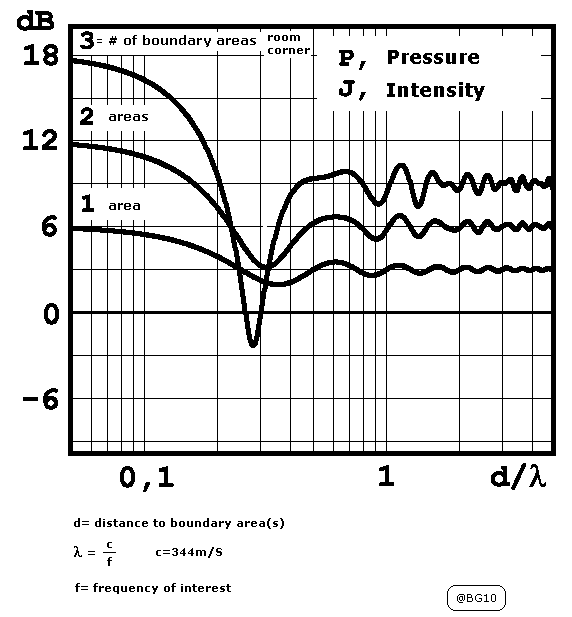

rhapsodee,
:2c:To add LF boundary impact on multiple driver speakers:
Use this calculator that handles 2 drivers at a time: See Room Response Calculator v0.6d link here below but it's easy to estimate/calculate the boundary gain for any numbers of drivers by using this graph: See the picture:
http://www.rsu.edu.ru/~foboss/hi-fi/acoustic/room060d.xls
b🙂

rhapsodee,
b🙂
An interesting observation is that the 0 line is equal to true free-field.
