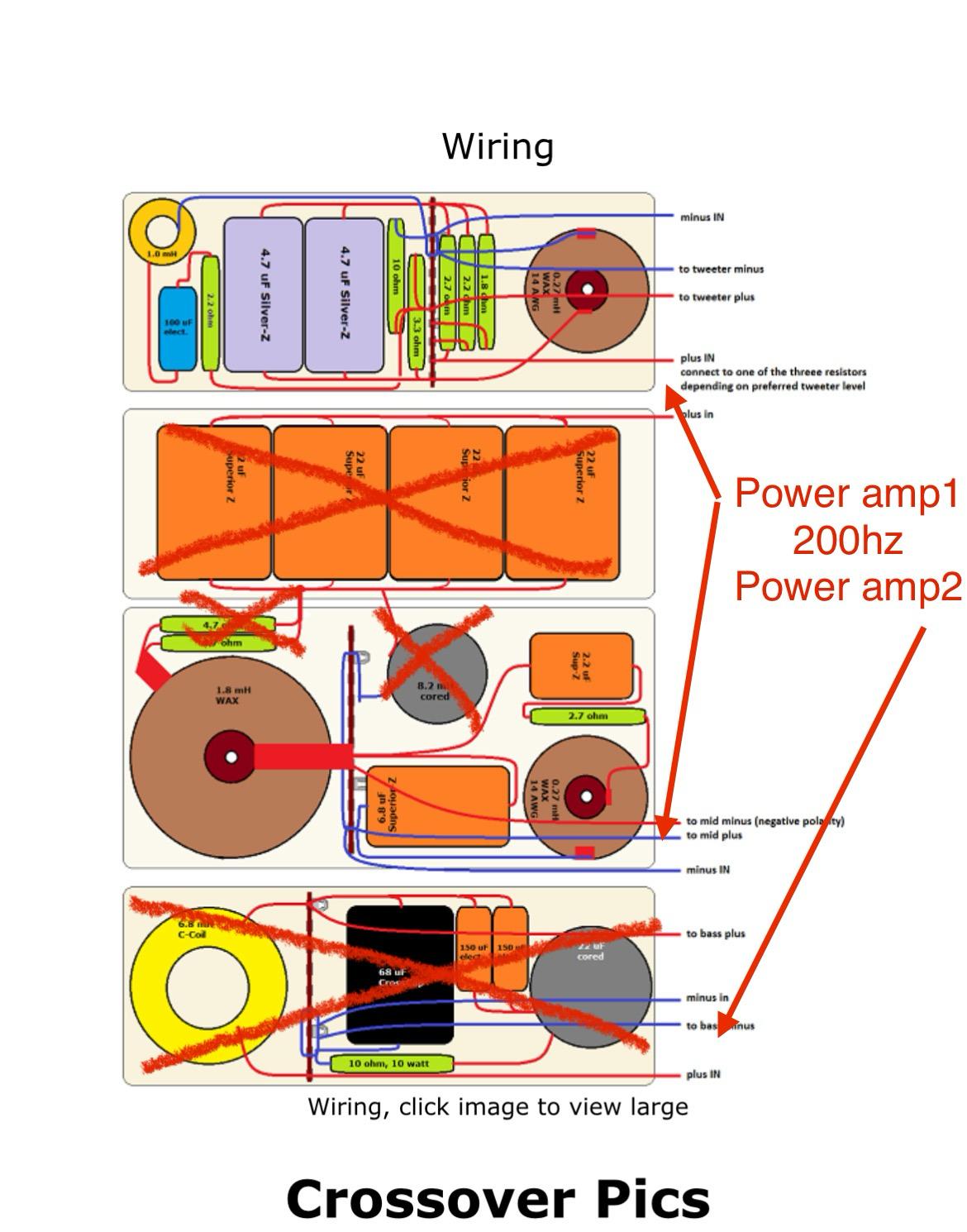

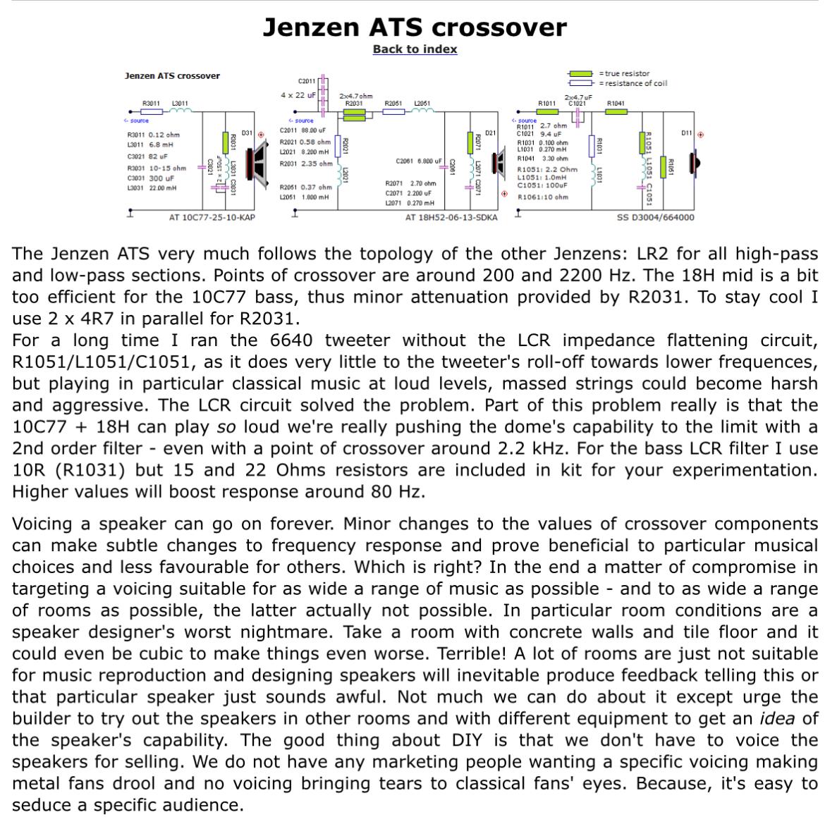

Hello, I am asking for help here regarding my loudspeakers, the Troels G. Jentzen ATS.
I am currently using a Hypex module for the woofer that allows me to filter active (at the same frequency and same order) in the wofer (low pass at 200hz LR second order) and, in this way, eliminate the passive filter of the wofer.

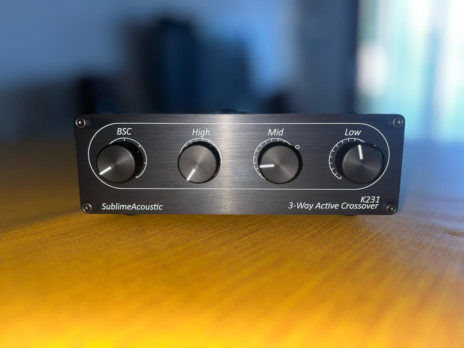

My intention now is to use a SublimeAcoustic K231 active crossover so that the midrange and treble amplification only works from 200Hz upwards.
Before putting the crossover into operation I am reviewing instructions. Initially, my intention is to use it in 2-way mode with the cutoff at 200hz 12db. And here I have a question to resolve. The low pass will go directly to the woofer but the high pass will go to the passive mid and treble filter. In passive mode the mids reverses the phase. My intention is to eliminate the passive high-pass filter from the mids and keep the passive low-pass filter. So how will this affect the phase? In this way can I keep bass and treble in phase and reverse phase in mids? I attach photos to explain what I am exposing.
BR
Toni
