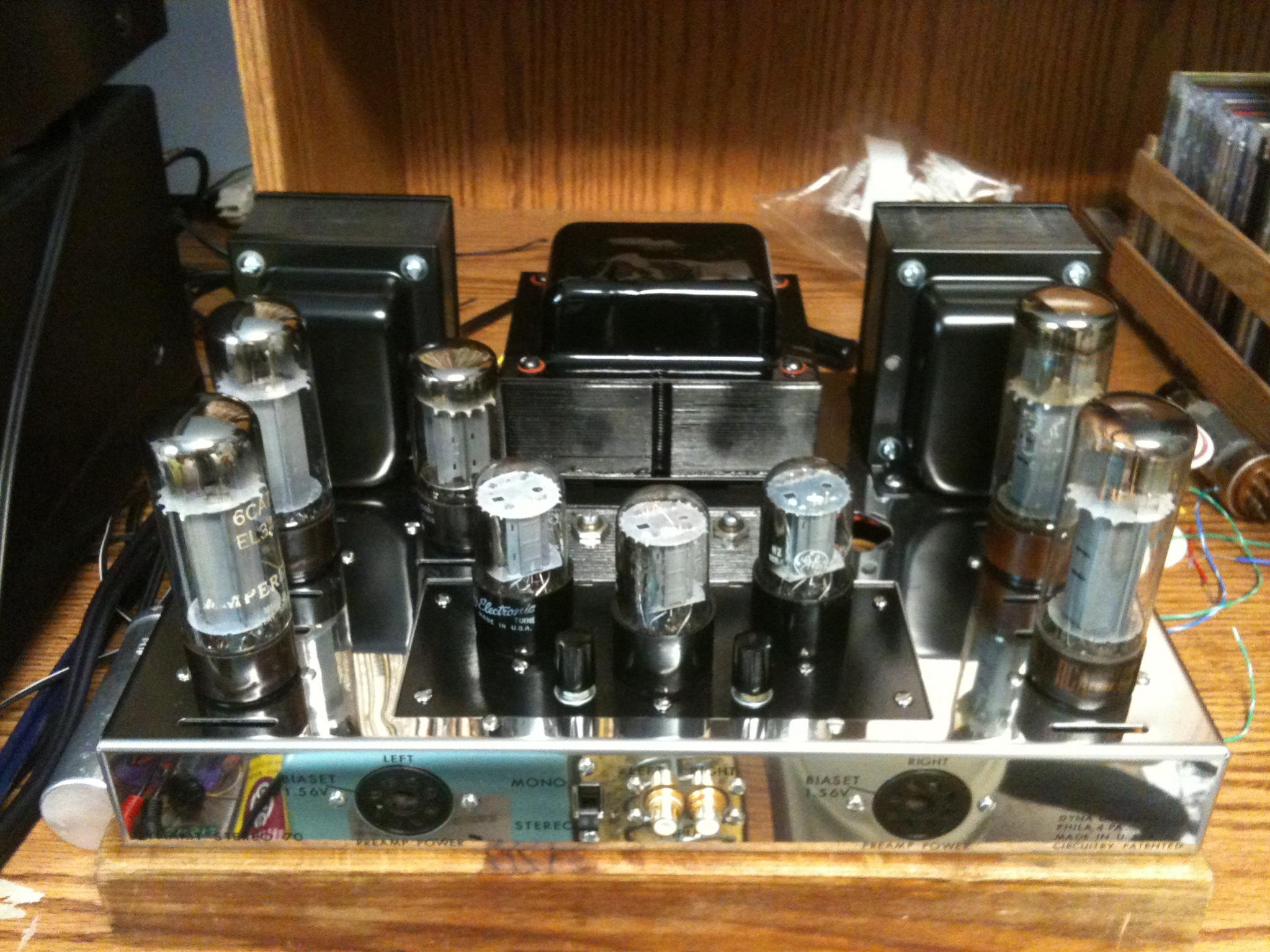

I have some pictures of my ST-70, which might help explain the challenge of installing another pot. My ST-70 has a driver board that I made (the circuit is a 6SN7 x3 Blackburn Audio driver) with two extra pots on it. I refuse to drill in my new chassis. Period. Any modifications will be done with existing holes on the chassis or modifying my driver board. Heck, I might even make a whole new driver board and install good pots on it this time.
They preferably need to be 1/8W pots (like I have in there right now). Can I get 1/8W pots that have a screwdriver adjust that mount by means of a nut? The lockdown part is optional, I suppose. I figure most people won't be touching something with a screwdriver adjust anyways, especially if it's right next to a hot 6SN7! In truth, the more flush it is with the chassis, the better. Any suggestions?

Possibly try cutting shafts almost flush and slotting with dremel tool etc, and making a bracket to mount pots below holes so you can stick a screw driver in hole. Have them mounted so cut off shaft ends are almost flush with metal plate. Just enough below so you can't use a finger nail etc. This way hole edge will make it easy for your screwdriver. Attach pots bracket to base plate and have screws on bottom to easily detach from base plate.

I would check either the Mouser catalog or Digi-Key; you should be able to find screwdriver-style controls, even locking ones, probably 1/4 watt. If you want this to really work right, I would avoid any additional complexity; barring that get a bigger chassis so you have room to lay things out right.
