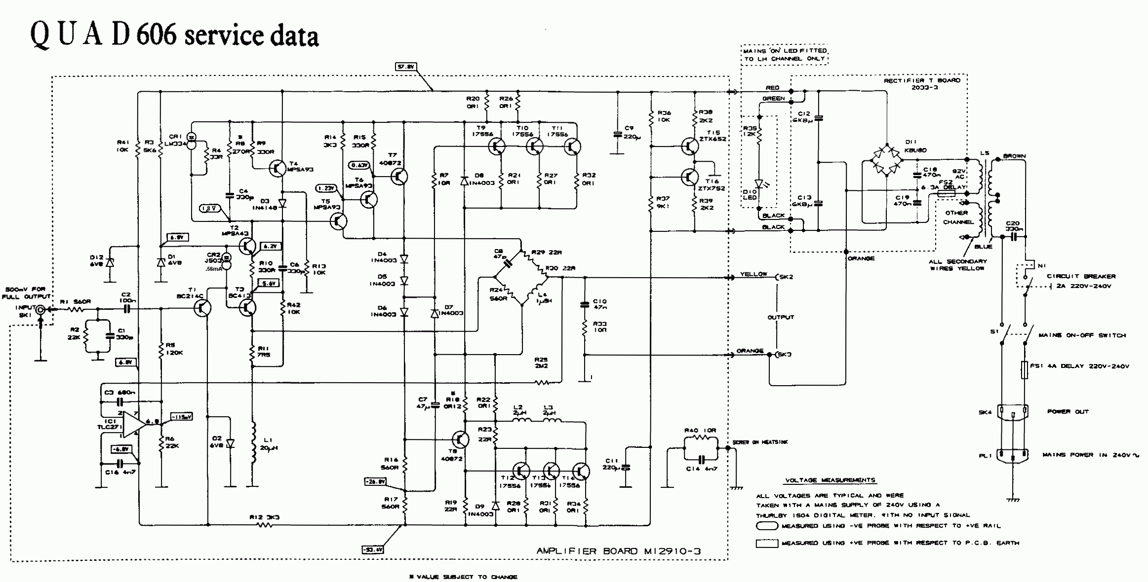

Until now, it is still a challenge, to create a solid state power amplifier with <100 mA quiescence current through the power output devices and sound quality like pure class A at the same time.
Unfortunately I haven't heard such an amplifier until this day.

1) P.J. Walker Current Dumping Audio Amplifier"
http://220.232.128.43/audio/quad405/Current Dumping Audio Amplifier - PJ Walker.pdf
http://www.diyaudio.com/forums/solid-state/109771-quad-405-dcd-mod3-pcb.html

Current-dumping (feed-forward) applied to a conventional Class-B amplifier topology (a number of variants are possible):

The darlington O/P version won't qualify as Class-A sonics, but variants that use a Class-AB Self Type-II EF output stage along with current-dumping get close to Class-A sonics.
Also, it is possible to combine current-dumping (feed-forward) with the Visch Class-B topology, which should yield sonics which are comparable to high-end Class-A.

For me follow topologies seems to be closest to pure class-A (have a look also to the attached PDF):
http://www.diyaudio.com/forums/solid-state/23590-audiotek-69-technics-se-a1.html

I own (and use daily in my main system) a Technics SE-A5 wich uses the "New class A SynchroBias" circuit. I use it with horn speakers, 104dB, and I can confirm this is an amp that sounds clean and full even at very very low power (0,01watt in most of my evening listenings). Is it a result of the New class A circuit or other factors I cannot tell, but it sure sounds good. A lot of big SS amp i've tried so far were quite "grainy" and "dirty" when driving the same speakers.
Are there any new commercial products (except Class-D) that match the sound character of class a (at least nearly) ??

It is adjustment-free, requires no thermal compensation, has no feeedback, no servo, can even work with fake or reject transistors, and yet offers low DC offset and sub-ppm linearity:
ClassAB with bootstrap will have 10kHz sounds better than 6kHz. In high quality classA, 6kHz beautifully beat 10kHz and everything sounds beauty and real. I found it when play with damper characteristics.
ClassA drop characteristics has major cause. When classA using huge feedback to achieve lowest distortion, that drop characteristics is gone, and it sounds like common amplifier.

Class AA, VC4, Class S (Sandman) or "true current dumping" come close, if implemented correctly.
I own a SE-A100, which is already great in it's stock form, but with a little tweaking, it beats almost every Class A amp. This kind of amplifier architecture is good for distortion harmonics lower as -120dB at 20kHz.
Another option would be V-FETs (Si-SITs, not power Junction FETs), because these typically operate at Class B at currents around 200..300mA , while Bipolars and MOSFETs achieve the optimum Class B operation around 10..100mA. They also feature a zero tempco., which means, that the Class B idle current is not dependent on thermal history.
If you ever heard a Yamaha B-I or B-2 or a Victor JM-S7, you probably know, what I mean.

This topology corresponds to the paper aboutAllow me to tease a little......
Regards
already mentioned by post #1
Unfortunately not currently available as new commercial device (or is it ?).
I have some service documentation from Quad.....those amps are almost the same....
306/520/606/707/909and I suspect also 99 mono blocks.....
