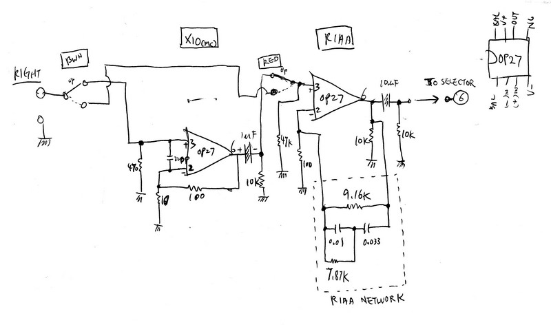

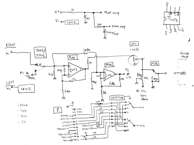

I don't know if you are still waiting for help. The Vol. can be change easily by a technician. I post the circuit see if this can help you.

Thanks for that - I'd actually found your schematic already on diyaudio! Oddly the pot in my claymore was a 20k, I've swapped it for a 10k and the control is terrible, so I'm going to order a 50k and install that.
I notice on your schematic some of the resistors are 27k, I've gone through my amp noting down the values of all the preamp resistors (as I intend to swap them out for better quality ones), but didnt find any 27k ones ( i think mine are all 47k) - have you any photos of the inside of the amp so I can see where the 27kRs are on yours?

Hi Spev, friend of here told me that I have a wrong drawing. Thank you.
Here is the corrected drawing. Resistor R17a should be 10k.
Wrong drawing to Load Resistors of Tr1a and Tr2a.
