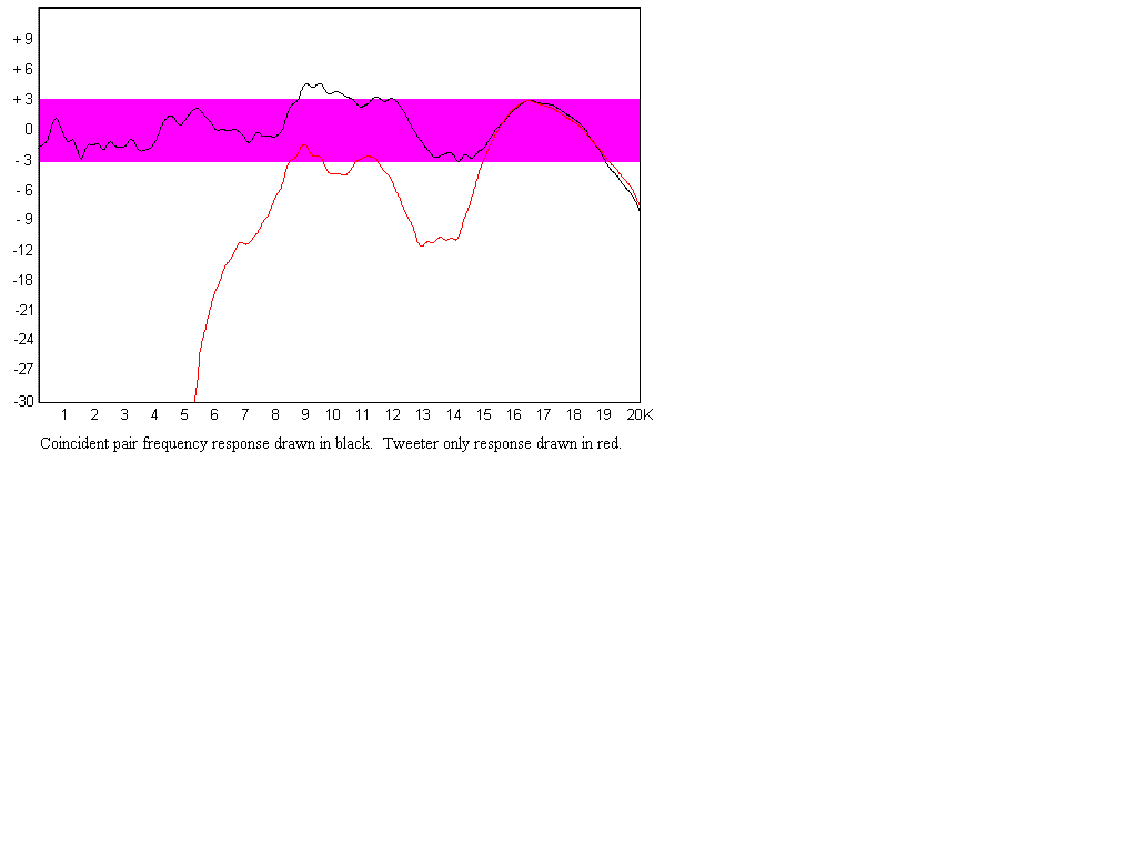

While a coincident/coaxial approach has potential, if you want to achieve coherent operation its application is quite limited. Still, when starting with a properly designed coincident driver, loudspeaker construction is simple. Just build the box, cut one driver hole, and mount the driver.
While I have not heard or measured every coincident driver ever manufactured, all that I have heard and measured have fallen short of my standards of acceptability. I can understand this. While coaxial is simple in conception, it is difficult in execution.
One of the major problems is the lack of coherence between the two drivers and the resultant interference. That, however, is a doable design challenge. Two variables must be controlled to achieve high fidelity quality performance from a coaxial driver. Those are the spatial alignment of the drivers for coherence and the boundary effects of the low frequency driver upon the high frequency driver.
The use of neodymium magnets in dome tweeters has allowed designs small enough to fit within the larger driver's voice coil. Also, properly handled, a 6.5 or eight inch driver can be pushed high enough in frequency to allow for transient coherence with the high frequency driver set in front of the top of the LF driver's pole piece.
Now, this is not just idle speculation on my part. I am very close. The attached graph shows the response of a coincident pair. For this test, the pair consists of a 5.25 polypropylene woofer and a neodymium motor, one-inch dome tweeter. They are coherent and they sum. The placement of the tweeter causes no ill effects on the performance of the cone driver. The impact of the tweeter will be even less for a 6.5 or eight inch driver. I have not, however, controlled for the tweeter boundary effects.
The combined response is drawn in black, the tweeter only response is drawn in red. While the pair does sum, the response above 8 kHz is too rough and that roughness is all due to tweeter boundary effects. Control for the tweeter boundary effects and use a tweeter with a little bit better top end extension, and this will be a nice option.
Good designing and good building,
Mark

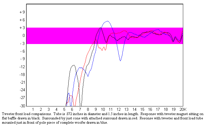

Anyway, I logged on to post an update on some design work. I have determined the critical diameter (at the dome) for the front load appliance. It is .872 inches. This is applicable only for the driver I am using. Other drivers will require different dimensions.
I have also been working with a load appliance with a 1.5 inch length. This places the high frequency release point proud of the woofer and its surround. I have mocked up just the cone and surround with the tweeter to cone relationship identical as in the actual woofer. Yet when mounted identically in the actual driver it measures differently. There is an unidentified variable in play. Must find that variable.
Lastly for today, I am not trying to go low with the tweeter. Rather, by using Whisper Cone TM drivers, I am going for 10 kHz from the woofer. While the final design may drift a few K around this point, all muscial tones will be reproduced by the woofer.
If you are going for a 2 kHz crossover point then the delay caused by the low pass filter will dictate an alignment point well behind the woofer. This is also a problem with none time aligned spaced two-ways. Makes them sound unnatural.
Mark
P.S. I will not call these things (whatever they are) wave guides.
