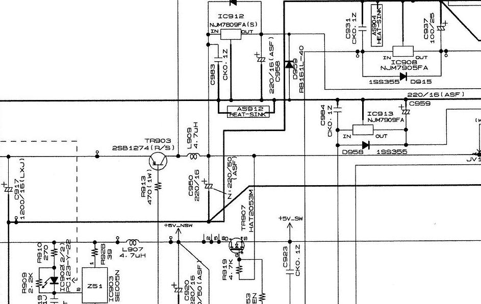

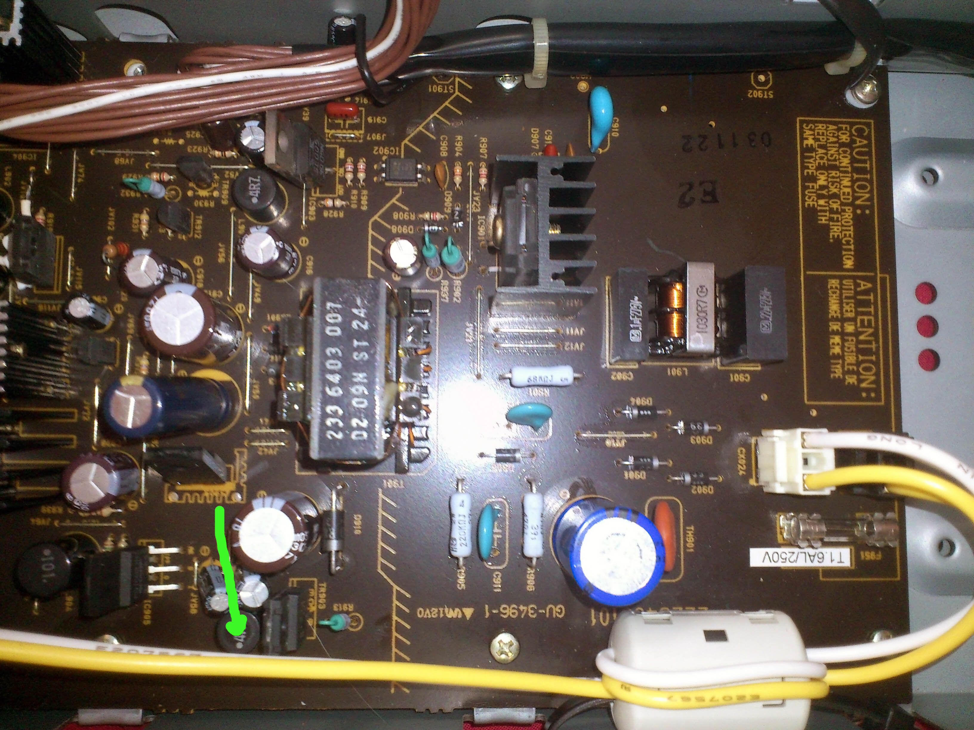

I need help on the part chosen for the SMPS mode of Danon 2900
One of the components I replaced this coil L909
Its value 4.7UH
His model is LHL08TB4R7M
Inductance- 4.7UH
Current Rating-3A
DC Resistance- 0.025
Frequency - Self Resonan- 30MHZ
Q @ Freq - 40 @ 7.96MHz

Can I use a coil that I bought
I worry only because the current value ?

From the small bit of the circuit that you have shown, it appears to be too low a current. The voltage there is DC so the coil is only there to reduce HF noise. Be careful of its DC resistance though as there could be up to 3A flowing, 1A each through the 3 x regulators that can be seen.
Personally I would get a coil that can handle at least 3A, not 0.9A, as the regulators have heatsinks they might be passing more than 0.9A in total.

There could be up to 3A flowing, but most likely not. You can always measure the current flowing. If it's under, say, 500mA, go for it. Or you can play it safe and get an inductor with a higher current rating. (My personal choice.) The inductance value would not be critical.
My problem is to find coil 330UH
That the diameter is not too large
( In the Area I replaced the coil dnot have much room )
3 amps I've seen in FARRNEL
Starting diameter 25 mm
I have a reason I replaced the coilIt's probably not doing much anyway, try a shorting link in place of the inductor.

True, but you can't find a coil to fit.
You could try an axial coil and mount it vertically.
I might have a solution
Buy Coil 330UH 4.5A

Why do you need 330uH? The schematic shows 4.7uH.My problem is to find coil 330UH
To have better noise filtering to audio circuit regulators

It'll never make a difference... Especially when you increase the parasitic capacitance and allow more noise...To have better noise filtering to audio circuit regulators
Yep, LC filters have to be designed bearing in mind that the L (in particular) is not anything like an ideal component, just making it bigger while lowering the SRF is not likely to have the desired effect.
Spice is your friend for investigating this sort of thing, doing it on paper when you include all the parasitics is an excersize in linear algebra not for the faint hearted.
