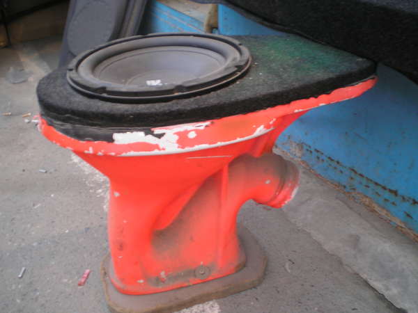

Plumbing supplies?
Picasa Web Albums - Richard - Class Work
Cheers
Doug
Here you go:
(No, no! It is not mine, and I don't know how it sounds!) 😀
SERIOUSLY!!!!
looks like it would be messy😱
LOL...BSC would be a bitch...
