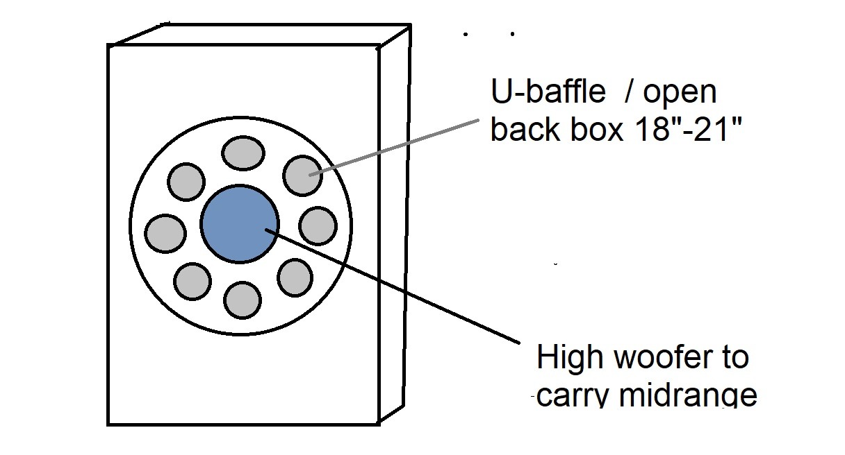

it could look cool - say on the cheap side a Goldwood GW1858 18" plus some small woofer which could fit in front of the 18" speaker

A point source driver's BW is from Fs - VC diameter's frequency, so if a 3" dia. VC, then ~13543/pi/3 = ~1437 Hz. Above this point it has TL modes (the flexing you see in slow motion video where the same frequency can be emanating at different locations on the diaphragm) with the dustcap filling out the extreme HF beginning around ~13543/3 = ~4514 Hz for 3".
Swag the dustcap for a second driver and this 'coax' still has the same VC cutoff.
