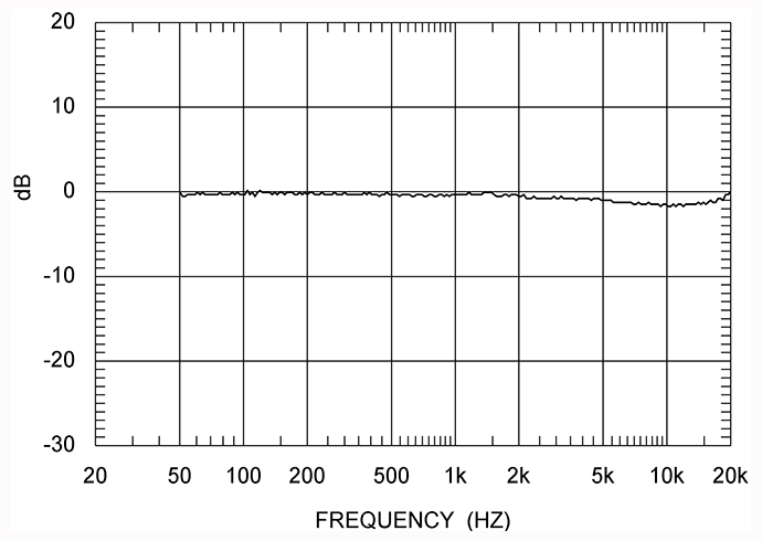

2) In the Q100 example, I wonder why the impact is pronounced only between 6kHz-9kHz ( and then again above 15kHz) ?
Thanks !
This is a diffraction effect based on the diameter of the diffraction "ring" around the tweeter. The fact that it is a "ring" exaggerates the effect due to all the edge sources of the diffraction "concentrating" on the 0 degree axis. It won't be the same as you move off-axis.
Though not shown, it is an effect that is not only relative to the degree of offset (either inward or outward), but ALSO the playback level. (..twice-over when you consider that amount of diffraction is also dependent on the woofer's position.)
This same problem shows up numerous times with tweeters that either either "proud" or are to far inset into the baffle as measured in Soundstage's NRC measurements under the category of "Deviation from Linearity".
