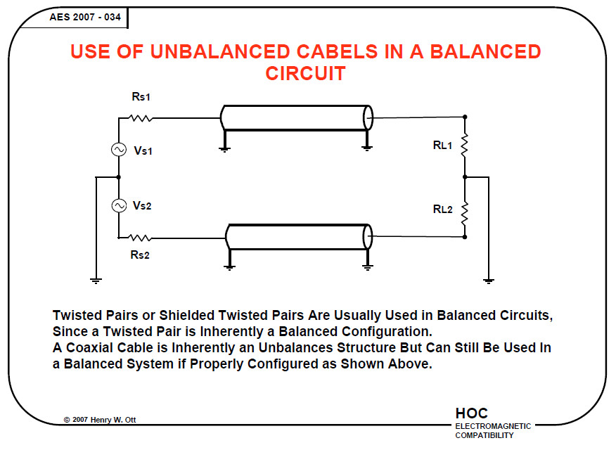

Ihave to explain better,perdone me and my bAD ENGLISH: I WANT USE ONLY THE "core-SOLID", ONE FOR GO AND ONE FOR RETURN.
tHE SHIELD IS ATTACHED ONLY ONE PART ON THE NEGATIVE POLE...
I HOPE TO BE MORE DECENT CLEAR NOW! 🙂

tHE 2 SHIELDs ARE "ATTACHED- LINKED" ONLY ONE PART ,ON THE NEGATIVE POLE. ONLY...
BY
No, its less clear now. You seem to want to use the inners of a 150 ohm coax for both signal and return, with the two shields grounded. If I understand correctly you want to make a 300ohm balanced circuit. If so, why not use 300ohm twin cable? Why not tell us what you want to do then we can advise you how best to do it.

The Henry Ott picture from:
http://www.hottconsultants.com/pdf_files/aes-2007.pdf
refers to balanced audio, for digital signals this would not work, using a twisted pair within a shield would work, using one for the signal and one for the return, though you then have the problem of terminating the shield correctly, otherwise you are prone to RF pick up or emitting.
