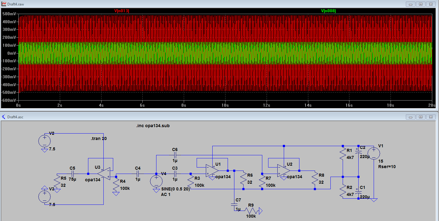

The good thing about the opa2134 in the original cmoy being that it is a jfet opamp... and the Cmoy is made ONLY for JFET opamps. You cannot use the ne5532 as a "drop-in" substitute as it is a bjt input opamp with much larger input bias currents.
You need to adapt the schematic, otherwise you will get massive dc offset and a completely unbalanced rail splitter. A quick run through spice gives me 550mV of offset. With that much offset, you're pushing a lot of current into a low impedance pair of headphones. Which means that you're unbalancing the rail splitter so much it will collapse.

No (unless I misunderstood what you mean). Here's a quick sim. On the right, there are two channels sharing a rail splitter. Worse case since they draw exactly the same current. It's at 20hz. On the left a conventionnal amp with a 75uF coupling cap and perfect supplies. 32R loads for both.
In red, the output of the cmoy. In green, the output of the 75uF coupled amp....
That's not a standard cMoy circuit though. Try the same with the usual 4k7/1k feedback network, referenced to vGnd just like the volume pot. (I'd move the ground node to vGnd and introduce a negative supply instead.) BTW, a 9V @ 45 ohm Vsource seems more realistic for a standard 9V battery.
But yes, DC offset may in fact prove a tad on the high side especially when using a run-of-the-mill TI NE5532 (Ib 500 nA typ would mean ~285 mV @ Gv = 5.7). Nothing terribly unfixable, mind you (things should be a lot more acceptable with a 22k input resistor and a 4556, even more so when going capacitor-coupled for the feedback network's ground leg), but you're right, it's not a drop-in replacement.

Oops, you're right, got abused by the simplified sim.
Two things though:
- The problem is highly dependant on feedback values. There's a good case to be made to keep gain as low as possible. With a gain of 2, the classical cmoy is more than competitive capacitance wise vs a single rail setup.
- The problem of the cmoy is highly varying depending on the loading of the two channels. If there aren't sharing the same signal, the rail splitter doesn't get as unbalanced and it's more effective than an output cap.
Btw, a 9V duracell alkaline is 2r fresh, 4r when getting old. So 15V-10R is actually pretty harsh to sim a dual battery setup.
edit: point 2 is a problem too... different signals lead to intermodulation, especially at LF.
