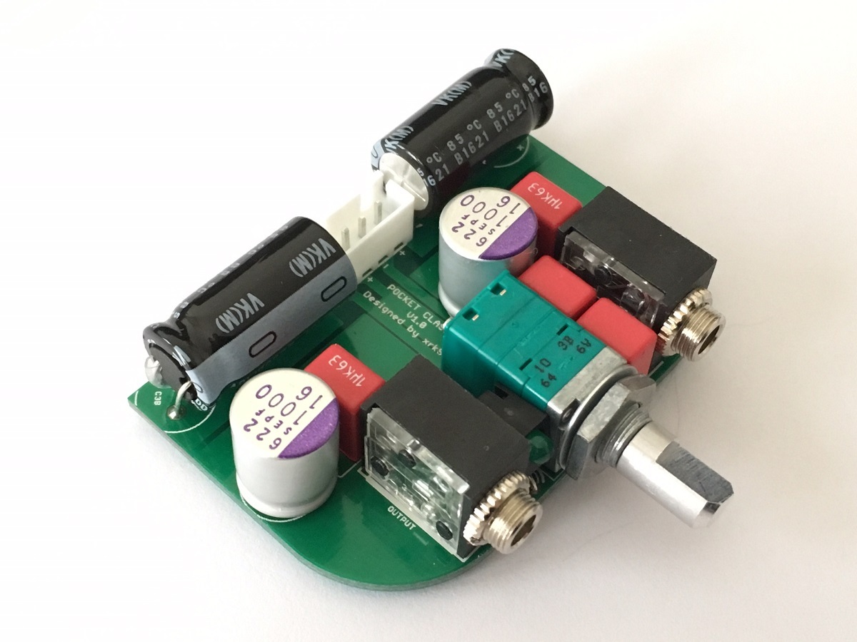

Another option for a CMOY sized mint tin is the 2-transistor SE Class A "Pocket Class A" or PCA. It sounds terrific - one of the best sounding headphone amps that I have heard.

The 'Pocket Class A Headamp GB' intrigues me but the BF862 seems a bit 'exotic'.
Suppose nearly the same quality is possible with common through-hole components and the circuit would keep its 'simplicity'. Wouldn't it get the same status as the Cmoy amplifier being build by hundreds or more?
A possible title for a new thread would be: 'the simplest headphone amplifiers using discrete components' or something like that.
There is indeed a through hole version called the DCA. The BF862 is a very nice low noise JFET originally designed for mass production use in things like FM/AM radios. It’s at EOL, so harder to find. I have new simulations for a replacement 2SK209 that’s easier to find. You can also use the “exotic” unobtainium 2SK170 - or recent LSK170. New resistor setpoints have been calculated for all 3 JFETs.

There are probably over 200 of the PCA amps out in the wild.
