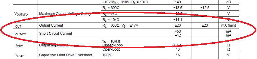

Since manufacturers don't list output current..
You bet they do! 🙂 The photo below shows what to look for in a data sheet. This particular one is for an LME49710:
http://www.ti.com/lit/gpn/lme49710
Note the conditions given though for Iout, a 600 ohm load and with +/-17Vdc power supplies.
