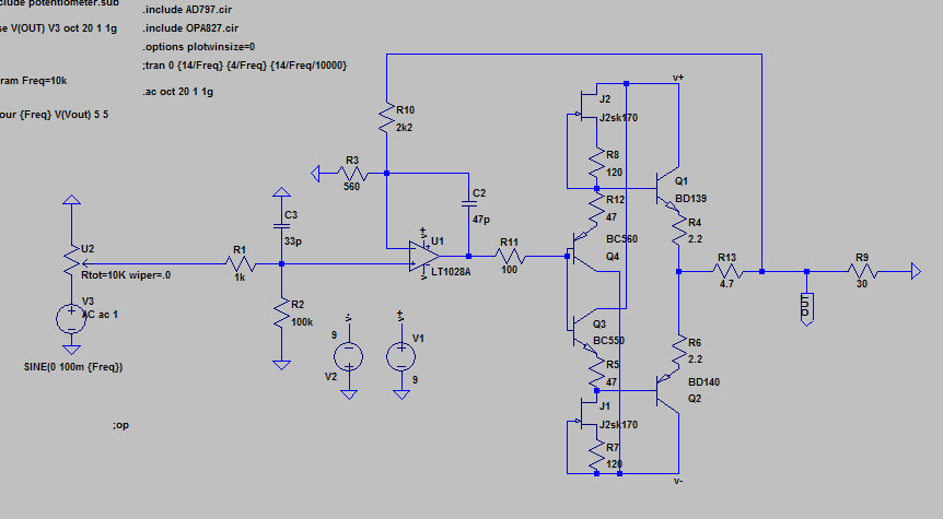

not talking CMOY here anymore but using broadly similar discrete buffer components I'd look at something like this:
Q1,3 cfp has similar current gain but lower distortion than the complemetary Darlington/"Diamond" output
Q2,4 is a feedback ccs with a twist - tapping the current sense resistor R1,2 in the middle gives push-pull Class A output, ~170mA quiescent - >300mA pk output but does give hard current limit at 2x quiescent
the LT1028 comp pin overcompensation is used with a 2-pole network to get some more of the LT1028's high open loop gain working in the global loop at audio frequencies while still cutting/compensating high frequency gain to hopeully provide robust stability with the buffer in the loop - probably should use smt C1,2 to keep parasitic inductance down
note that feedback R is too high to really take advantage of LT1028 low noise, would also have a problem with practical input volume pot values - the input current noise of the LT1028 wipes out any advantage from the 1nV voltage noise with KOhm impedance on either input
the sim shows distortion componenets < -120 dB at audio frequencies
