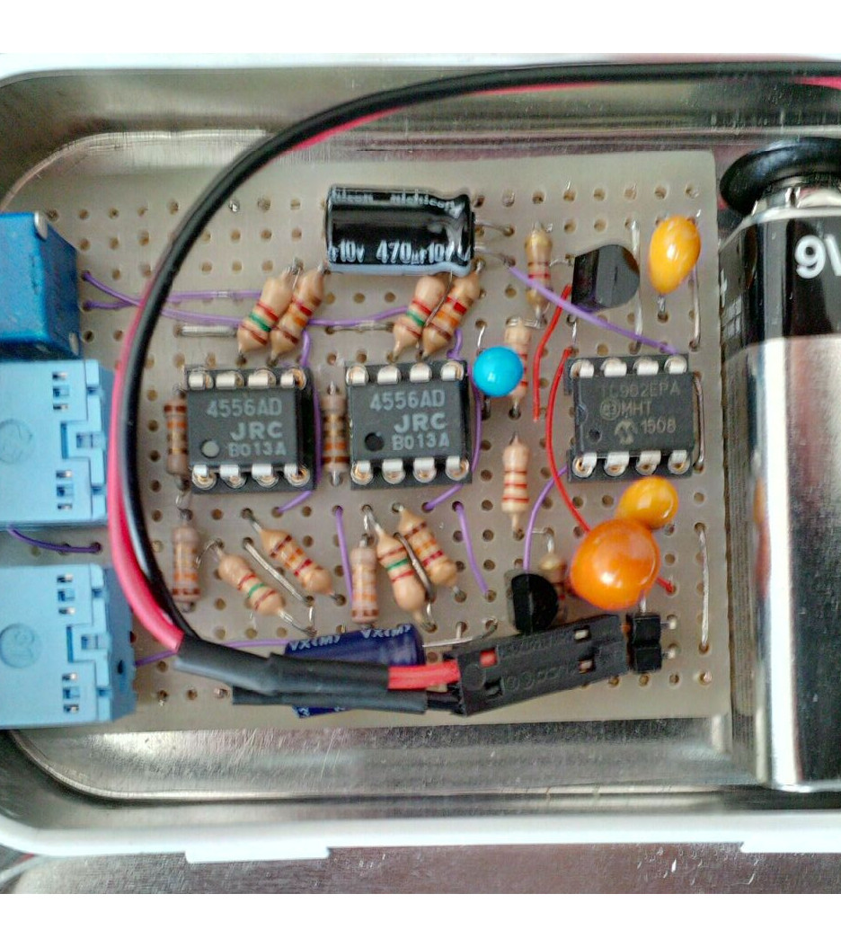

This build is to test the general suitability of 3 components.. TC962, LM317LZ, LM337LZ.. for DIY headphone amps. The boards fits in a single-battery Altoid tin.

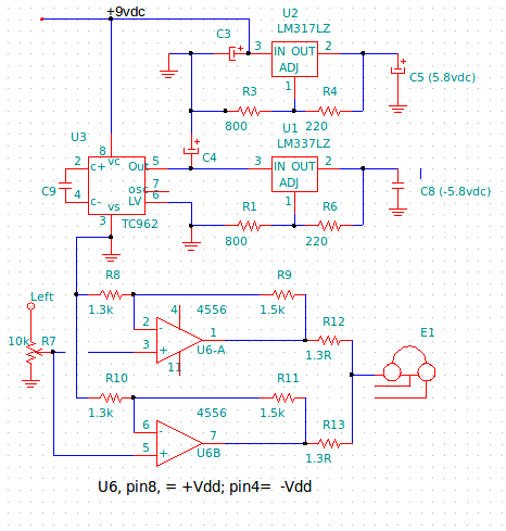

The amplifier has two 4556 ICs in parallel. Each section has a modest gain using 1.5k,1.3k feedback and each is decoupled with 1.3R resistors. The TC962 provides the negative rail so that the uncertaintly of virtual ground is avoided.
The TC962 is said to be 97% efficient so yes the negative rail is close to the battery voltage. However, it rolls off significantly with load so regulators are mandatory for balanced opamp rails. The board draws 44ma when idle. I am assuming the inverter uses twice as much as each 4556 so the opamps need about 20ma. That seems to be a comfortable load for the small LM317LZ which is a TO-92 package for upto 100ma.
One disadvantage is the 2v drop across the regulators which limits the opamp rails to +-6v but that is better that the 4.5v in single battery Cmoy with simulated ground. A design using LDOs would provide about +-8vdc.
My only test equipment is a VOM and ATH50 cans. I was expecting some noise with the rough layout, carbon resistors, and junk box caps but found none. Note that the TC962 can switch at 12Khz or 24khz. I used 24khz.

You could prolong your battery life a little by increasing the values of the LM3x7L voltage setting resistors - at present they're sucking around a quarter of your quiescent current.
Significant regulator resistors
Quite right, I did not consider the drain of the regulator resistors. I did not find LDOs I could easily apply. The ones designed for mobile are more efficient.You could prolong your battery life a little by increasing the values of the LM3x7L voltage setting resistors - at present they're sucking around a quarter of your quiescent current.
You could create your own LDO - not quite as low as the latest offerings from the big boys, but still with a shunt reg (LMV431, preferable to TL431 due to lower current operation) and an emitter follower, you can get easily below 1V.
Thanks for the encouragement but I don't have the board space or motivation to do that. But I would be interested in LDO pairs that are not difficult to solder.You could create your own LDO - not quite as low as the latest offerings from the big boys, but still with a shunt reg (LMV431, preferable to TL431 due to lower current operation) and an emitter follower, you can get easily below 1V.

I just noticed the OP has individual feedback networks for each paralleled opamp. With some bad luck, this could become a lesson in resistor tolerances. The O2 only gets away with 1 ohm balancing resistors because at the end of the day, the gain of a unity-gain follower tends to be very well-defined. One could probably do worse than checking cross-currents (or cross-voltage-drop for that matter) both in idle and at various amplitudes - since the circuit is DC-coupled, DC should actually do and may be more multimeter-friendly.
