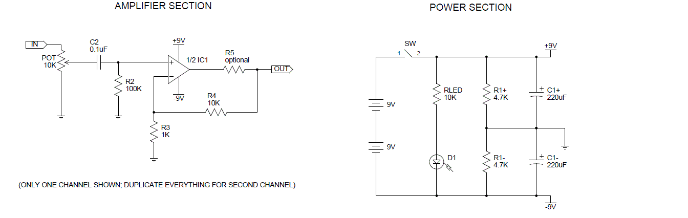

hey guys
am building a cmoy based on opa2132pa op amp, the source would be Sansa Fuze (headphone out and line out)....i read a lot about caps and resistances, and i would like to know what caps i should go for. previously i had decided:
1000mf power caps (nichicon es, bipolar)
1mf wima in the signal paths
i would like to know if these would be fine for my setup.
my headphones are Sennheiser HD212pros, with 32ohms impedance.
also, can i use nichicons as the input caps too?
would be buying from Mouser India.provide links if you can.
Thanks in advance
The power supply caps don't need to be bipolar, you can use almost any polar electrolytic cap. Aim for low ESR. Low voltage types like 16V or so are perfectly fine, but higher voltage ones (50V for example) work just as well.
Wima for signal path is fine, try to find MKS10. You can parallel caps if necessary. For availability also check ebay, but be aware that there are fake parts out there too...
Can you post a schematic? How do you create the pos/neg voltage? Via resistors, or discrete pnp/npn, or rail splitter?
If I had to guess I'd say 1uF for the Wimas and 470uF for the PSU caps. I'd go with film and foil capacitors for the audio signal.
yep yep, here's the schematic
i am using resistor dividers for virtual grounds
With 0.1uF and 100k at the input, the cutoff frequency f=1/(2*pi*R*C) is at 16Hz. With C=0.47uF it goes down to about 3Hz, which is also okay but not necessary.
I'd stick with the values in the schematic. Use a film and foil capacitor for the input, stay away from electrolytics (polar or nonpolar) for coupling caps.
Just like Mooly stated in your other thread, the PSU resistors have to be tightly matched or you will have a significant DC offset at the output. I doubt that there will be an audible difference between 220uF, 470uF and 1000uF caps in the PSU.

You don't need perfectly matched voltage splitter resistors. It shouldn't affect the DC-offset.
Regarding caps, IMO you should use large "PSU" caps to get low crosstalk throughout the audio spectrum. Fancy caps might sound a little bit better but I'd recommend you save your money for future builds.
If this is a portable amp the TLE2426 is an attractive option since you won't be needing two large caps, just one medium size. Be sure to use small decoupling caps in close proximity to the OPA2134's power pins (0,1 uF or so from V+ and V- to ground, or just a small cap from V+ to V-) for stability.
If size doesn't matter you should go for a polypropylen cap not a polyester one as input cap. The cost will be about the same. I'd never use an electrolytic as input cap unless the size of a film cap makes it impossible to use. Even the best and most expensive like Black Gate Hi-Q sounds worse than cheap film caps.
I'm surprised to hear there's DC-offset from the line out of an audio player such as yours. I thought they all had internal caps. If it's so you have to use a cap and you can put it in the amp just as well, but be sure it's in front of the pot. By doing so you don't have to worry about size and use polypropylen, not electrolytic or polyester.
