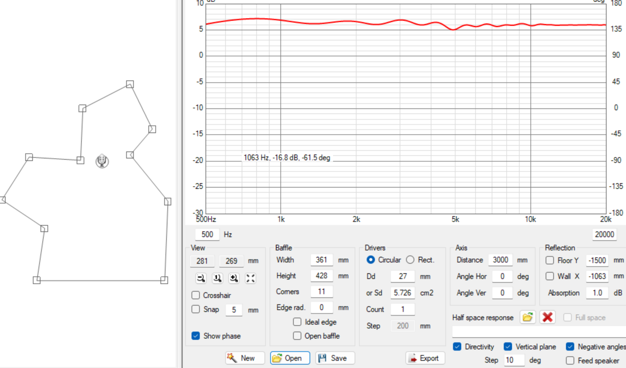

To create an ideal driver sim you need to know the size of the box face in mm and where each driver is positioned. I find using an app like inkscape can help you make the boxes as a vector image (https://inkscape.org/). Graph paper works too.
You will then make a baffle sim for each driver or in your case the tweeter, the pair of mids, and the woofer would be your sim, In the baffle simulator you can export the directivity measurements of each.
Here is a sim I made of a tweeter on a baffle. Note the sim mic is over the tweeter. You need to know the SD of all of your drivers. For your mid you will use the count=2. The export is the bottom in the bottom right. Be sure to save each drivers baffle sim as you place them. You will need the baffle sim later when you take real measurements of the woofer. I suggest reading the vcad manual for real measurements because like the rew guide.

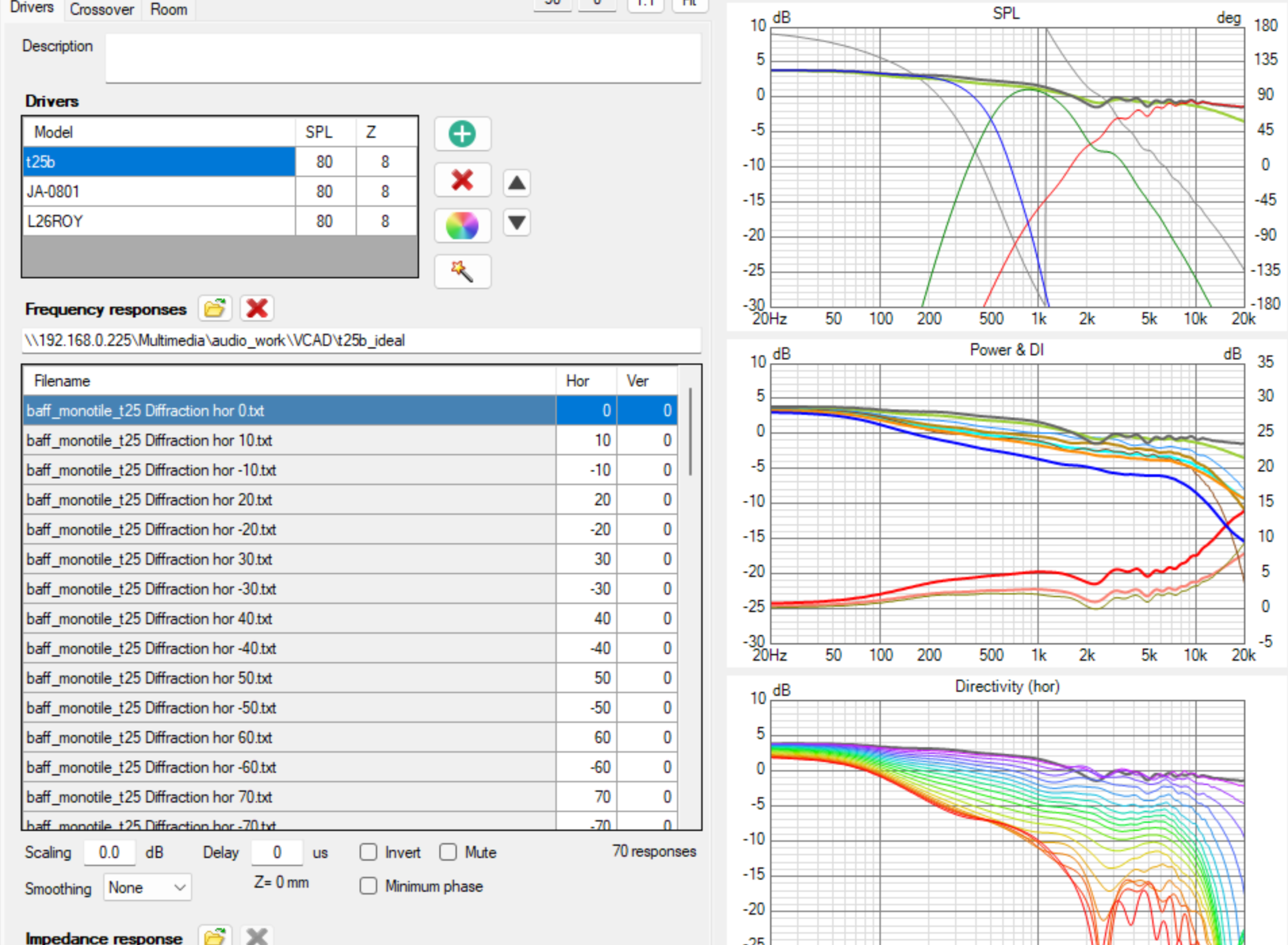

Next you will import the files you just exported out of the baffle sim into the drivers section of vcad:
Now you can add each driver to the XO section and you are off to the races. The mindset to keep is that each driver has its own set of directivity measurements/settings. Also change the vcad preferences to your EQ tool
