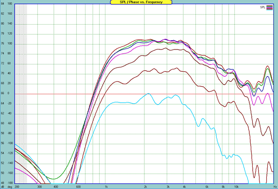

Waveguides have been discussed in-depth on this forum, and they're an excellent solution. In the graphs above, we can see that the on and the off-axis response of a waveguide is consistent. This helps to create a realistic soundstage, and reduce listening fatigue. Unfortunately, waveguides are BIG, and there's no getting around that.

I have a 1.4" ev dh7 on an ev hr90 horn (crossed at 1khz) and was thinking about trying that horn. Using 24db LR, I think 1khz crossover point should work (-6db at crossover point). Looking at the di for that xt horn, its freq response should drop off below 1500hz due to the height of the 12" mouth (but shown is 2khz knee). My hr90 has a 13.7" high mouth, it loses directivity below 1khz, thats where I cross it.

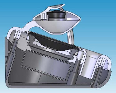

I bought something similar last year - some company had designed this fancy gaming speaker system, but the company was folded for some reason, and they dumped their inventory. I got two working systems, pretty cheap, and they look to be about the same idea. The thing is called the Spherex Xbox 5.1, and was reviewed in the Audio Critic. I attached a diagram of one of the speakers.
The thing is basically an omni radiator, and I see the top 'lenses' as high frequency reflectors. The overall sound is fine - not superb, not bad.
Personally, I don't find omni radiators my preferred radiation pattern - I hear too much ambience, and not enough direct sound. I might add here that I've been using SLs Pluto speakers for a number of years (also omni radiation), and prefer dipole speakers.
